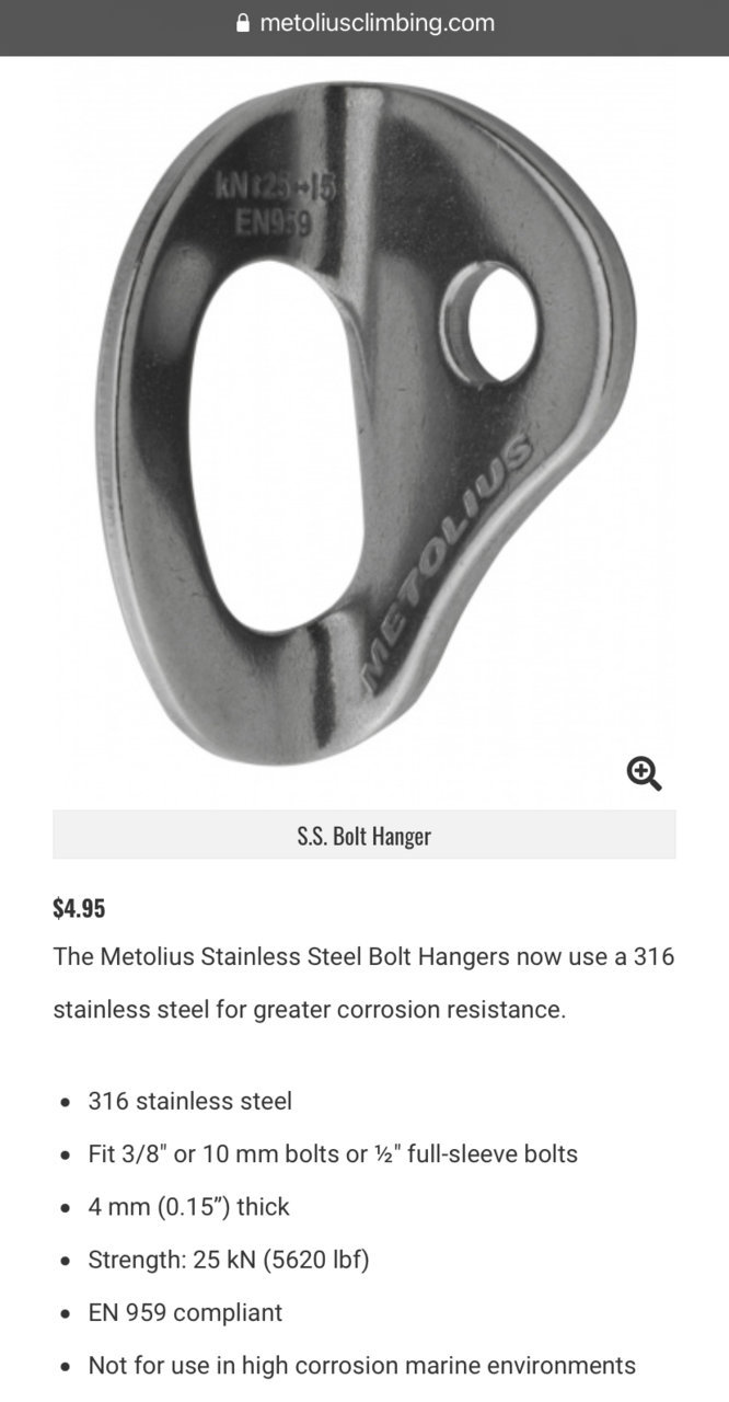

    Will this fit the 1/2" hole requirement for the front bed bolts? It lists two dimensions, not sure how to make of it.
    The chrysler ones look great, as long as they're 1/2" diameter hole. I can't find a dimension on it, and I'm torn to order because they charge $10 for shipping .. for each!

    The metolious hanger will not pass a true 1/2” bolt, but just barely. you could file/drill out the difference, or, try these guys:
    https://fixeclimbing.com/public/ANCHORS.pdf
    Fixe also makes a rated hanger with a rap ring which could make you feel better with strap/hook angle, but would jangle around when empty. Just get a regular hanger, pull on it at roughly the strap angle and tighten the bolt. At >5K lbf, it ain’t bending.

    Don't get those. I use something similar for bungee cording groceries and gas cans to the bedsides. I sure as hell wouldn't trust it for anything beyond 50 pounds static.
