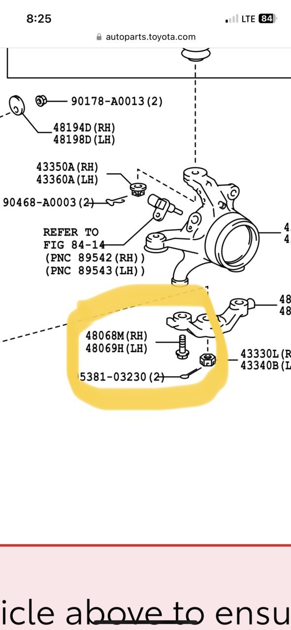

    Is these the bolts you’re talking about? Because these are the ones I need

    For future travelers: Those bolts cab be found in the Suspension Lower Right Hand Arm Sub-Assembly with Bushing (#48068-04040) package, which at this time can be ordered for about $350+.
    However, I was able to learn from my local dealer that these two bolts specifically should be Flange Bolt (#90105-A0010) which as you may notice, is not mentioned anywhere on those diagrams. But if you look up a 90105-A0010 then it gives you the same diagram.
    Currently, these run about $5-$10 each.

    I'm sounding like a broken record here lately but partsouq.com is your friend. The best diagrams on the net. 90105-A0010 is indeed the part number for the LBJ flange bolts, $4.48 each from BAM.
