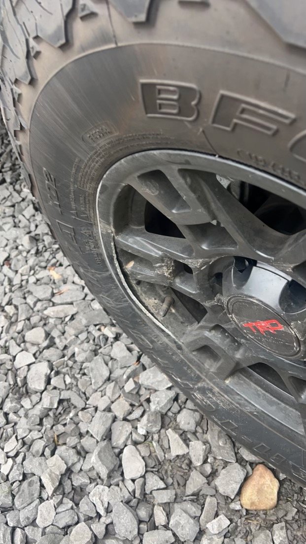

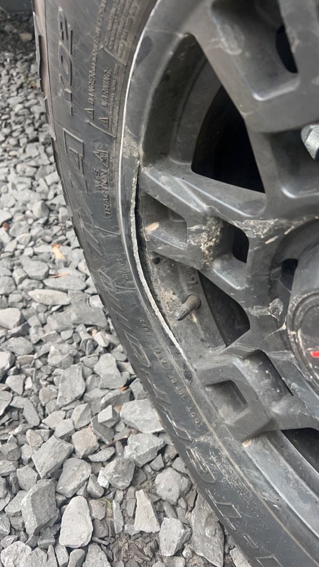

    My son has 17x8.5, 0mm offset TRD pro replica wheels and he hit some black ice and damaged one. Now I can't seem to find that size anywhere. He has an Icon stage 4 set up, with the upper control arms - so according to them they recommend an 8.5 wheel with 4.75 inch back spacing to run 33" tires. He has KO2 285/70R217s on those wheels now with no rubbing after some plastic trimming.
    If I cannot get a matching replacement wheel would a 17x8 with 5mm offset wheels work? they should have about the same backspacing. I assume it would just pull the tires in a bit from where they are but not too much and he could run the same tires?

    Any pictures of the wheel? Sounds like maybe FSW Wheels.

    Here are some pics
    They do look like them but I noticed the FSW Wheels have little dimples around the outside that his don't seem to have. FSW is out of stock everywhere and is saying more will ship in early Feb.

    Pretty sure those aren't FSW. Any chance a tire shop could peel the tire off and check for some identifying casting marks? eBay might have something. A google search for "trd pro replica wheels 17x8.5 sema" shows these. They're both 17x8 +5 offset as you previously mentioned though.
    https://www.oeswheels.com/products/...uTDwZjFrr4OjJD0D1rkE7zqUzhIUbPEaVMf6uu9XaUbbc
    https://www.wheeloutletnj.com/produ...qUneh5vvyVs_8llm3r-QJzhWEIyR6Me1lxdwlS8gGt3aI

    He's in Upstate NY with the Truck and I'm in NV. Will try the shop here where we got the wheels. If they can't get them I may just have to buy a new set in 17x8.
