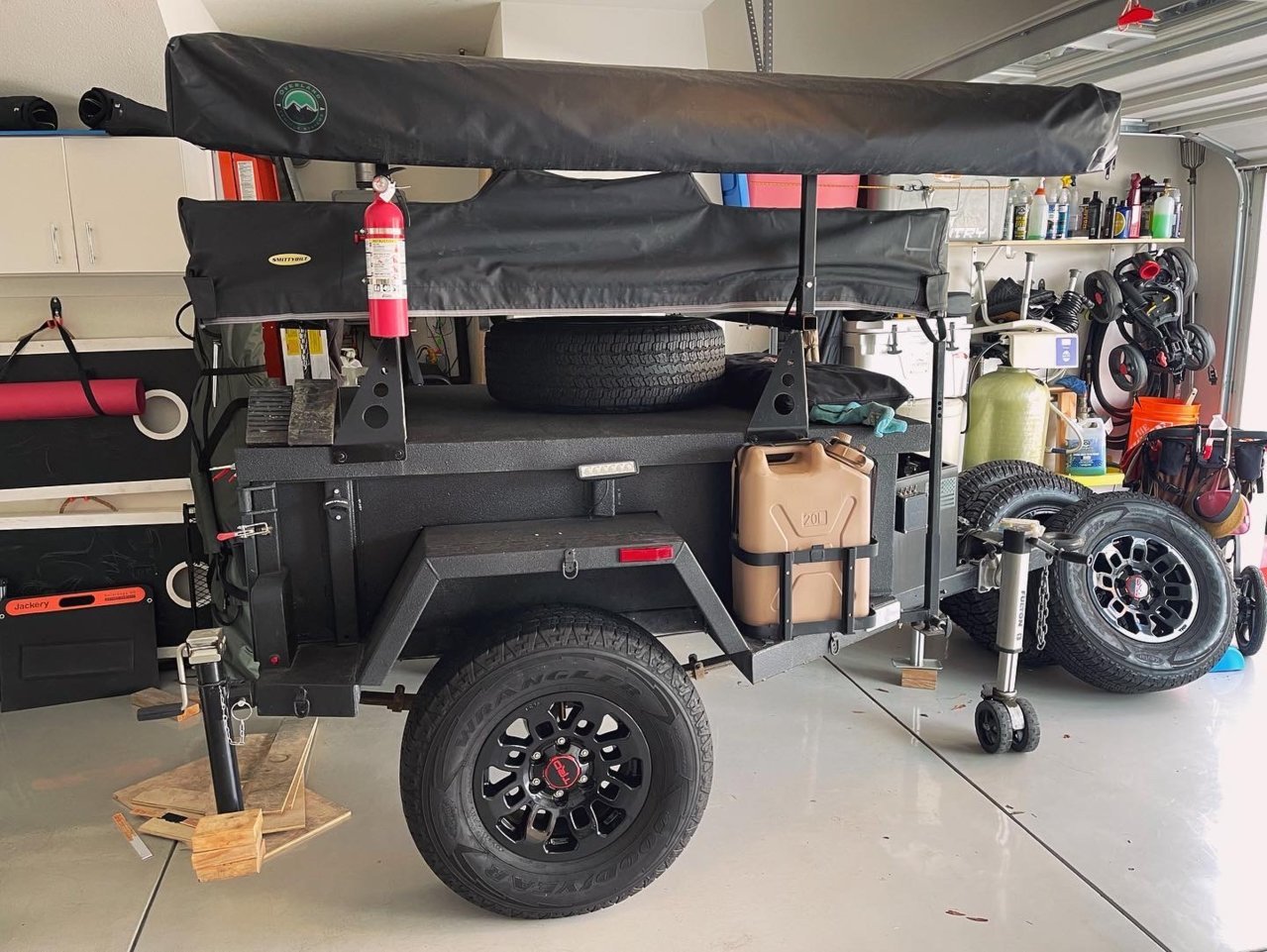

    What kind of trailer is that?

    Its just an old military trailer someone converted. I think its based off an M100 maybe? Similar to what Smittybuilt makes for an offroad trailer, but older and rustier. haha

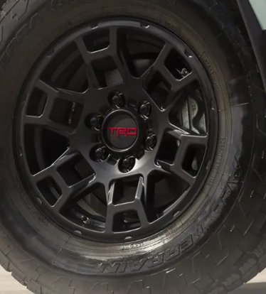

    Will the TRD Sport OEM lug nuts work with these TRD Pro wheels? What is the correct part number for the black lug nuts that go with these wheels?

    Yep, they'll work

    Yes, also go ahead and get locking nuts from your dealer. Reason being is they can register your key code.
