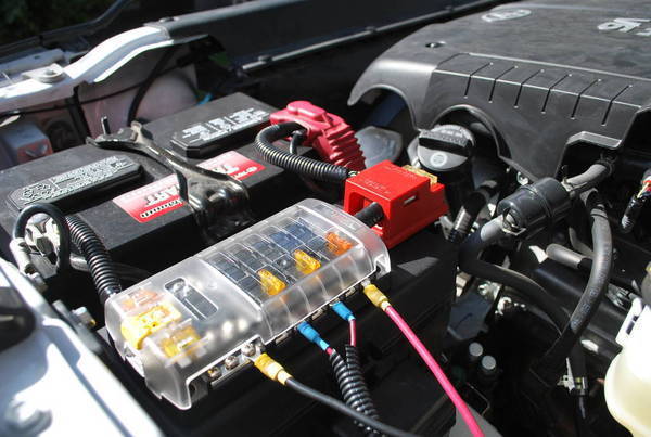

    Those are pretty nice!
    Here's a cheaper (or, I mean "cost effective"), block I chose and is available at autozone or advance auto parts for $10. For safety reasons, always places fuses as close as possible to the battery!
