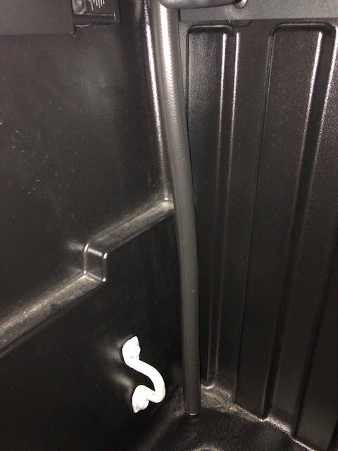

    Not sure how the Gator Trax cover drainage works, but I just installed an Undercover ArmorFlex that had drain tubes that were too wide for the existing bed drainage holes. There was a hose barb sticking down on each side of the tonneau cover near the truck cab that fit a 1/2" inside diameter hose. Because I didn't like the cheap plastic drainage tubes that came with the cover, I bought some black 1/2" ID rubber hose and two Brass Hose Fitting Adapters 1/4" Barb x 1/4" NPT. Those brass adapters fit the hose and existing bed drainage holes perfectly. No drilling needed

    Any pictures? This sounds like the cleanest option, although may increase the risk of clogging

    I'll post some later today after work

    Here are the pics--hope they help
