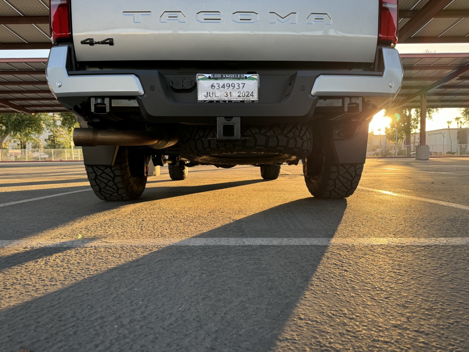

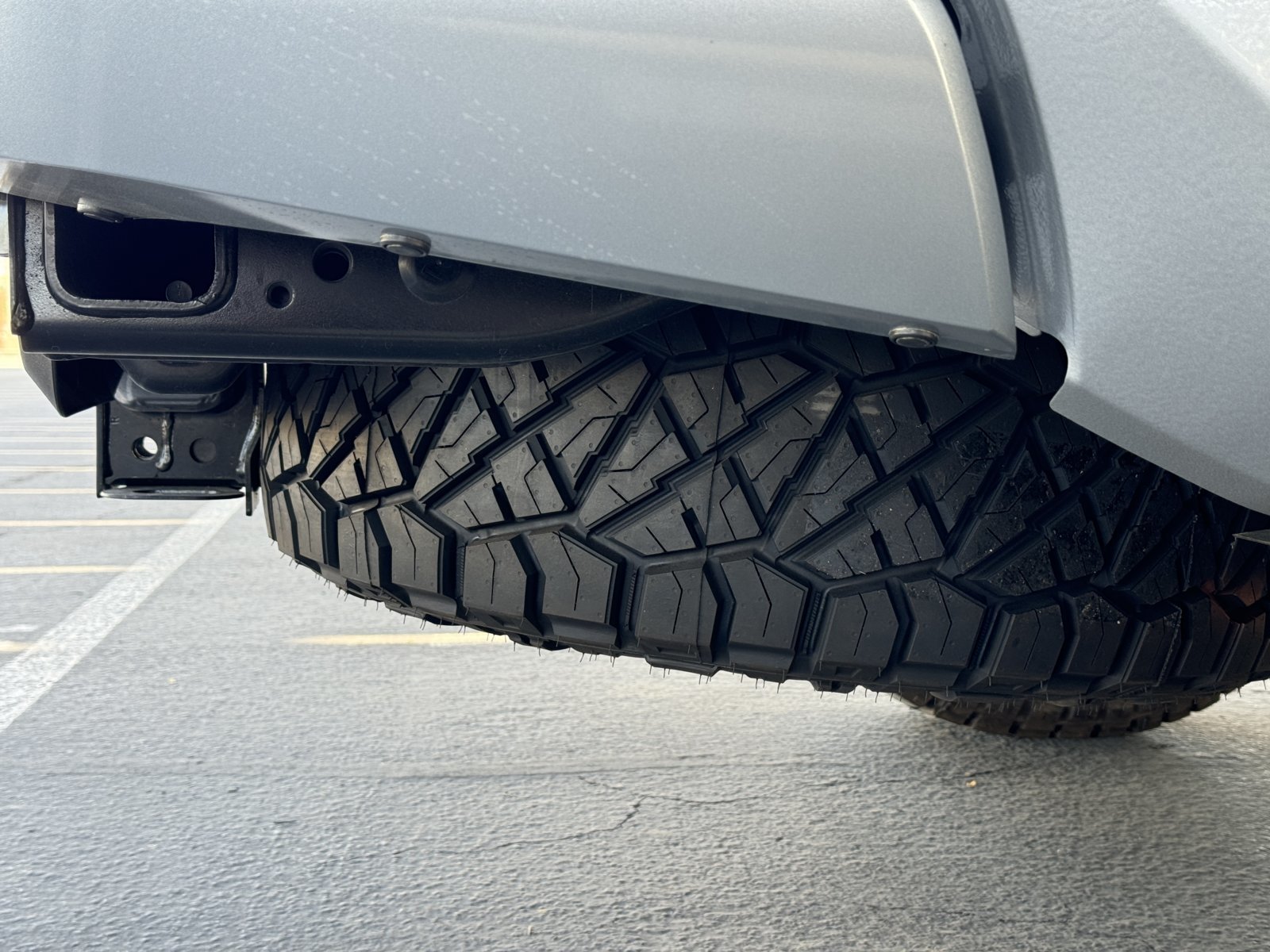

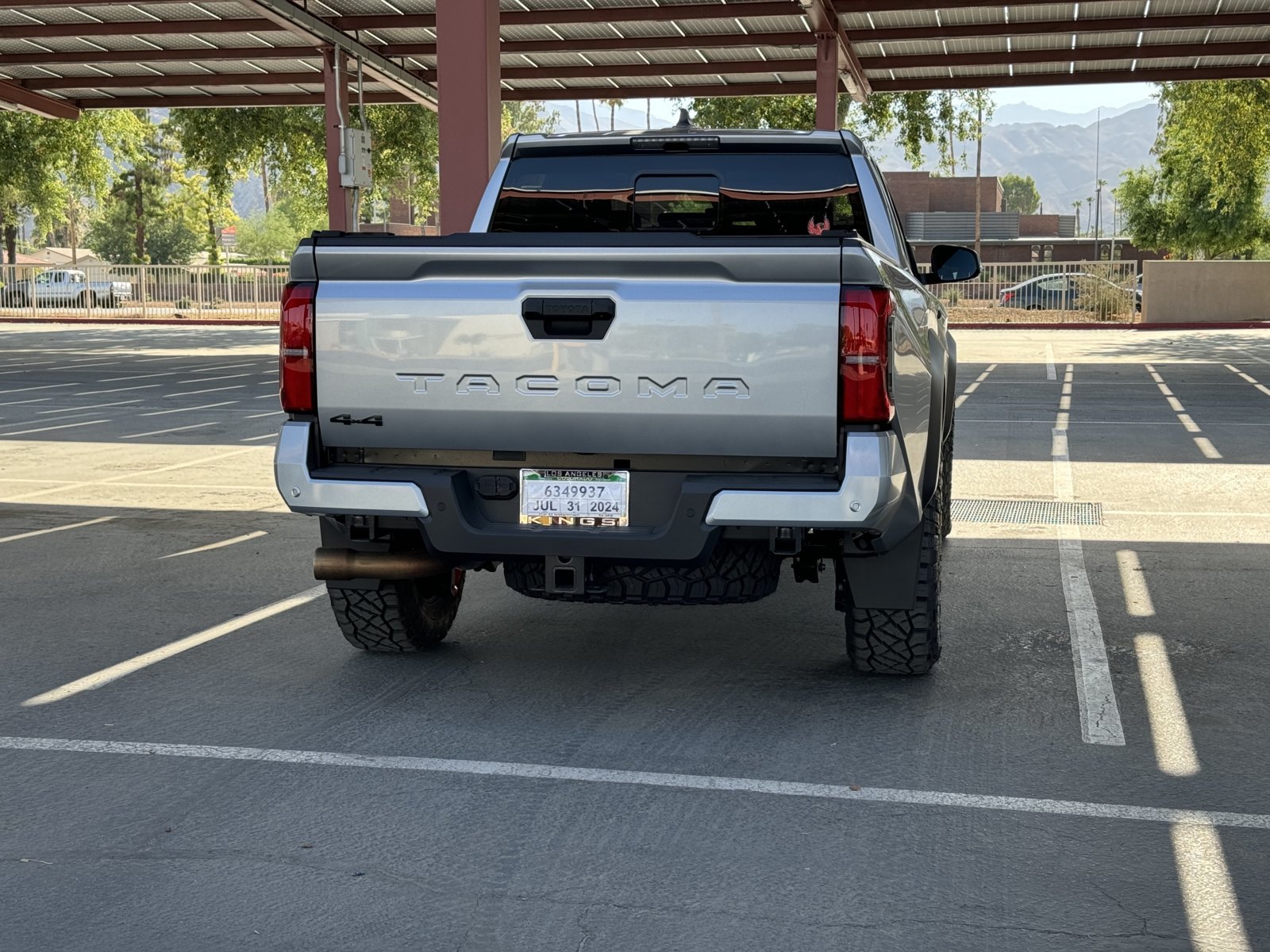

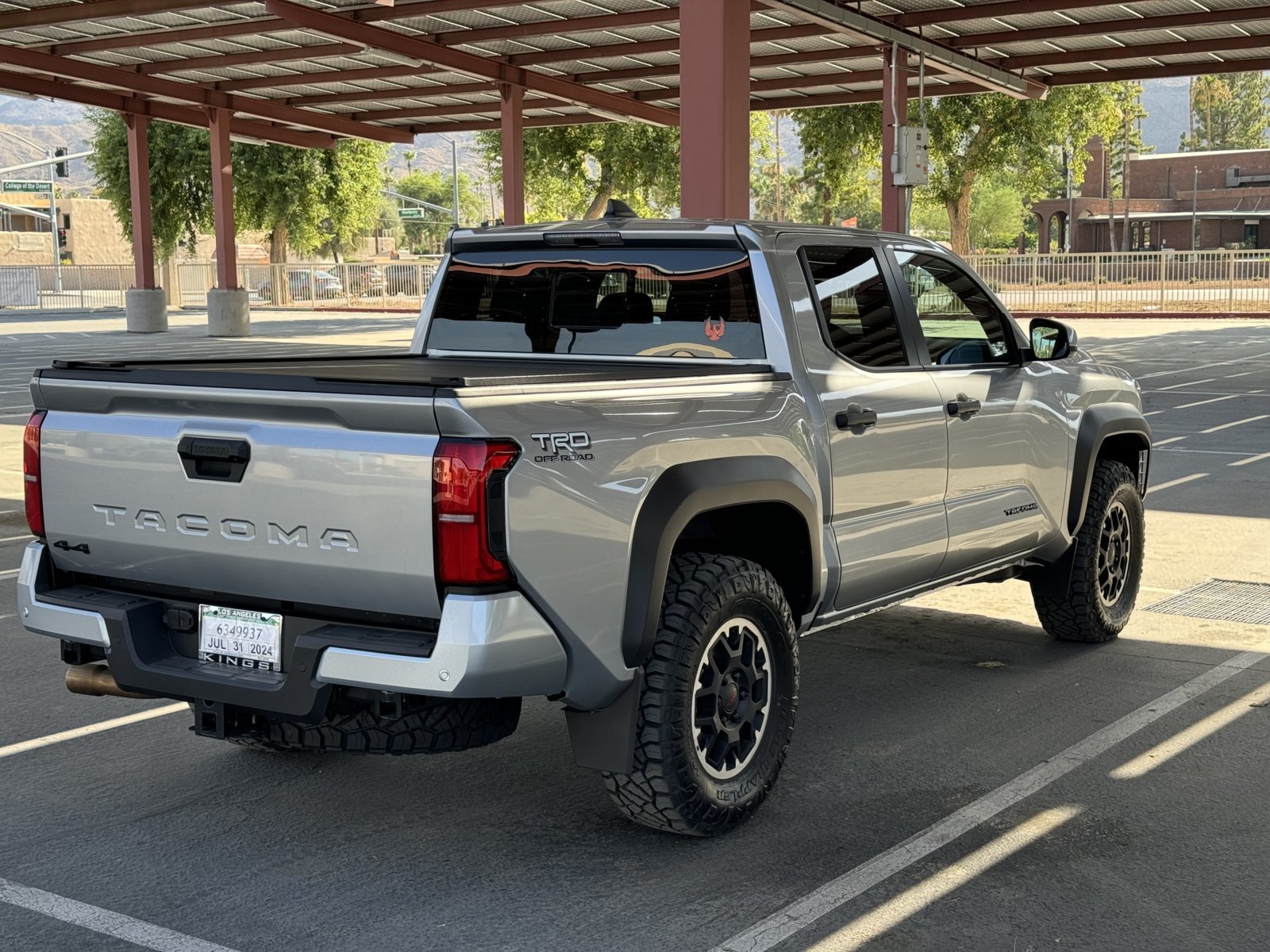

    I installed a full-size 285/70 r17 under the bed. It fits. The tires are wider, but honestly, I think it kind of looks badass with the bigger spare. It may impact my departure angle slightly, but the tire is built to support the weight of the truck, and it might even protect my trailer hitch a bit. Definitely, it will get me home if I ever need it. Stock suspension and wheels, no mods to exhaust. Nitto Ridge Grapplers.IMG_1090.jpg IMG_1092.jpg IMG_1093.jpg

    Unless you are a 5 tire rotation person, using a setup with a matching diameter but narrower tread might fit better

    Damn that looks like it hangs low!

    how many inches of clearance do you think you have under the full size spare? might be a dealbreaker for me, it looks like it hangs really low, almost like 4-5 inches off the ground.

    I measured it at approx 10.5 inches from the pavement at the lowest point. With the new 33 inch tires the diff sits at about 10 inches above the pavement, so the tire sits about 1/2 inch higher than the differential. You can see that the diff hangs lower than the tire in this pic. I don't think ground clearance is going to be impacted. However, departure angle might be.IMG_1096.jpg

    It does look that way from the pictures! I was trying to get a good view of the tire. I posted a better angle to see the ground clearance. It's not as bad as it looks from the first pics.
