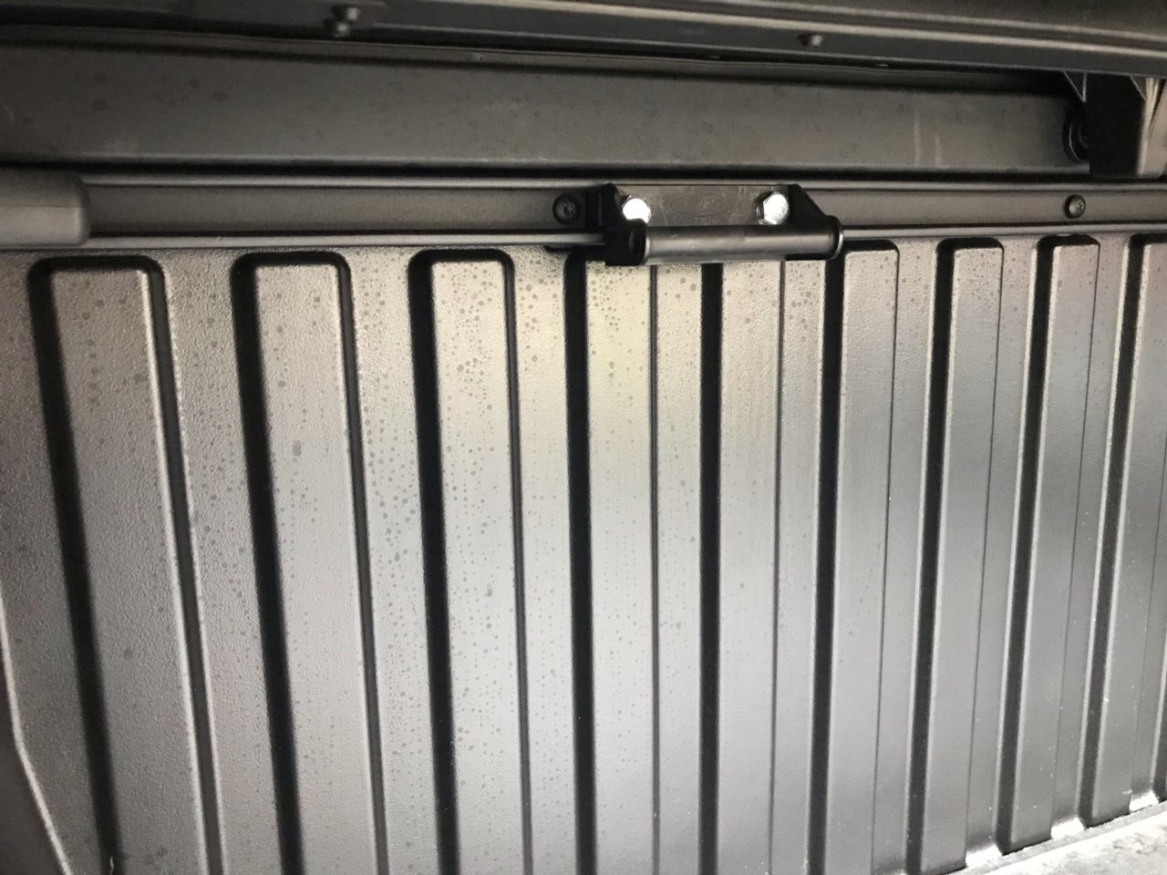

    My 2022 AC came with the metal cleats shown. But I find the deck-rail system tie downs useful as well.

    ^ Thank-you, good to know.
    I noticed that my metal cleats were factory installed much higher than yours.
    I was hoping someone offered a tie down I could put where the bed liner bolts are. Like a big washer with an attachment point.
