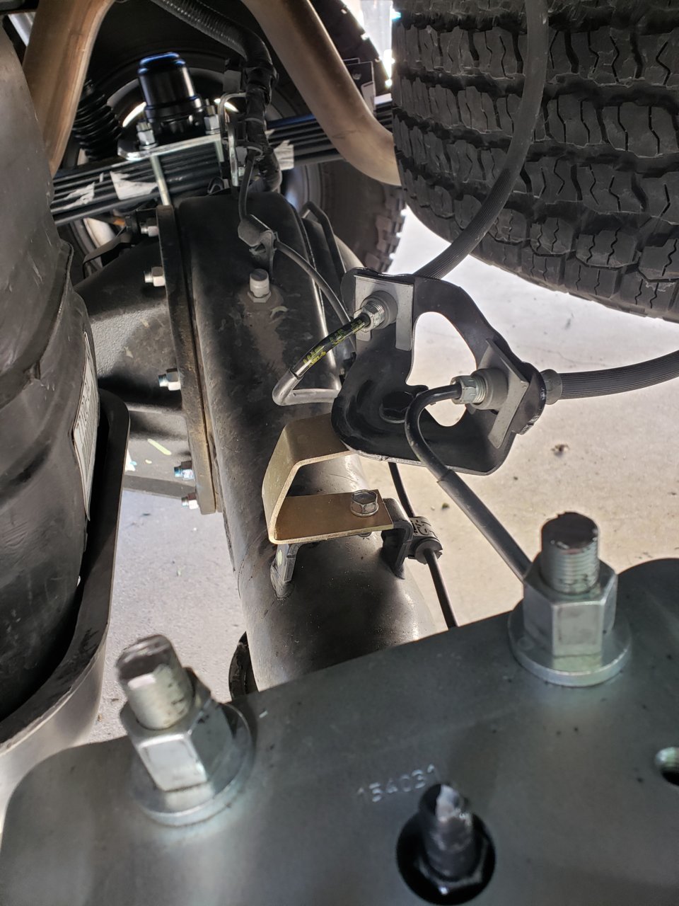

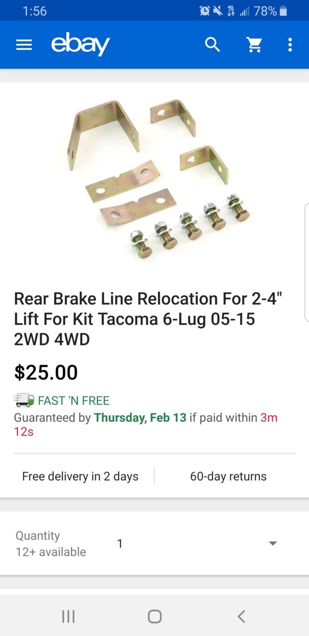

    For the rear I bought a brake extension bracket. In lieu of doing extended brake lines. I have Dakar Medium leafs and extended 5100 shocks (5125).
    It's the gold bracket.
  17. Feb 11, 2020 at 1:52 PM

    Any trick to bleeding the brake lines on a 3rd gen? Or treat it as any other. I’m thinking of abs modules and the like.

    Where did you get that? Is it zinc plated?

    Ebay. It was actually made for 2nd gen tacoma. I didn't like the idea of installing extended brake lines on a brand new truck.
    This kit, I only used the U bracket.
