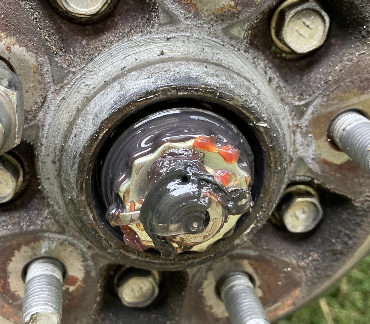

    I have no reason to want to repack the grease, but merely lifted off the dome cap to look - make an inspection. However, I am not sure of what I am looking for - not a very qualified inspector!
    Here are three pictures. One is looking down slightly. One is looking up slightly. One is looking into the removed dome cap.

    IMHO..... at 160+ Kmiles and not knowing the service history or the type of grease......
    To me the grease looks "worn". Its black and looks very wet like the oil is beginning to separate from the soap.
    The grease in the cap is just along for the ride. It does nothing in the cap.
    I would have the front bearings replaced and packed by a QUALIFIED TOYOTA MECHANIC or go to the Toyota dealer. Bearings and grease are not expensive parts. As a DIY job, replacing bearings is not a difficult task.
    A break down on the road $$ spiral up real quick.
    <edit> After a close inspection of the pictures....it appears the grease was "red" when the bearing were last packed. Compare the grease in the cap to the grease on the cotter pin nut. The cap looks shiny but remains a solid. The cotter pin nut, the grease looks wet and loose. Grease should not look wet and loose. <endedit>

    Agreed. Change it and then you will know it's good.

    looks like some of it is dried out and stuck to the cap cover. wouldn't hurt to replace and it's a good learning experience for you @owyh33
