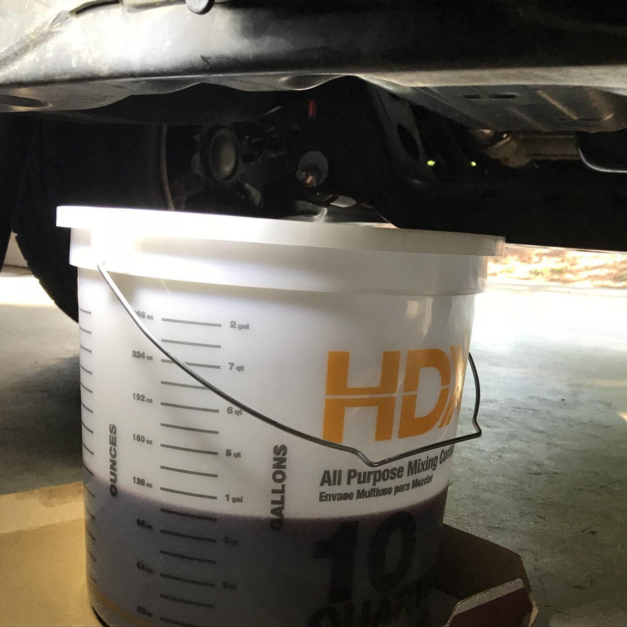

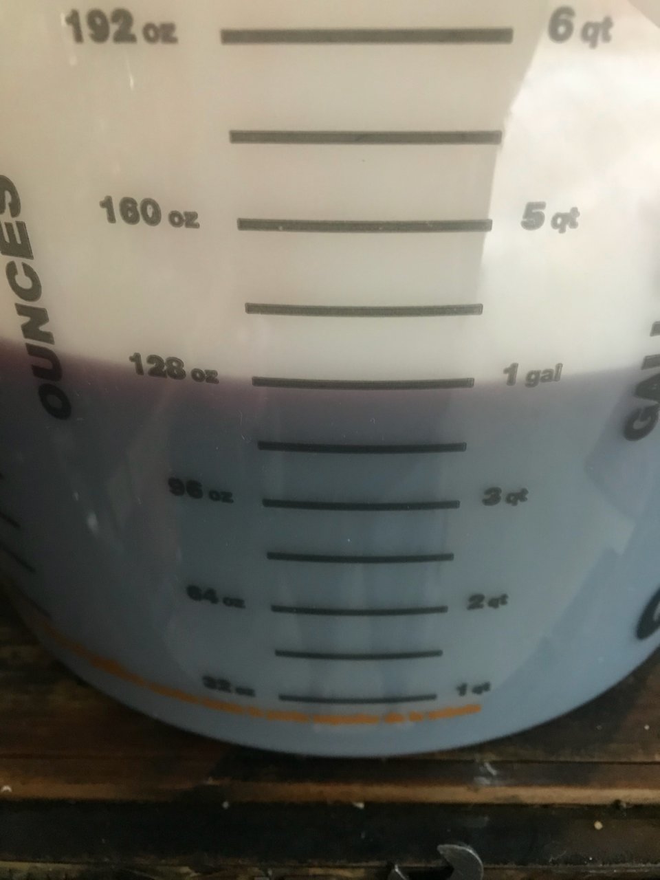

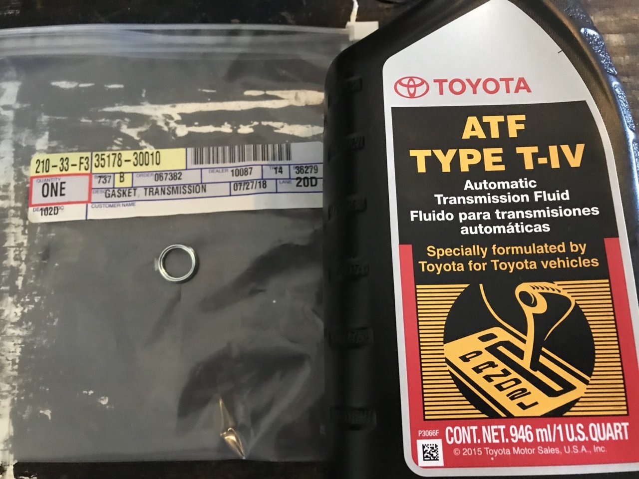

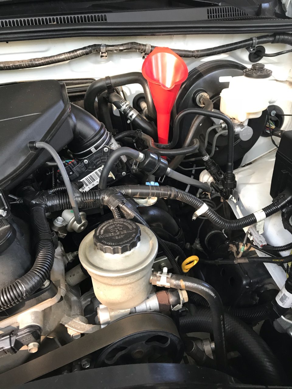

    Changed mine today. 61k miles...drained 4 quarts out and put 4 back in.

    that's exactly the same amount I drained from my 2.7l auto, from then on I just drain and replace with 4 quarts T-IV and new gasket every 30k miles

    I jacked my front end up some to get to exactly 4 quarts out. Put 3.5 back in and went for a short drive, rechecked and added rest. Dead on full while hot and engine running. At 90000 i may drop the pan and change the strainer.
