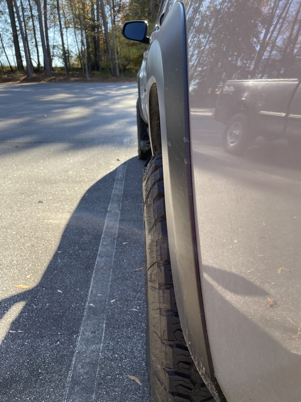

  4. Nov 27, 2021 at 1:00 AM
    jayavilak5
    jayavilak5 Well-Known Member
    May 20, 2018
    #254024
    152
    Jay
    Phoenix, AZ
    2018 TACOMA TRD OFF ROAD 4x4
    Here is a before and after. Top picture is stock OR wheels with Toyo AT2 265/75R16 Bottom picture is Icon Vector 6 with 0 offset and 285/70R17 Toyo AT3

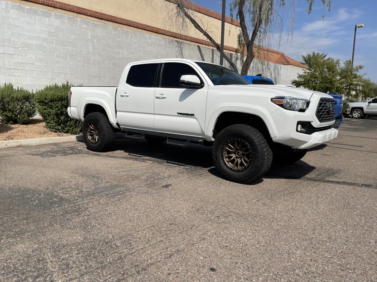

  7. Nov 27, 2021 at 8:16 AM
    retrofive
    retrofive Well-Known Member
    Jul 31, 2021
    #372739
    307
    Visual help? (I like the the look of my 0 offset wheels; I believe stock is +24)

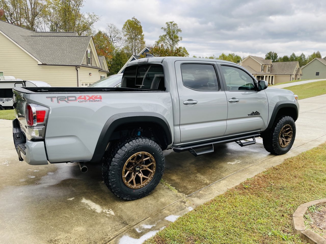

  12. Nov 27, 2021 at 11:00 AM
    thedismaltrade
    thedismaltrade Well-Known Member
    Jun 26, 2021
    #369674
    50
    How about a side shot?

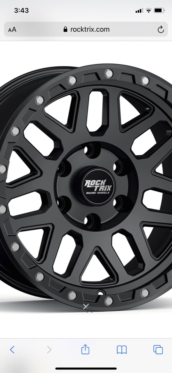

  15. Nov 27, 2021 at 1:59 PM
    Rvh09
    Rvh09 Active Member
    Jul 29, 2021
    #372551
    40
    Rob
    2021 Cement Tacoma TRD OR
    265/70r17 17x9 -12mm offset RockTrix

  16. Dec 17, 2021 at 11:40 AM
    #16
    appalachian_hikes
    appalachian_hikes [OP] Member
    Nov 25, 2021
    #383022
    5
    Colin
    2021 Tacoma Off-Road
    Prinsu Roof Rack, LEER bed shell, cali raised skid plates and rock sliders. Inverter behind rear seat.
    Just wanted to thank everyone on this thread after I read thru it I got black rhino offset at 0 on some bf Goodrich KO2s and couldn’t be happier.
