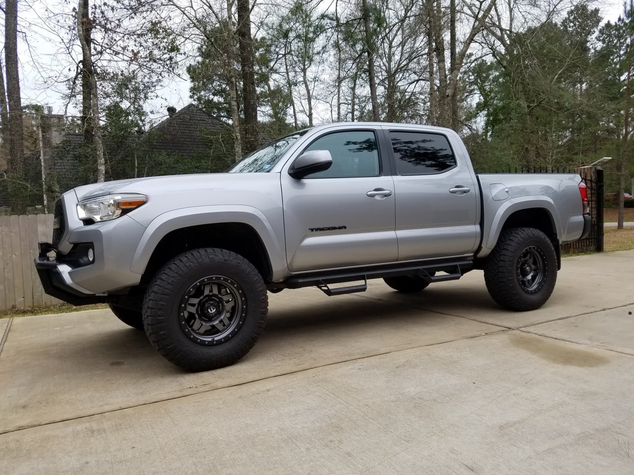

    I have the same wheels and 3in lift and am running the 285/70/17's with no rubbing and no cutting, just took the front air dam off and removed the front mud flaps.tacoma3.jpg

    Nice looking ride. That gives me some confidence to press ahead with 33s. No mud flaps on mine.
    Do you have UCAs with that much lift?
    Have you been heavy on the trail with them?

    No UCA's. No heavy off roading as of yet, just fire roads and moderate trails.
