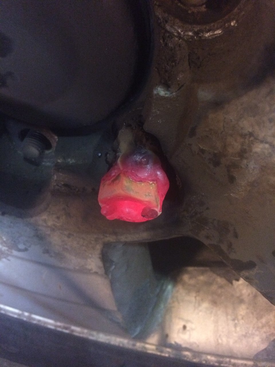

    Thanks for the replies everybody, I ran to autozone after I posted that and grabbed a couple extra wheel studs. I had it fixed in about an hour. I ended up pulling the hub/bearing assembly off and knocking the new one in there with a hammer and punch. I used the dorman stud, it perfect fit. image.jpg

    You didn't have to knock the new one in. Just get it started a bit with the splines aligned, put an open nut on it and pull it in place with the nut.

    I tried, couldn't get it to draw in all the way. The splines might be a little bigger on the dorman than the oem. The OEM lug was super easy to knock out, but the dorman took a pretty good lick to seat in. I decided to take the hub/bearing off anyways to see what kind of shape the bearings were in.

    Get a standard lug nut that the lug bolt can go all the way through. Use the flat side of the lug nut against the hub and crank down with a socket wrench, impact wrench of lug wrench. This should draw the new lug bolt in flush to the back of the hub. Use a little lube to make it easier as well.
