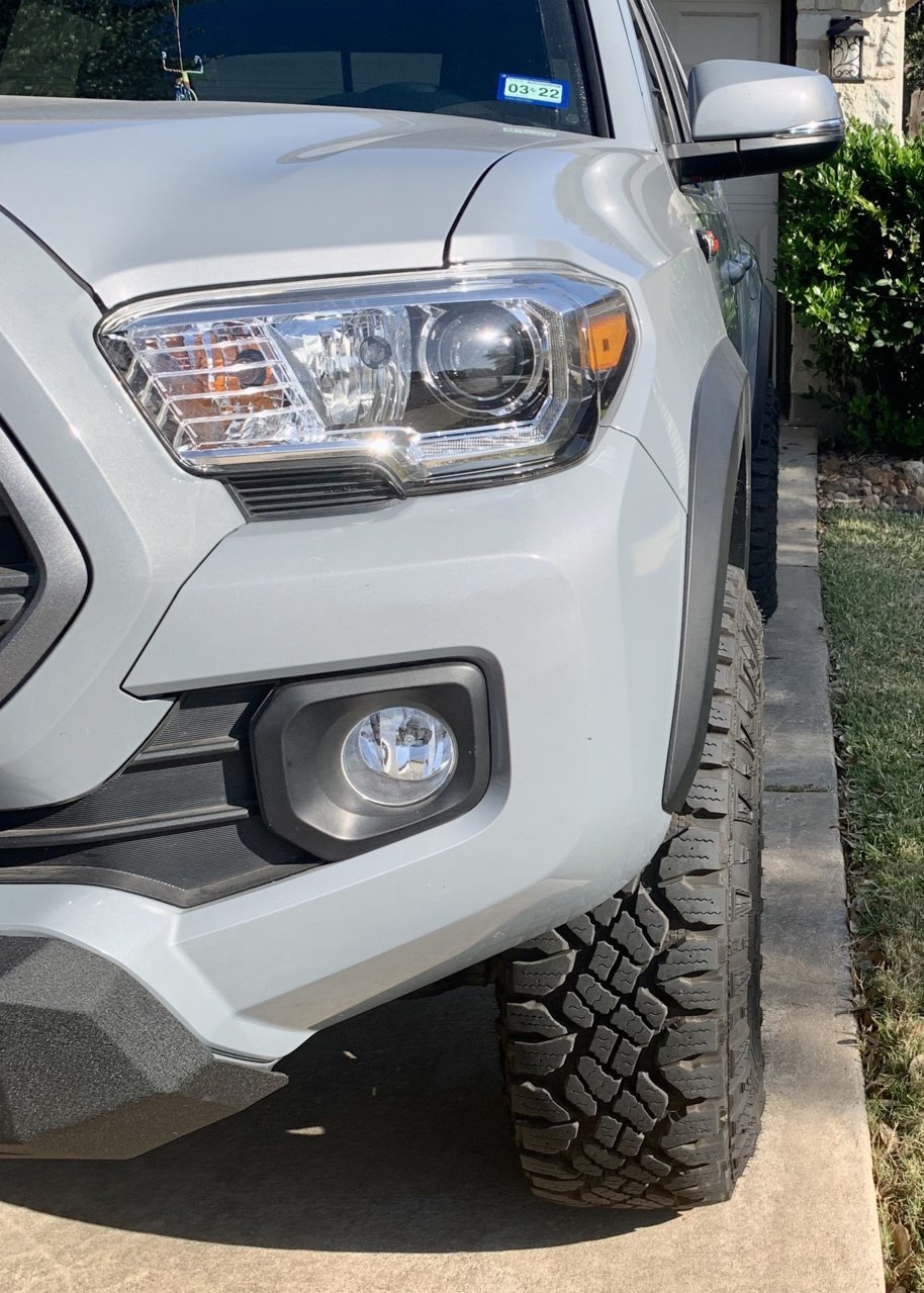

    Spidertrax 1.5" on OEM wheels and 265/75R16s, no issues.
    0335C813-803C-4E3A-B8A2-2227066F9111.jpg 45307720-E606-400C-BB90-3581B8C027AB_1_201_a.jpg D40A0098-60A2-403C-9F32-A6A356092726_1_201_a.jpg

    I've got 1.25" Spidertrax on my stock TRD Pro with the Toyota Beadlock style wheels. The wheels are +10 so with the spacers that puts me at about -21 offset. Driving around town with no problems. When turning and going around corners with bumps or driveways it rubs like a MF'er. Daily driving though on pavement no problems at all. Might swap them out for some .75 Boras but the poke from the 1.25" spacers looks great.
    Edit: the .75" spacers from Bora would put me at about -10 offset with my wheels and I suspect I would have no rubbing problems at all.

    With the 1.25" spacers on a 0 offset wheel you would definitely rub. With my OEM wheels (+25 offset), they take the offset to approx -6, and with 265/75R16's it's a fairly close fit, but even fully articulated with the wheels turned, I haven't had an issue. I believe going to > -30 offset would be a problem.
    2B5D5E4A-4F1C-4FCD-A47D-0BA230F6FD64.jpg 058BA816-698D-4DAA-AAAA-2262433004A1.jpg 5891123A-7243-43C4-97F3-7A0DAA159E67.jpg
