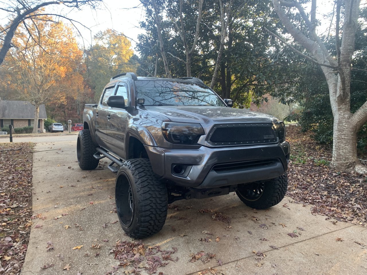

    2017 SR5 Premium 4Runner
    Yeah what he said^ a lot of people on this forum hate the wider tire / outside of wheel well look. I'm running 22x14's with -90 offset w/ 35's, no spacers, and I personally like the look.
