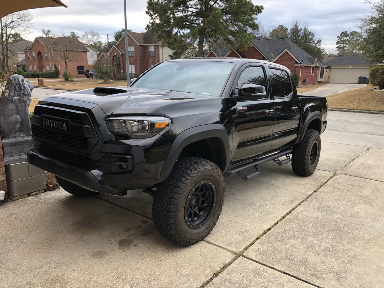

    Yes just looks for me. Ill remove them before any offroading trips. Just a bit more aggressive . My last 2017 quicksand trd offroad i had stock wheels and spacers. 20k miles without removing them and went offroading and not a single issue
