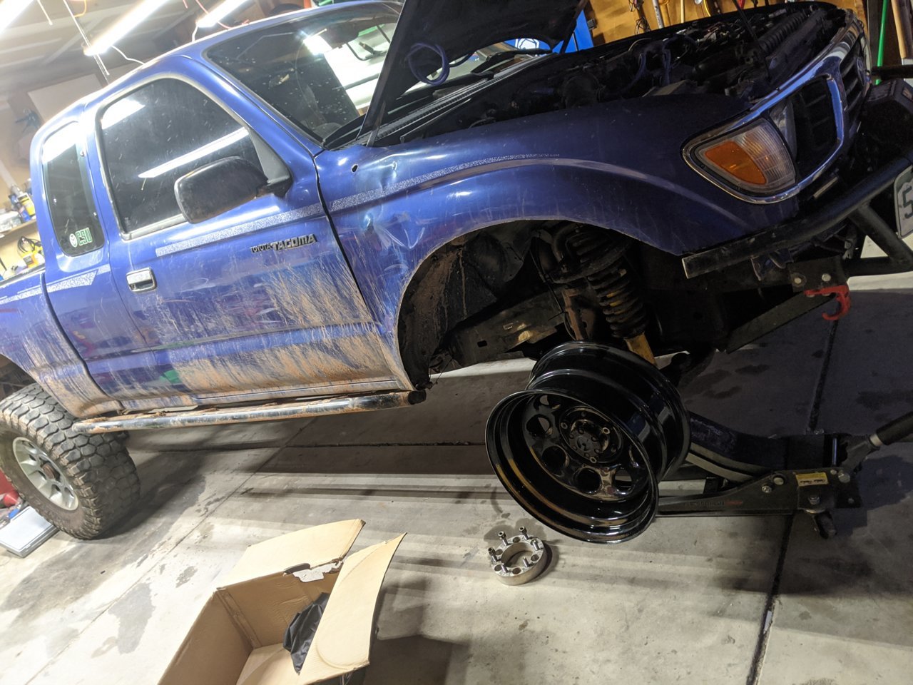

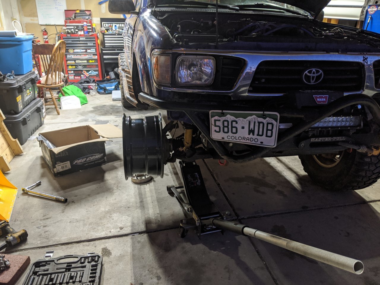

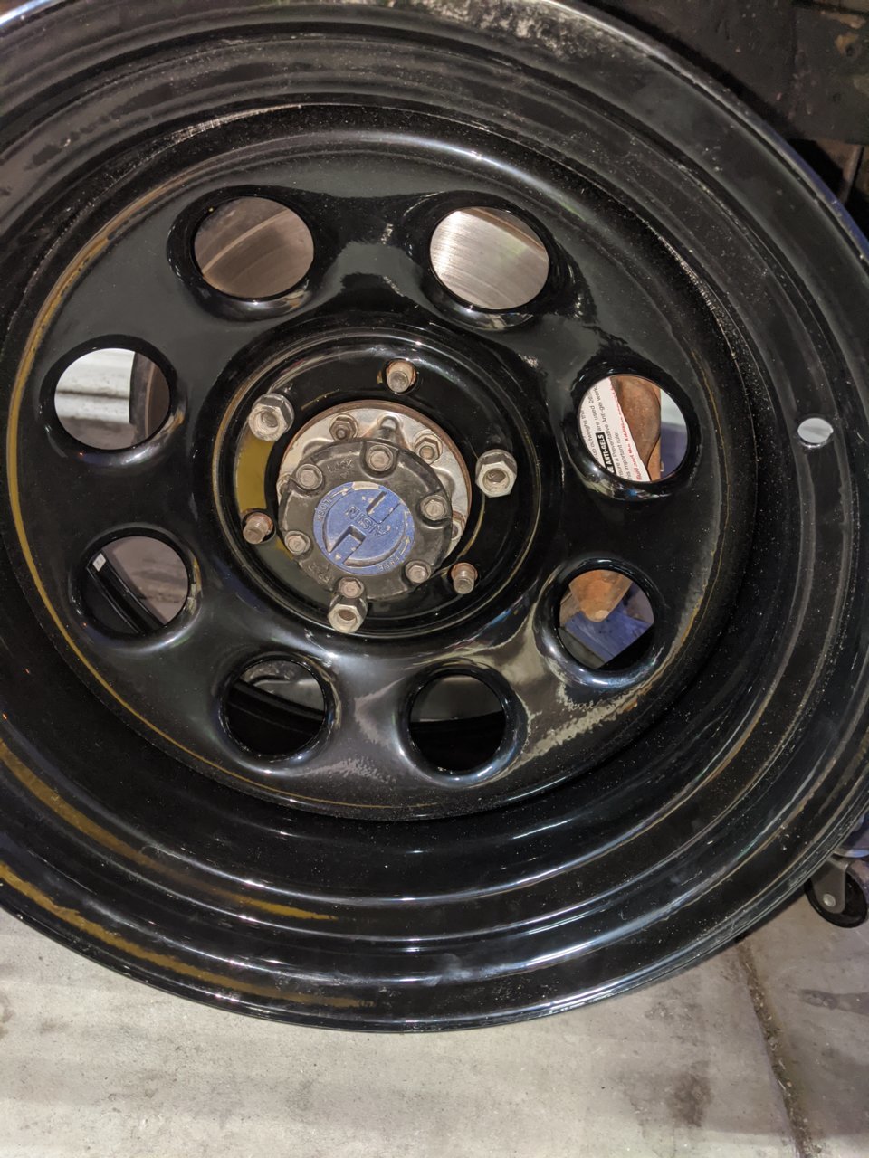

    I ran 33s (295/70/17) on 5th gen 4 runner 17x7.5s with 1.5" spacers (about 3.3" BS). They still touched the frame at lock while flexing.
    This is a 17x9 Procomp with 3.5" BS. I'd expect the same.

    Never broke a bead airing down to 8 psi on these 4runner wheels.
    Here's 295/70/17 on the 4runner wheels with 1.5" spacers.

    Those Procomp 17x9s with 3.5BS are like $90 ea shipped on 4Wheelparts FWIW
