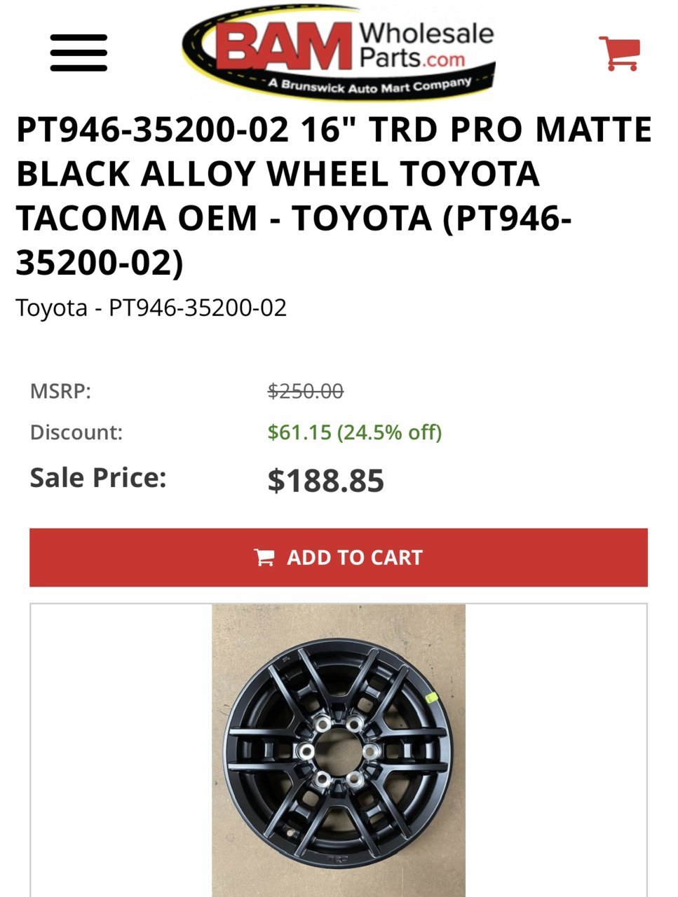

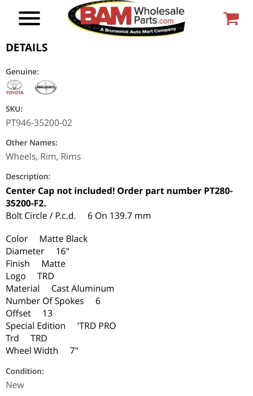

    I am trying to get a set of new BF Goodrich A/T KO2s 265/75R16 and TRD Wheels from BAM (see attached for wheel specs).
    PT946-35200-02 16" TRD PRO MATTE BLACK ALLOY WHEEL TOYOTA TACOMA OEM
    I dont have the slightest clue if these combination of wheels and tires would work together and if they will have no rubbing issues. My 2020 Tacoma TRD Sport has stock suspensions and no lift. I removed my mud flaps because I recently installed Redrock black Fenders which I absolutely love.
    Will a BF Goodrich KO2 come in
    265/75R16 and will it fit the TRD wheels that I am planning to buy from BAM? The Toyota dealership at my location has not been very helpful with responding to my questions and I imagine they will charge me a lot. Hence, here I am in Tacomaworld trying to get some feedback from other much more experienced truck owners. Thank you!

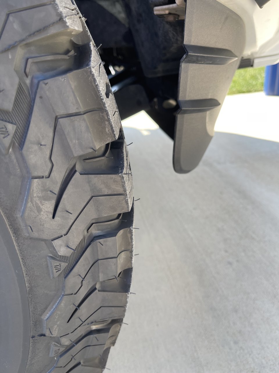

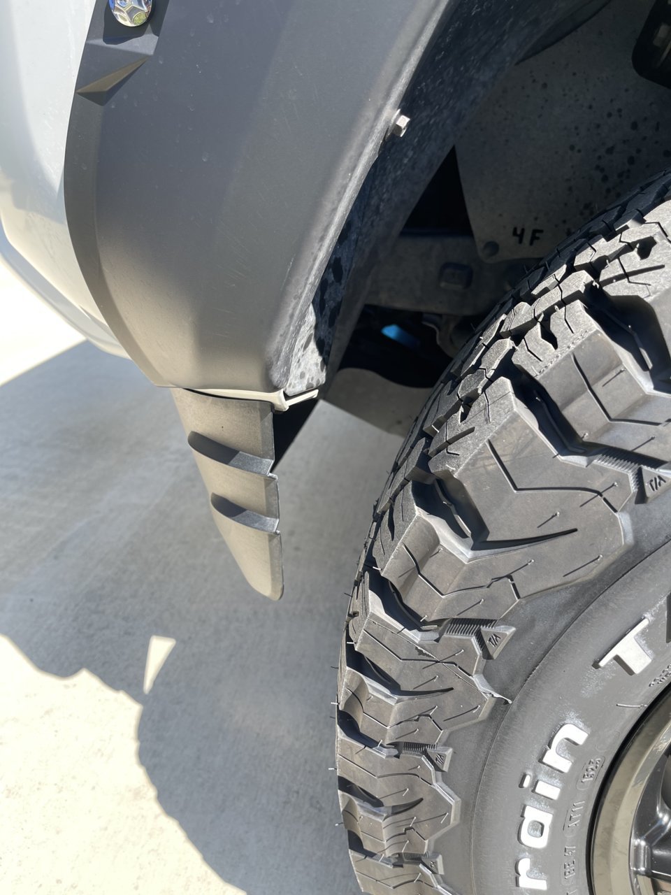

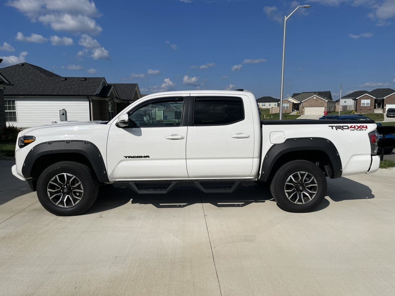

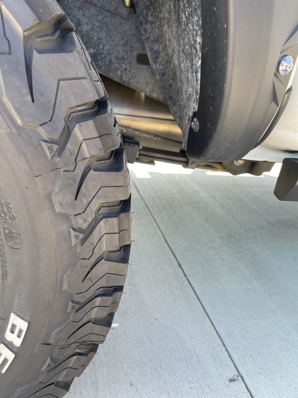

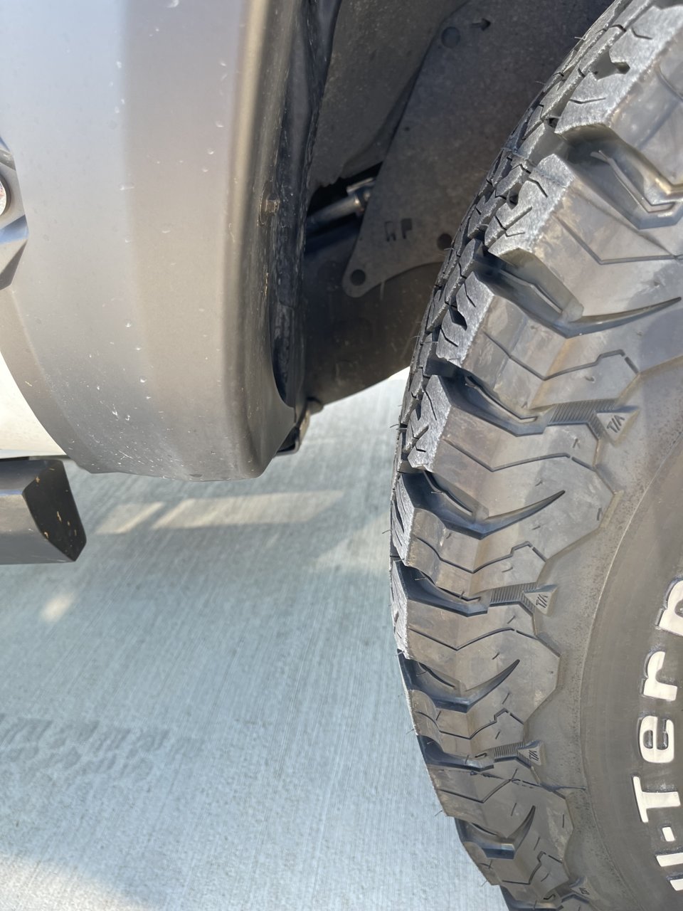

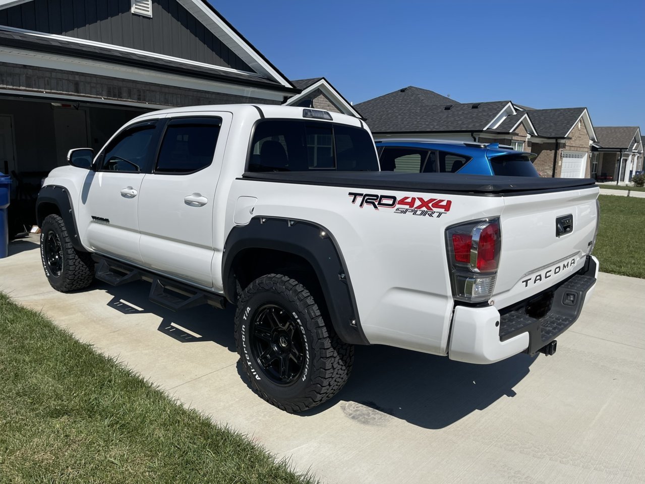

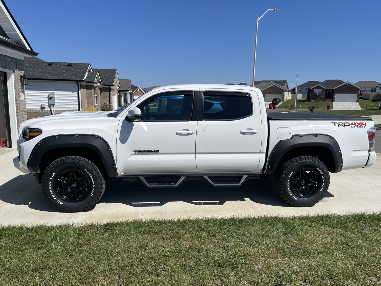

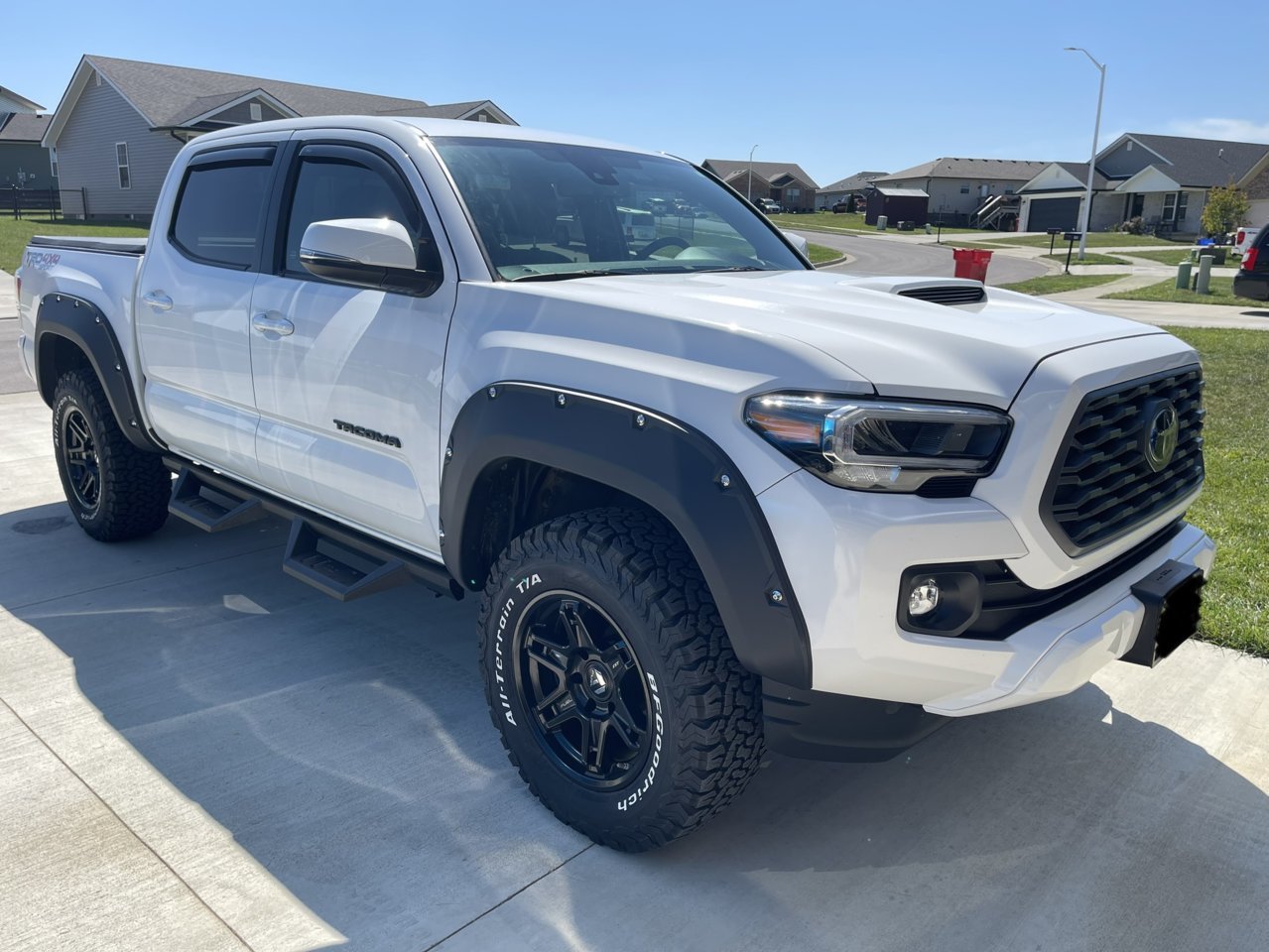

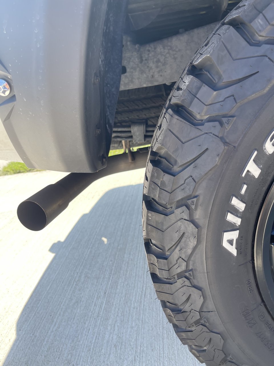

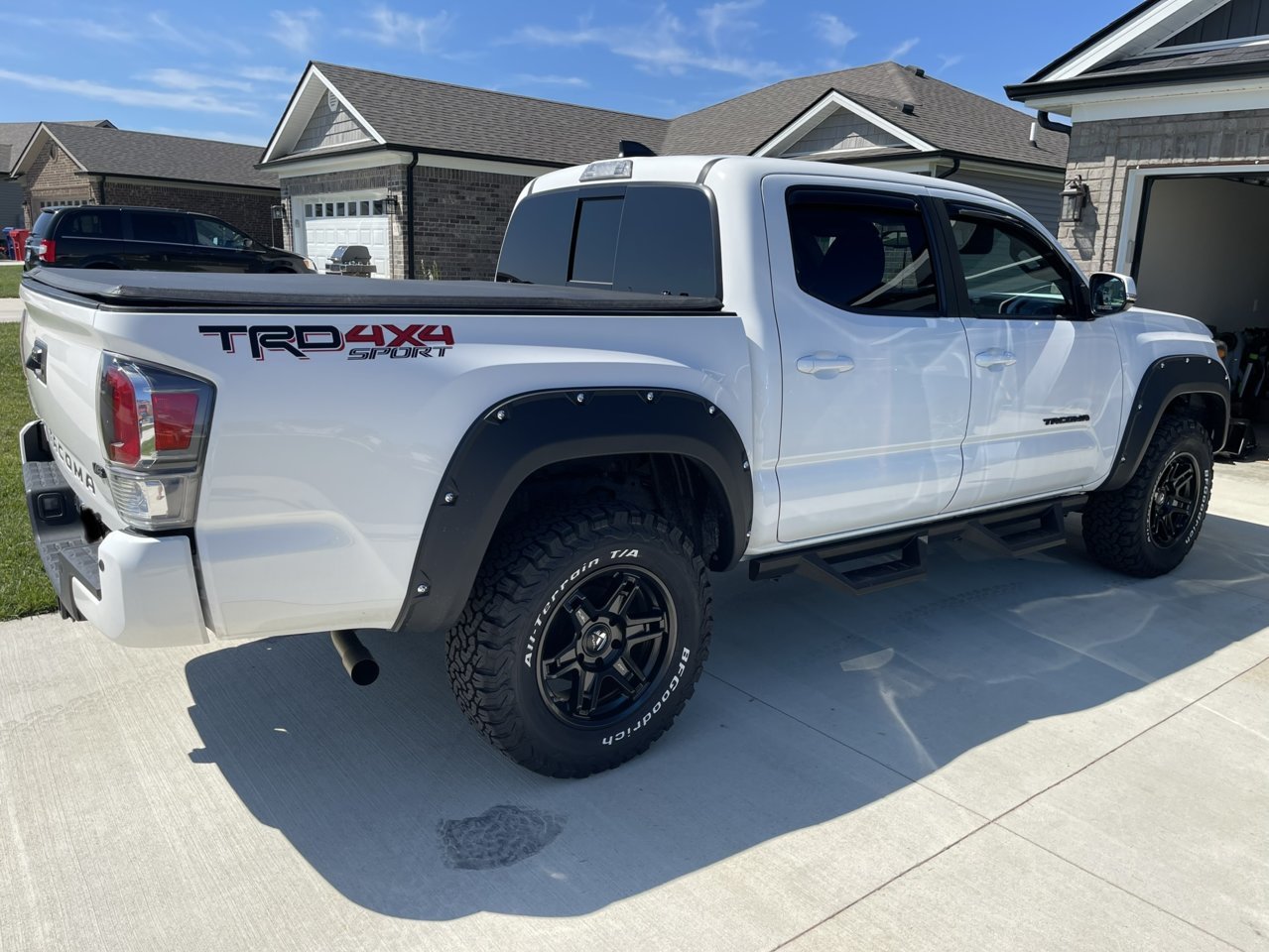

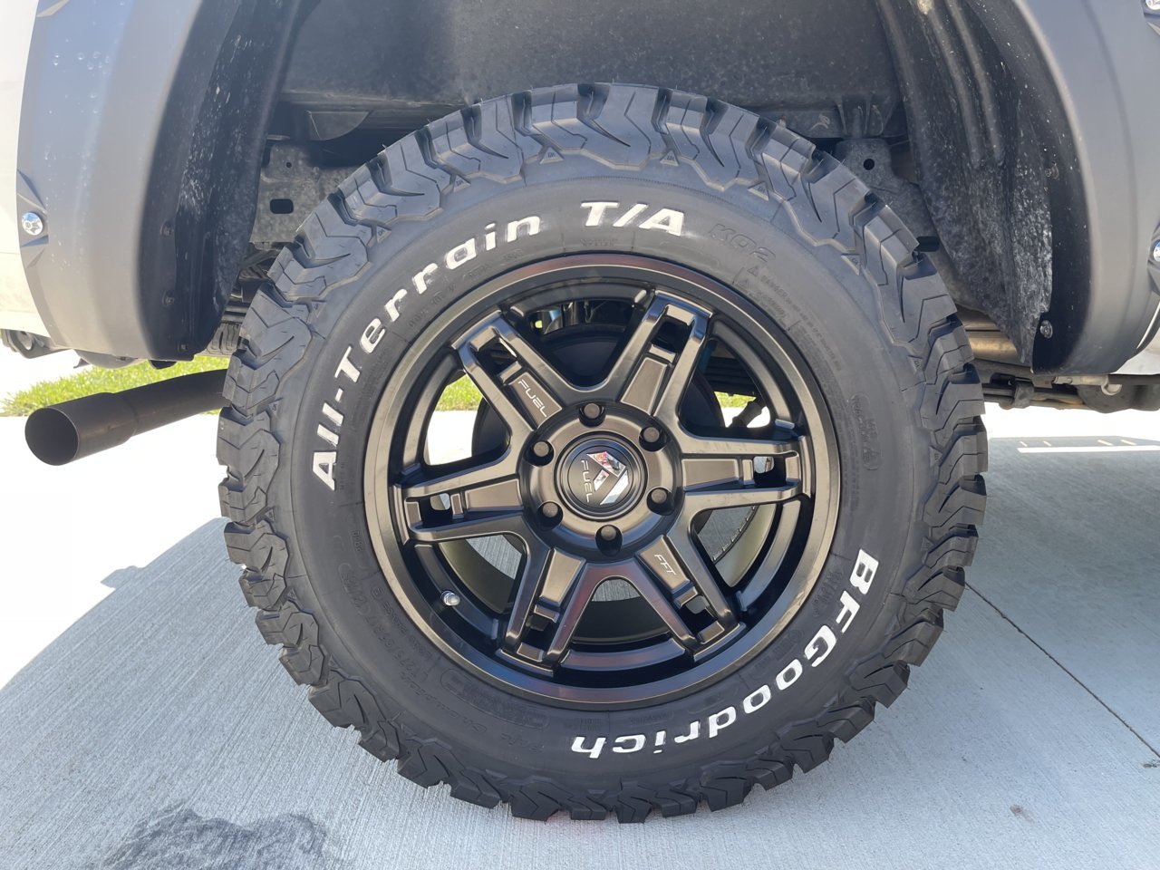

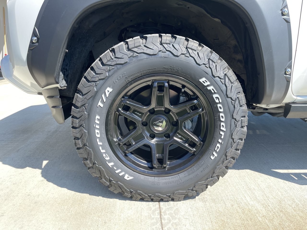

    Just had the LT275/65/R17 KO2s (E rating) and Black 17” Fuel Slayers installed on my truck yesterday at Firestone which is an affiliated installer with Tirerack.com. It completely changed the look of the truck. Its looks way more mean and beefier. Love the +1 mm offset of the Slayer wheels (OEM Tacoma wheels was a +30 offset) it’s hanging out just by maybe 0.5 inches from the body of the truck; hard to see it bec I have a wide black fender that covers the tires. Very happy with the outcome! Only gripe I had was Firestone was able to reuse 3 of my OEM TPMS but the 4th one broke so they had to charge me $8 for the valve stem kit; total $32. So now I’m left with 3 metal valve stems and 1 that is a rubber valve stem..the technician said they ran out of the metal valve stems so they used a rubber one for it (see pic with the black valve stem and cap which is the rubber one). Basically I was told I would have to buy a new TPMS for the one that broke from Toyota. What are your guys’ opinion of the TPMS situation I have? I’d love some feedback. I wanted to just go ahead and get a new TPMS kit from Toyota so everything is the same gray color; the black rubber valve is exacerbating my OCD lol.
    Also I was told to use 36 psi on the tires since I mainly use it for commute and weekend mountain biking offroad. Does that sound about right?

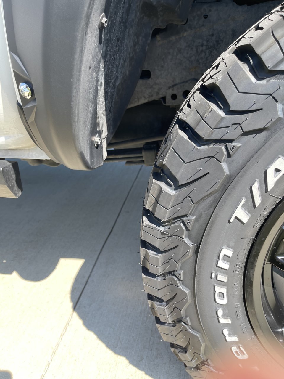

    Also there is absolutely no rubbing. Plenty of space as you can see on the picture. If it’s turned all the way the clearance is about 1 full inch.
