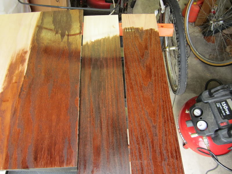

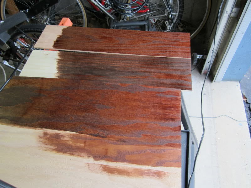

    picked up a few pieces of sample wood today. Got a red oak, plain oak, and poplar. Picked up a red oak Minwax stain. The red oak looks awesome and love the grain on it. The poplar is pretty dark but is looking better as it continues to dry.
    here they are: from left to right, Plain Oak, Poplar, Red Oak
    I think the closer grains will look good on the trim pieces but I am not sure if there will be too much going on with the larger surface areas like the sides? I am not too sure how good it will look either if I use red oak for the trim and plain oak for the larger areas.
    I am also going to pick up the Kreg Jig Master System. There were a few contractors in the store I went to today that came up when I was checking one out and said they highly recommend it over using a biscuit joiner (which is what I was going to use). They all said they have one and the biscuit joiner sits in the corner of their shop unused.
