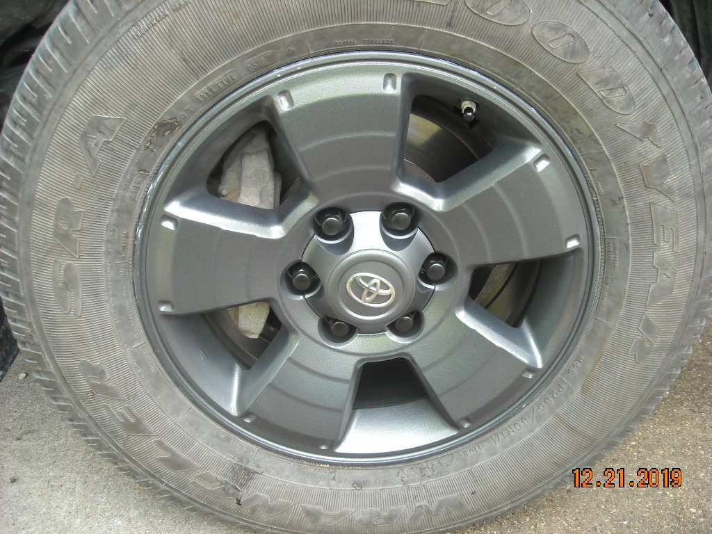

    I used Duplicolor Wheel Paint on top of Rustoleum self etching primer. I’m not too worried about longevity because I’m going to drag the wheels across rocks. A year in and no problem except trail rash.

    They were 4Runner aluminum wheels. Wire wheeled them down. Light sanding before the final top coat. No clear coat.

    This looks good. About to do this on some DC-2 wheels I have that are in pretty rough shape.
