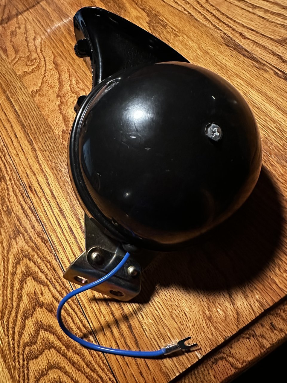

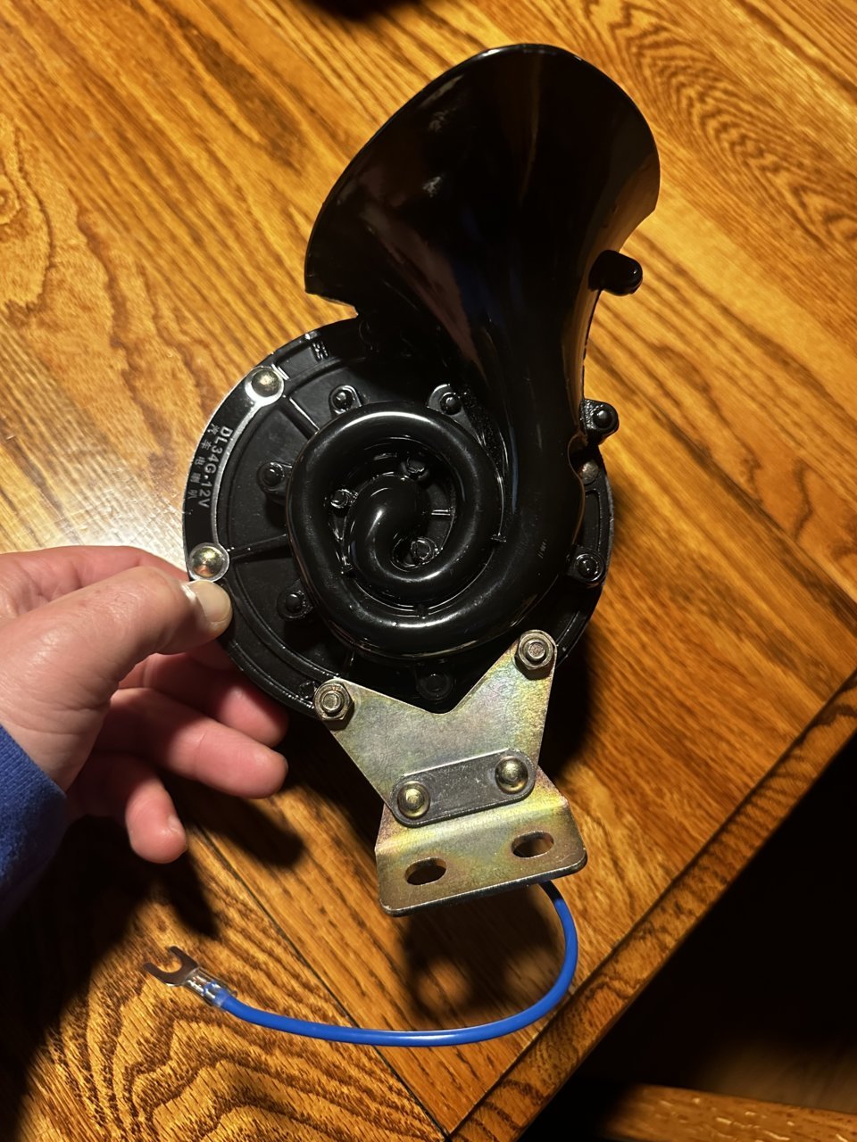

    Greetings all, new here from upstate NY, hour east of Buffalo.
    Anyone know what type of horn this is? I got it off some site a while back. Did not come with instructions. Only have 1 blue wire coming out of it as shown in the pictures . Was trying to make my wimpy OEM horm louder but not sure how to hook this up. Thanks in advance!D4E82FE2-3183-4816-8D0D-2A9D36D5F000.jpg 797EF7D4-0C35-44D7-A84B-68CA19DDFD2C.jpg

    Blue wire to power from relay, ground is through the mount.
    Basic Chinese snail horn. Sound will be kind of meh, you should have a little bit if adjustability in the tone by taking the cap off and there should be an adjustment screw that you can turn in for higher tone and out for lower tone. But it won't be much difference.

    dang it, should have known to buy Chinese junk, thank you for the info.

    Looks like a knockoff of the Lucas Windtone horns from the 50s -- perhaps going back to the 30s. I have two of almost exactly that horn on my 1962 Triumph TR3. They're normally in pairs with two different frequencies (and are marked Low and High) to take advantage of harmonics. The vintage ones, at least, aren't particularly loud.
