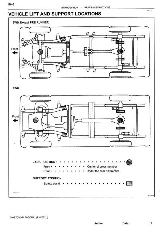

    ya those 3 ton works really well for the mini van and car but I think the 6 ton would make more comfortable. Where underneath the truck should I put the jackstand? anywhere on the frame?
