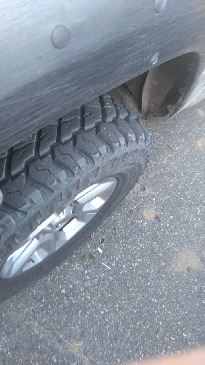

    I put 255/80/17 Cooper ST Maxx tires on my truck last fall, after putting on the 2" OME lift with Dakars in the rear and Total Chaos UCAs. I'm running stock 4runner wheels and got minor rubbing, mostly on the inner fenders. So, I pulled them off and now have some experience with mud and dust and wanted to post some information for those considering this.

    Aside from air intake concerns, there are some other considerations. You will get mud and dust EVERYWHERE. I've had muddy water leak out from around the headlight assemblies (just from driving on wet dirt roads - I don't take the truck "mudding"), and it collects up in the fenders and in the inside of the rear bumper like crazy. Here are some pics from around the truck after the elk scouting trip.

    There were rocks and leaves in hood hinge areas. Leaves, twigs, small gravel, etc. Also, mud really gets caked in the upper corner of the inside of the fenders by here.
    Pretty poor pic trying to show mud caked inside the rear fender area.
