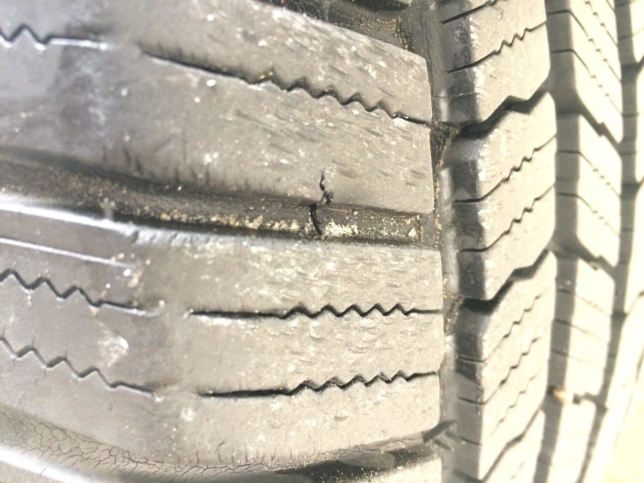

    I tried looking for the spec on michellins website to see how deep the belts were but couldn't find the info. Below is a picture of the slash:

    that's nothing, but if you are worried, smear some dish soap/water on that and look for bubbles

    Thanks guys. I have been looking for bubbles in the dishsoap all day and haven't seen any. Still no air loss after 60 mins of driving.
    It's surprising to me that the tire could take that without some damage.

    Doesn't look bad at all I wouldn't worry.

    Given that it's not leaking, nothing to worry about. If you do have a slow leak, you'll know the next morning, by walking out to a flat tire. Pretty fortunate for you that it's not leaking, because punctures that close to the sidewall aren't repairable.

    Aw man that ain't nothin'! If you're worried about that you should see some of the scrapes cuts and gouges in my BFG M/T's from spinning on rocks.
    Nah, that's no where near the belts or tire carcass you're good. It is however too close to the side wall to patch. If you tired you could run the risk of having the side wall split.
    As other have said check for bubbles with soapy water if you're really worried but Mich's are pretty stout.

    My concern wasn't the width of the slash. More with the depth of it. Still no flat this morning.
