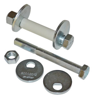

    would be a great step by step tutorial. with my luck it wouldnt be as simple as removing the cam bolt apply anti seize replace bolt done. those SPC cam bolts posted look like a very good alternative replacement for seized up ones if it were as easy as remove and replace, but im sure its not that easy to do, they sell specialized tools just to remove the seized ones.

    The cheap pot metal used on the eccentrics is not worth your time. The metal strips out after one alignment. Stick with OEM hardware and aftermarket such as whiteline or moog bushings.
