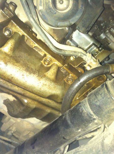

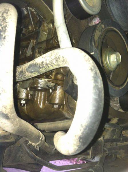

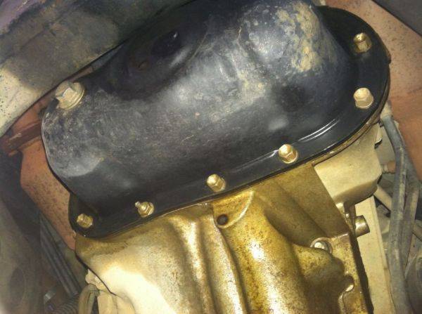

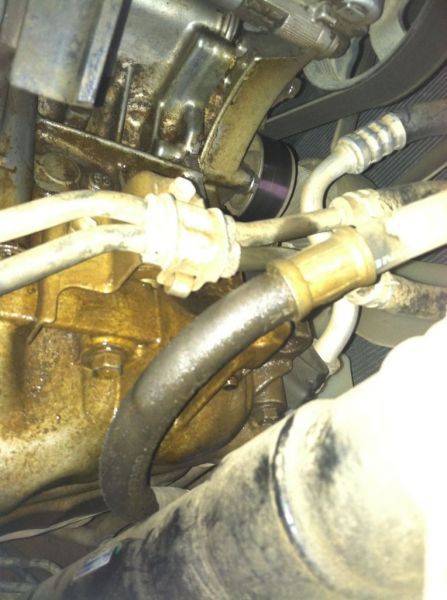

    I have a oil leak and it is starting to worry me, its been like this for a year at least but now i checked and there looks to be more...what do you think? really dont wanna have to throw thousands at this!

    figured it would be some gasket where tons of stuff has to be pulled or something like that...i cant even tell where its coming from

    OP, don't sweat it. Take some light powder (foot powder, flour, blow, baking soda) and dust the engine where you think the leak is coming from. Start it up and let it idle until it's warmed up. You will see exactly where it is leaking from.

    It will likely be the typical front cover leak right behind the powe steering pump.
    Some state it is due to the steering pump mounting setup that stresses the cover and creates the leak.
    There is a TSB for this ( T-SB-0326-08.pdf ) but no recall since it is not a safety concern. There never will be a recall for this.

    pretty sure i have the same problem, firestone told me it was power steering (I haven't noticed loss of fluid) and a toyota tech told me timing cover, i'm gonna believe the toyota tech

    Have the same leak. Took it to dealer under warranty. They said seapage is not covered, but a full on leak would be. Mine was only seaping. The tech cleaned the area and retorqued all the bolts n nuts, but wasn't authorized to perform the repair under warranty. It had been seaping since at least 30k miles, maybe more. Now I have 103k miles, and still seaping.

    It's definitely the timing cover. I see this problem everyday when I walk through the Lexus part of the dealership I work at. Even the Lexus is250 and is350's are falling victim to that same oil leak. Different engines same design problem. At least 1 of those gets done a day.
    If it was my truck I would just pull off the power steering pump and rub some rtv over the area it's coming from (caulk it like a bathtub). Seen it done that way many times. Sure it's not the right way to do it, but hey it beats $1200.
