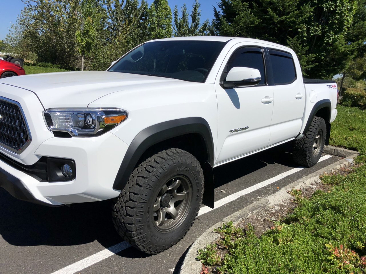

    I’m running 265/75/16 Duratracs on 16x8 countersteers with rokblokz flaps. Good luck!D3C5F6DA-F419-4346-B23D-C73D7D875227.jpg
