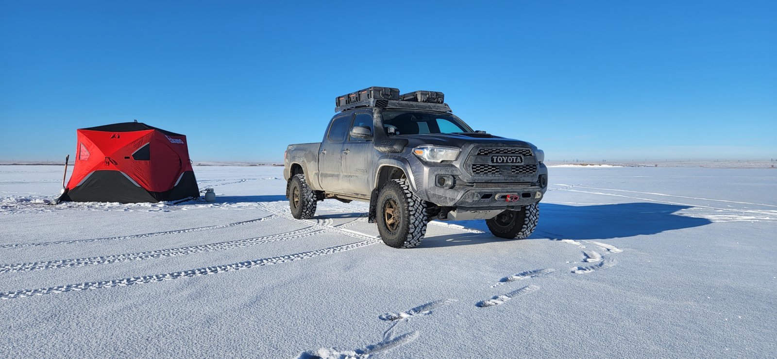

    2” lift with 265/75/16 tires:
    2” lift with 285/75/16 tires:
    The wheels are 16x8, -10mm offset.

    Nice, do the 285/75/16 fit with no rubbing issues with the 2" spacer lift? Is that all you did was a block spacer in the front shock and blocks under the leaf springs? That's what I was looking at, the entire kit's like $300 and probably another $500 installed. Was going to go with 265/75/16 tires now, but if 285/75/16 fit no rub, I might just hold off until I lift it.

    I used to have a 2” rough country leveling spacer kit up front. I have since upgraded to Bilstein 5100’s all around.
    The 285 G003’s fit with the RC kit with little-to-no rubbing on the road. Off road you need cutting and trimming. Probably also need a CMC.
    MPGs, braking and acceleration were garbage with the 33’s…but they were mud tires.
    The 265’s will fit with no rubbing even at full lock and fully flexed off road. They are also much more road-friendly.
