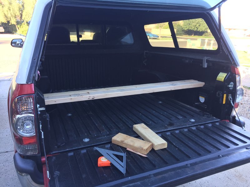

    I am using 2x4 cut to 57".

    A 2X6 is a bit too narrow to completely fill the width of the pocket. Mine slide around on my '13. FWIW, I also added a secondary tailgate cable attachment point that holds the top of the tailgate at the same height as the top of the boards. Use 2 fender washers to sandwich the bed side and hold in place with two nuts. Works great when hauling sheet goods.

    Indeed, great idea. I'm running 2 2x4's also at 57".
