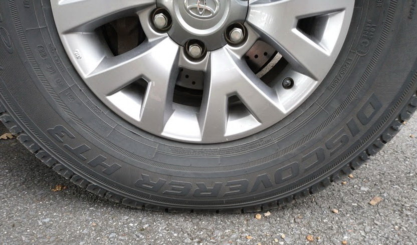

    I have a 2014 DCSB that I am running Cooper Discoverer HT3 LT265/75/R16, load range C, 112/109R. When the tires were installed, the tech aired them to 30 psi all around. I questioned his decision and he said that they only put in what is on the door column sticker. Of course, that number is based upon the original stock BFG P245/75/R16's. He said that after I leave, I can do whatever I want. Well at a cold (70 degrees) 30PSI this is what the tire looks like.
    So I have been airing them to 35. There seems to be no straight answer from either the dealer or the posts on this forum. I am on a lifetime rotation and balance plan, and every 5000 miles they reduce my pressure back to 30. Am I wrong to put more pressure in them? I am looking for a happy balance between better gas mileage and a smooth ride.

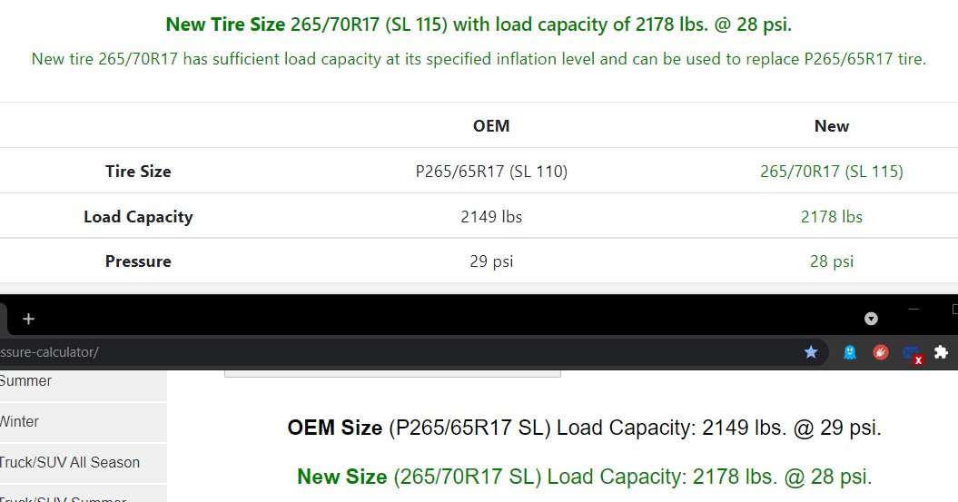

    I recently learned that apparently I've been running the wrong pressure in my tires ever since the stock P-metric 265/70r16 tires wore out and I switched to LT256/75r16. Have always heard to run what the manufacturer says and any place that's done the tires has done that.
    Recently went to LT255/85r16 and when I was researching the differences I came upon this site.
    You put in the info for the stock tire and what you plan to replace it with and it recommends a pressure for the new tire. According to this I should be running 38 psi front and 41 psi rear. Rather different from the stock 29/32.

    The different calculators will give different pressures because they use different load capacities.
    I still plan to do the chalk check.

    I just used both calculators and they gave the same exact calcs for my setup.
