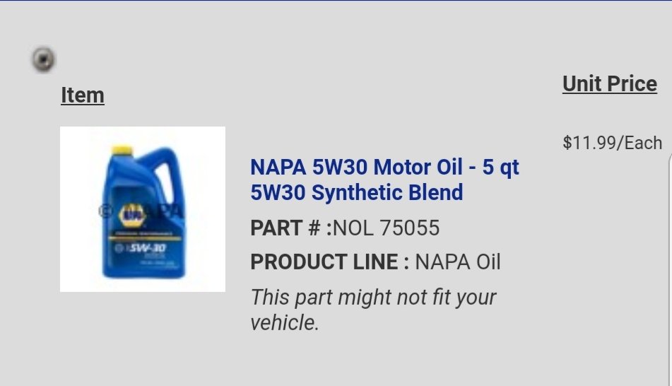

    Loaded up on napa syn blend a few mths ago $12 5qt jug. Whatever is on sale does the job.
    Plain Jane Taco and Hooligans like this.
