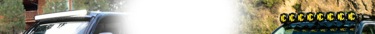

    The Roof Mounted Lightbar/Lights
    I've noticed that this is easily one of the most popular mounting locations for aftermarket off road lighting, but is it the best? For one, I feel like a Spot beam pattern light would be the most effective here, given it's high mounting position and the desire to keep excess light off the hood of the truck. However, I feel like these lights are primarily served best for trucks travelling at a decent rate of speed down a dirt road. Are they wholly necessary? I've heard that mounting a light bar here typically results in increased wind harmonics, so I figure (At least for me) this would be one of the last places I'd add a light bar, but I'm still curious about what works best up high.
    Baja Designs says:

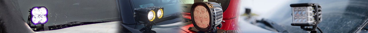

    A-Pillar/Ditch Lights
    These lights I feel are pretty self explanatory in terms of mission. Pods meant to cast light to the side of the truck. I have certainly seen the need for them, and they'll most likely be my first off road lighting upgrade due to the relative low cost, and the function they serve. However, what is the ideal beam pattern for A-Pilla/Ditch Lights? Flood? Combo/Driving? Also, is it better to have clear light or Amber/Selective Yellow?
    Baja Designs says:

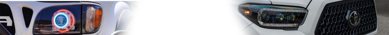

    Upgrading the Head Lights
    Specifically Retro-fitting OEM headlights or purchasing quality aftermarket units. This seems like the best ROI of all lighting upgrades, but can they undo the need for adding Off Road lighting? How do you supplement and/or complement them?

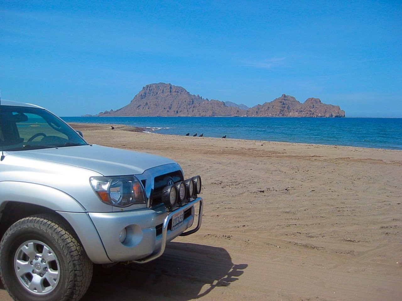

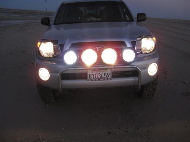

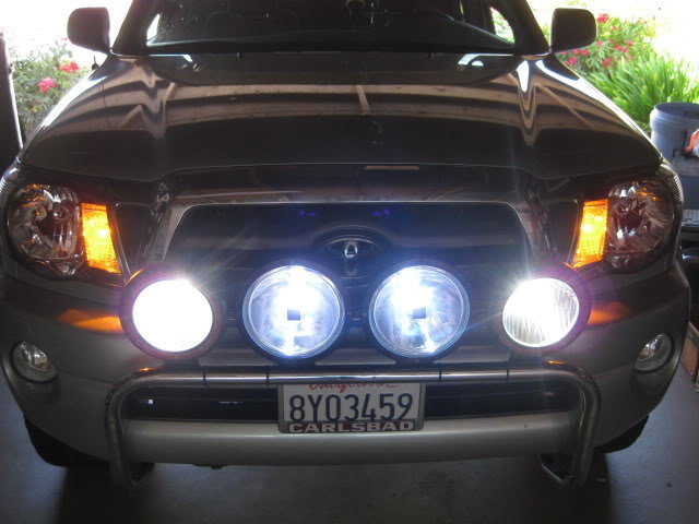

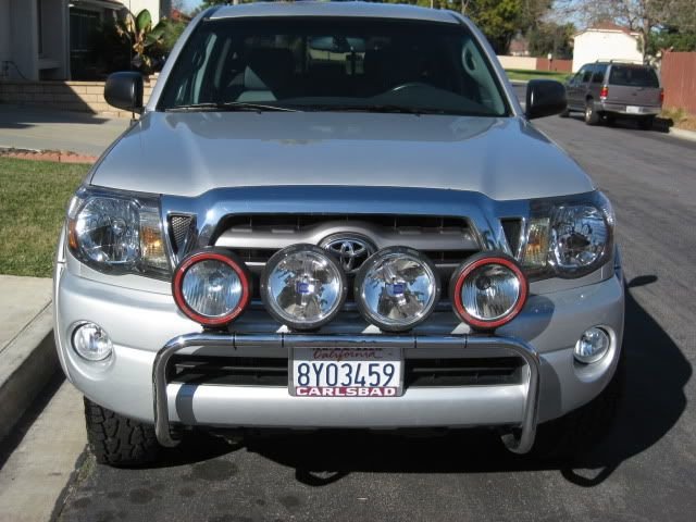

    As a fan of lighting and a real need to illuminate the Baja desert and beaches, at night. I have made a few adjustments over the years.
    The images above are from 2012 and I have a custom made light bar (made at Stewart's RaceWorks) with two Hella 4000 halogen 100 watt pencil beams and two Kragen HID 'Euro' beams.
    I next converted the Hellas to HID. The results were not as good as I hoped. I had to swap out the HID unit more than once to get the correct color temperature (I was seeking no more than 5,000° for pure white but not blue light). There was also the flickering issue. The Kragen HIDs were great but the plastic housing eventually failed on Baja's rough roads!
    The lighting distance was great!
    The final solution came when a traveling friend showed me all metal, CREE LED lamps and he sold them to me! Two are pencil beams and two are driving beams.
    They are extremely bright, use less power, and with metal housing are Baja proven!

    The Roof Mounted Light bar/Lights
    Roof line lighting solutions are still quite popular. I think it was a big trend that hit the off-road community a few years ago but I think people are starting to notice it's not the best location because of the glare. That's not to say you can't successfully run this setup. There's a few members that have used several tactics to remove or minimize the glare. For example, moving the light back on a roof rack or using a deflector on the bottom of the light. Although this decreases the glare, you do lose a little bit of light. Depending on the mount you use or roof rack, you might experience some noise but there are ways to combat it. As far as a lens pattern, I always recommend a spot lens (9 degree beam) on a roof line application. This will allow the beam to travel across the hood whereas a flood lens might bounce off it. This is from my observation but everyone has their own preferences and how much glare they can tolerate. I'm a fan of NO glare. :) A positive aspect is a roof mounted light bar can extend your upward beam. You'll find guys here that run lights on their front bumper and roof line to maximize their coverage.
    There's two different ways you can setup an A-pillar light, as a ditch light or a spot light.
    Ditch light: Pointed typically about 45 degrees from the A-pillar. This is used as a cornering light to spread out your beam. I would say a wide cornering lens is the more popular option. Some will do driving/combo to get more distance. It just depends on what kind of scenery you'll be seeing, open deserts or tight forest trails, and make the assessment from there.
    Spot light: Pointed straight. This is usually focused for long distance and a spot lens is used. You'll experience slight glare from the hood in this setup. For some, manageable and others unbearable.
    *Amber is used for poor conditions such as dust, snow, rain, or fog. It will cut through rather than reflect like a white light does. Think of it as if you were driving through a thick patch of fog. By turning on your vehicle's brights, it doesn't necessarily allow you to see farther. Instead, it makes everything up close brighter and you'll have to go back to your low beams.

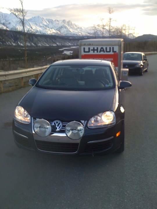

    It's cute when your aux lights aren't bigger than your headlights. Here's what I ran in Alaska:
    But I feel BD's got it right. Start with the bumper, then add others depending on your needs.
    Personally I'm going to put a 1 or 2 layer flood pattern on the bottom part of my grill. Then once I get a roof rack, haven't decided between a bunch of KC's (back to the future) or a tight beam spot led bar, I hate glare also.
    Personally don't like ditch lights being visible. Can probably solve that with roof mounted.
    Hey Meso, need you to design a mount for the front of our mirrors lol.
