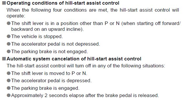

    How does it work? From the manual:

    It has always been less than 2 seconds for me, but now that I read the conditions I may be canceling it early by getting on the accelerator. Next time I'm on a hill I'll just focus on positioning the clutch and see how long I'm held.

    I dont know of any Manual transmission that can place the shift lever into "P" location in the gearbox....
    see the excerpt from the manual for the truck:
