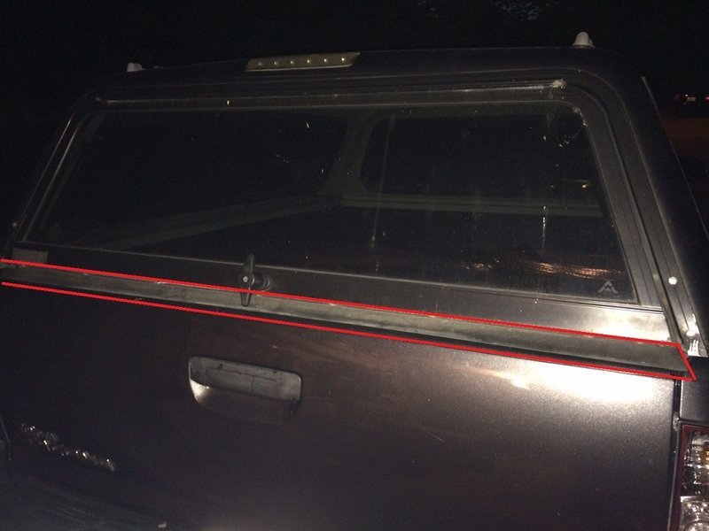

    Picked up a used cap for a decent deal but the bottom piece of my cap rear window is broken/missing. It's an A.R.E cap. What is this piece usually called and is it possible to buy just this piece? Would be within the red lines. It has a few rivets so it's looks like it is replaceable as it would be under a lot of wear and tear. There is a rubber seal still intact that slides in a channel. I really can't shell out $400 for an entire rear window.

  6. Jul 3, 2016 at 5:44 PM
    areaccessories
    areaccessories Truck Cap and Tonneau Cover Manufacturer
    Jan 22, 2016
    #175740
    12
    Massillon, Ohio
    This part is called a "rear door contour strip". It is replaceable and can be ordered from any A.R.E. dealer with the serial number of your topper. You can find your closest dealer by going to www.4are.com and putting your zip code into the dealer locator. Hope this helps you.

  7. Jul 4, 2016 at 6:45 AM
    badhaircut
    badhaircut [OP] Well-Known Member
    May 27, 2016
    #188062
    77
    2012 TRD double cab long bed
    Thanks for all the replies and thank you Bryan for narrowing it down for me. I googled "rear door contour strip" and found nothing that would be similar.
    To me though, contour strip means something soft like a rubber seal which seals to the contours of the tailgate. The missing part is hard plastic.
    I think I will end up buying a piece of aluminum flooring threshold, cutting to size and riveting to the existing door. Any thoughts or other ideas as I'm trying to get this done on a very small budget.

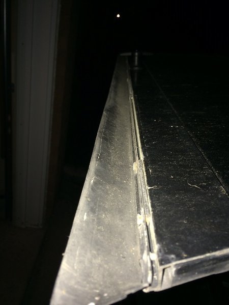

  11. Jul 5, 2016 at 9:07 PM
    phx13
    phx13 Well-Known Member
    Oct 18, 2015
    #167036
    4,546
    Rob
    2015 DCSB TRD O/R
    MT stuff, RTT stuff, the usual.
    Its basically a plastic / kydex / whatever piece that covers the seal. Mine had a 2 cracks in it when I bought the shell used, the guy thought it was called an "over flap" but wasn't sure. Hasn't bugged me enough to find a replacement yet.
    Don't mind the dirty truck :cool:

  12. Jul 5, 2016 at 9:13 PM
    badhaircut
    May 27, 2016
    #188062
    77
    Thats perfect and thanks. I'm sure I can jimmy something up and I am going to have to because the truck shop wants $100 for this edge. I'll take pics and post when I'm done.
    Thanks again
    phx13[QUOTED] likes this.
