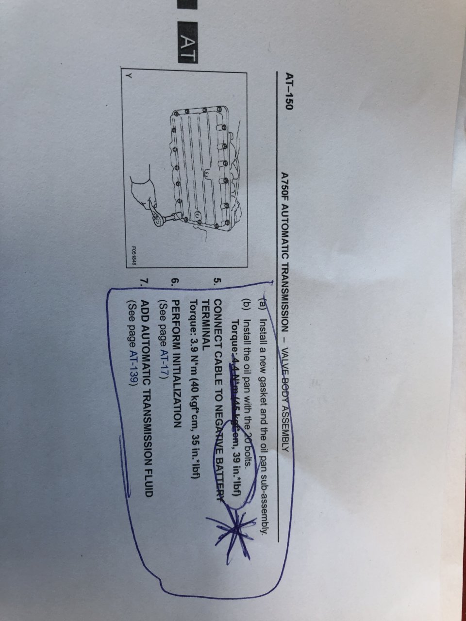

    In my service manual one page tells me the torque is 30 in-lb and other 21 ft-lb.
    I made the numbers and 21ft-lb is a world more than 30 in-lb. Am I right?image.jpg

    The 2nd pic that states 21ftlbs is for the drain plug. However, several TW members have stripped their pan by torquing the plug to that spec, because, apparently that spec is for dry threads. Personally, I’ve never used a torque wrench on a drain plug.

    I just did a pan drop and full flush on my truck two days ago. I had to buy a new pan because I tried to torque the drain plug to 21 ft.-lbs. and it stripped the pan.
    I had never done a transmission flush before so it was a $172 lesson learned.

    Thank you guys, now I see where I’ve been wrong, It saved my day asking you first.
