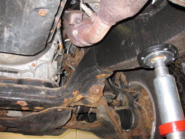

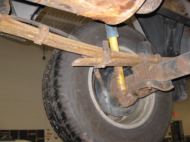

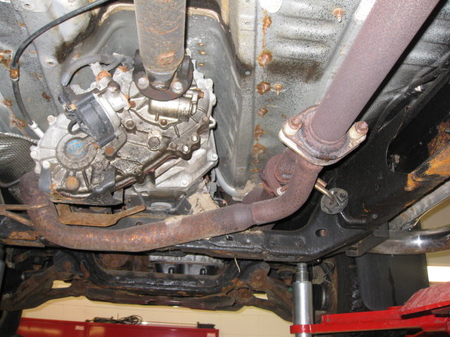

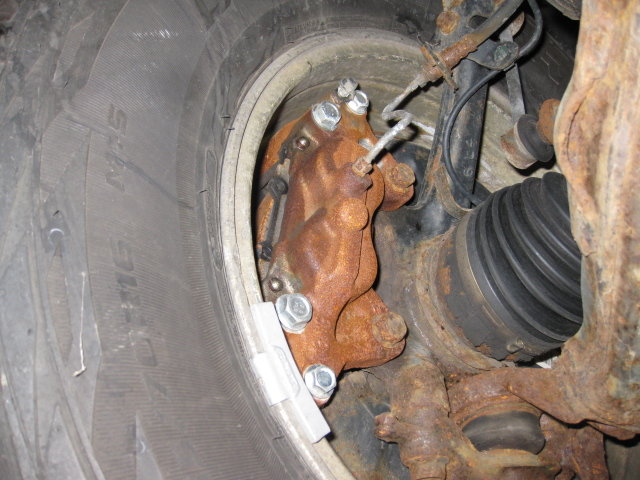

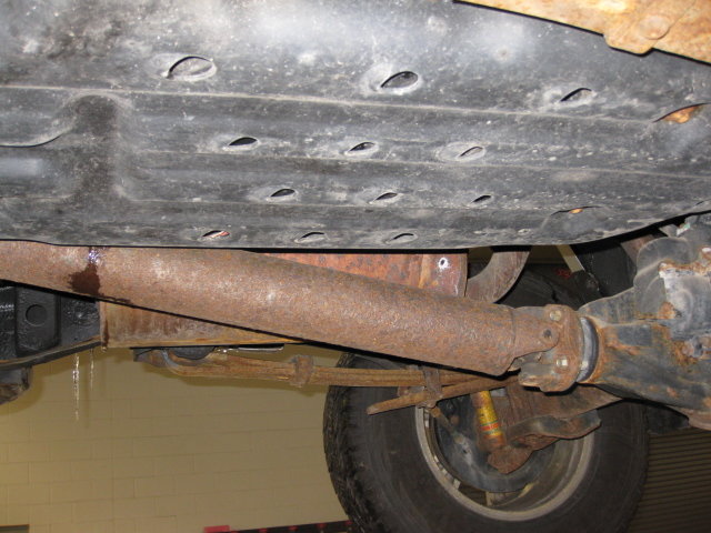

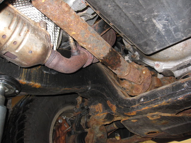

    I purchased a 2005 TRD off-road from a Toyota dealer 2 years ago. Big mistake, I took their word for it that the rust was not an issue, without requesting pics (purchased online). Anyways, suffice to say that both the Toyota dealer in town and 2 independent auto shops said the truck is not safe to operate. The used car manager at Toyota said it's worth parts at this point. It's been sitting in my driveway for nearly 2 years now. It's a shame, only 99k miles and looks new if you don't get under the truck....
    With the lawsuit proceeding, I was hoping that someone could tell me what the "rust perforation standard" mentioned in the lawsuit is? My frame doesn't have holes yet, but big chunks of steel are flaking away. When I purchased the truck, 2 years ago, Toyota (manufacturer, not the dealer) told me it had rust proofing applied (in 2013), and didn't need a new frame. The rust proofing has all flaked off of course, painting over rust doesn't do a damn thing. I am worried (rightly so) that they will try to deny this claim as well.
    Here are some pics. Thanks in advance!

    Pictures of frame doesnt look bad at all. Seen much worse. What did they say that was unsafe. If it doesn't have any perforations it is driveable. Start spraying frame and suspension with oil to slow down corrosion.
    Also look at frame near the front cats. A well known source of frame perforations. We also need to see more pictures of the frame, not suspension parts. Most of what I see is just surface rust that if not treated with develop into more serious rust later.
    Also be aware of where it is parked. Parking on grass is a great way of speeding up the existing corrosion. Park on gravel, concrete or blacktop when possible. At this point even a heated garage may be detrimental to the existing rust.
