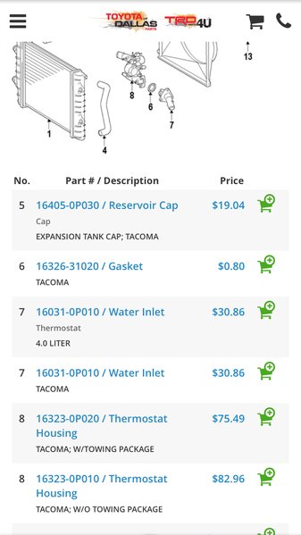

    Toyota Thermostat at Toyota of Dallas is $30
