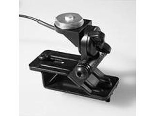

    The mount is something that I splurged on and am really really happy with. I bought the accessory mount and have a Hondo Garage Perfect Squeeze that holds the head unit. I've also got the tablet mount. With the tablet, I can tie my friends APRS signal from their radios onto a map on my tablet and see exactly where they are. I'm working on getting that all self contained so I won't have to rely on cell service to do that.
    https://expeditionessentials.com/products/toyota-tacoma-3rd-gen-usb-powered-accessory-mount
    My antenna is a Comet CA-2x4SRNMO with the added spring mount. It's tall but not too crazy. And I can hear repeaters 60+ miles away from my location on the valley floor. In the mountains I change to a shorter antenna because of the elevation differences and the radio signal not broadcasting straight out on a relatively flat pattern.

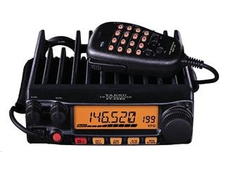

    I ended up getting the Midland MXT275 Micromobile and 3dB stubby antenna. The antenna I stuck through the firewall and attached to passengers side on the hood. I went super stealth and velcro'd the base unit under the dash and used an add-a-fuse micro tapped into the hazards for power. I got an extension for the handset and wired it through center console and through the glovebox so it can be hidden away when not in use.

    Hard mount:
    Midland MXT275 with a NMO stubby antenna mounted at the back of the truck
    ICOM 2730A with a NMO mount on my hood.
    Home base is a Kenwood TM261 with a attic antenna
    The nice part is I have dash plugs for each of the hard mounted radios in my truck so I can unplug the mic and store it in the glove box and the rest of the radio is out of sight out of mind.
