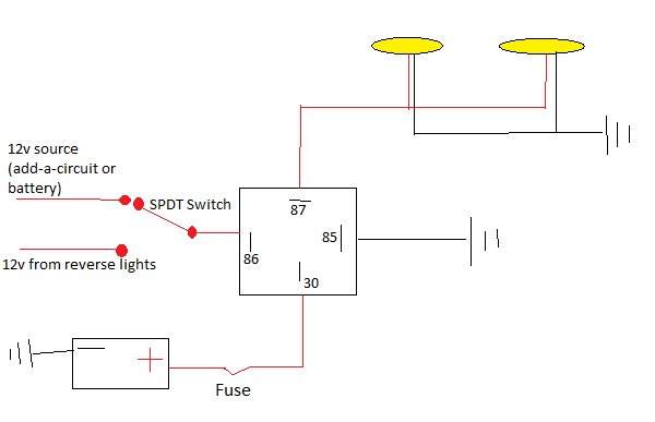

    For wiring, the best is to hook them up to a SPDT switch, or On-Off-On. Then you can choose to have them come on with reverse lights, not at all, or by themselves.

    Ah, I like this. Can you extrapolate a it more EatSleep? Diagram perhaps?
    I'm digging this. I thought I had to choose..

    This afternoon when I get off work I'll take the time to whip up a diagram for you :thumbsup:

    Here you go bud! I'm no electrical guru, so if anyone sees any obvious flaws, feel free to point them out.

    You are The Man. Thanks very much, this helps a lot!

    No problem!! Let me know if you have any questions about what any of that means.

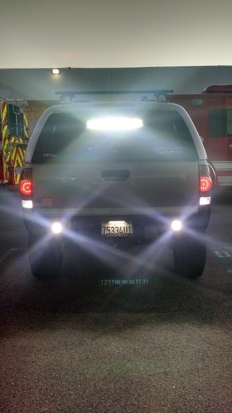

    Using 2- 18w 4" under the bumper and a 20" led bar in the camper shell. Both eBay brands and work great. Just added a relay off the factory reverse wire.

    Nice. Can you post a close up with the lights off I can see how they're mount better?
