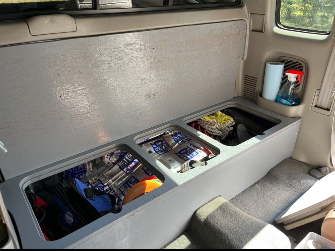

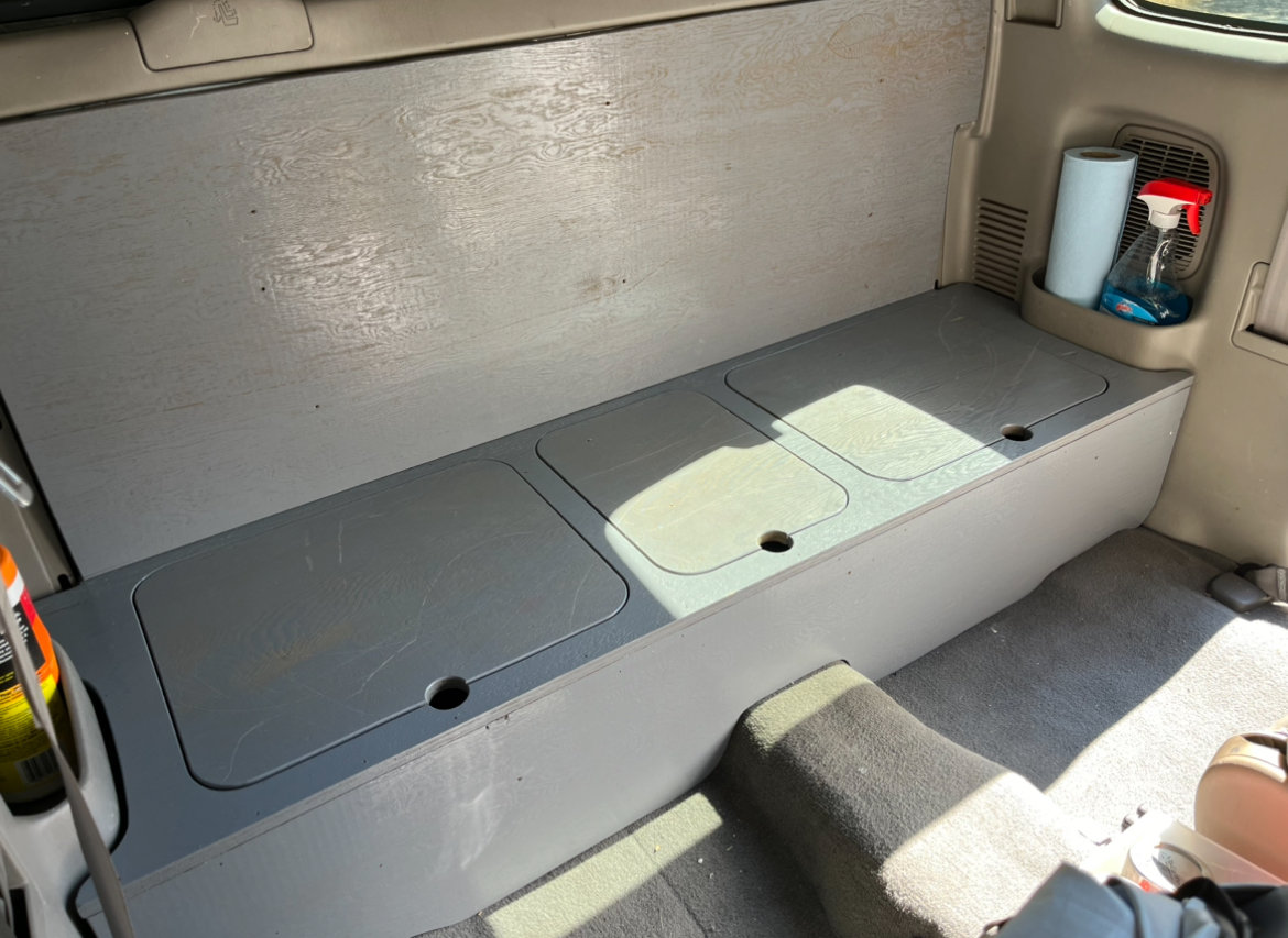

    Did you remove the original seat frame?
  2. Aug 5, 2024 at 9:00 PM
    dannybubbles
    dannybubbles yada yada
    Sep 5, 2017
    #229168
    120
    Daniel
    Stevenson, WA
    01 3.4 auto 4x
    Most definitely, just unbolted everything and binned it. cut the carpet back and sound matted the floor inside the new box.

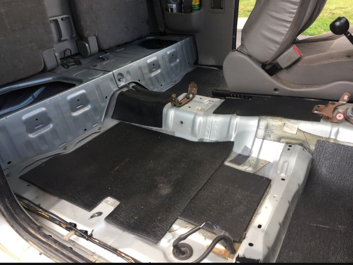

    Do you have a pic of the original seat frame out? I want to see what it looks like to possibly scheme on building something similar.

    No progress pics unfortunately, but the metal subframe is just held in with screws and comes out in two pieces. Its decent gauge sheet metal but I suspect thats for holding up butts.
    I cant imagine its helping anything, or integral, from a structural point of view.

    Found a pic where you can see the two pieces I removed:

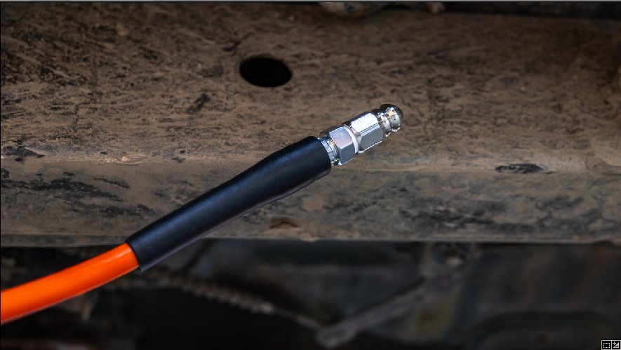

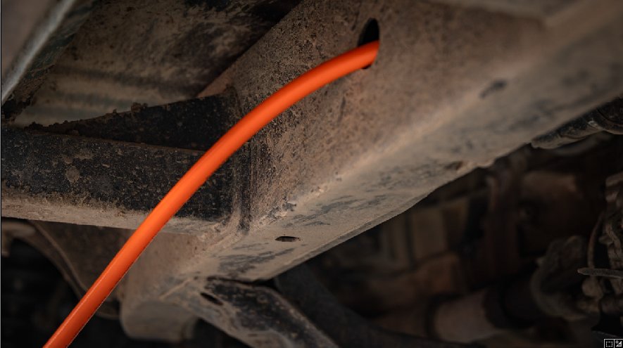

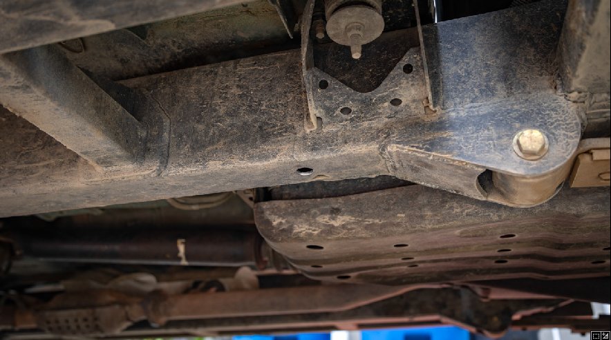

    Washed out the inside of the frame with a pressure washer. Not sure if I was more satisfied or terrified as shit came pouring out of the front (and newly created rear) drain holes. It wasn't just dust/dirt that came out. There was a good amount of rust flakes. To be expected, I suppose, on a 25 year old truck, but still.
    I was a little worried about whether this pressure washer "kit" would fit into the frame, but it was no problem through the big round hole on the side of the frame. The "mushroom" fitting - third from the left, which rotates about 1M revolutions per second, spraying water diagonally backward, seemed to be the most effective.
