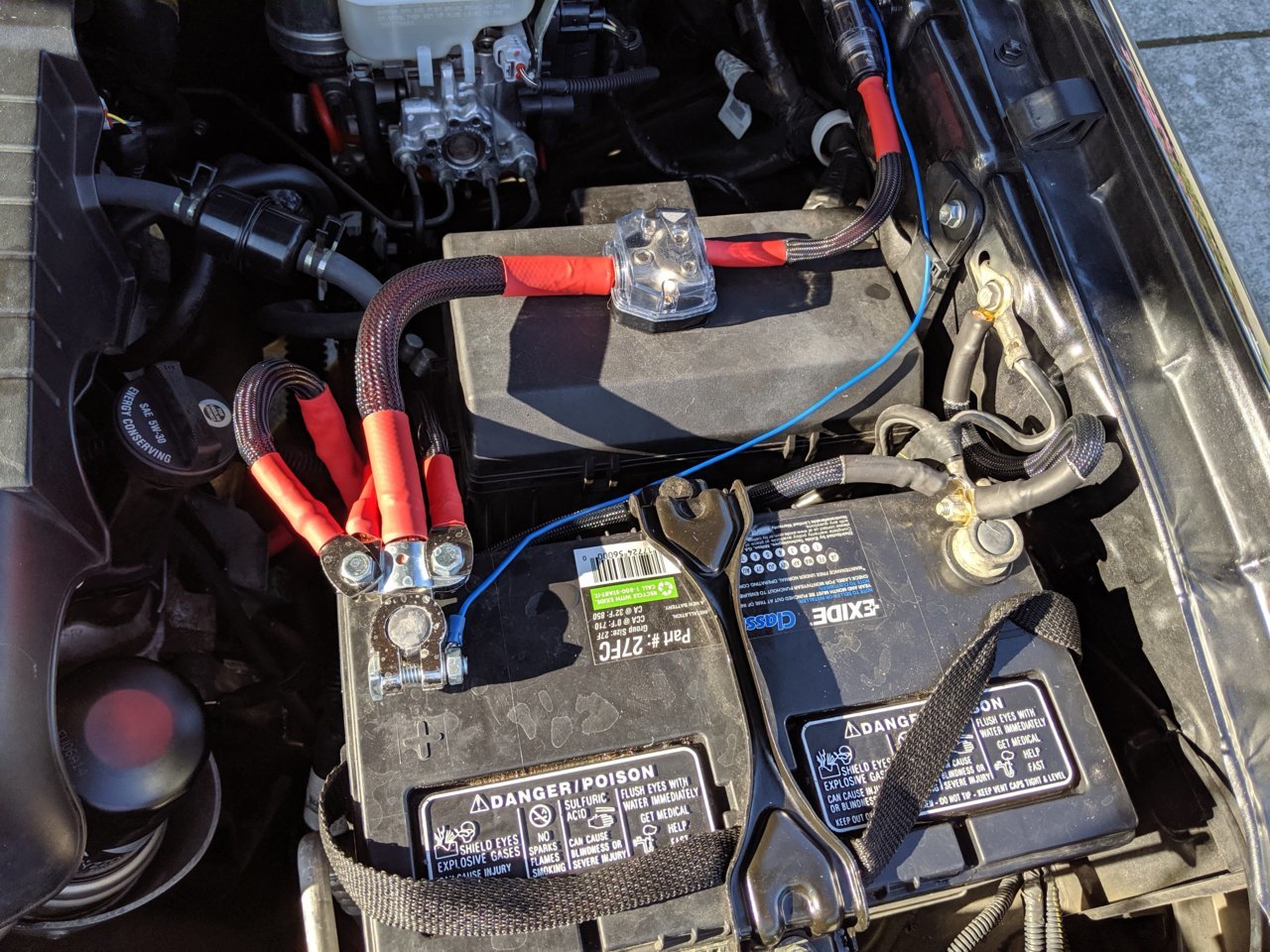

    Replaced positive batt terminal. Did the big 4 upgrade (yes 4, not 3). Then did 1/0awg to a distribution block on the fuse box which branches out to 4awg for my amp in the cab, and future 4awg to a winch. Always plan ahead. Need a new neg batt terminal to match.

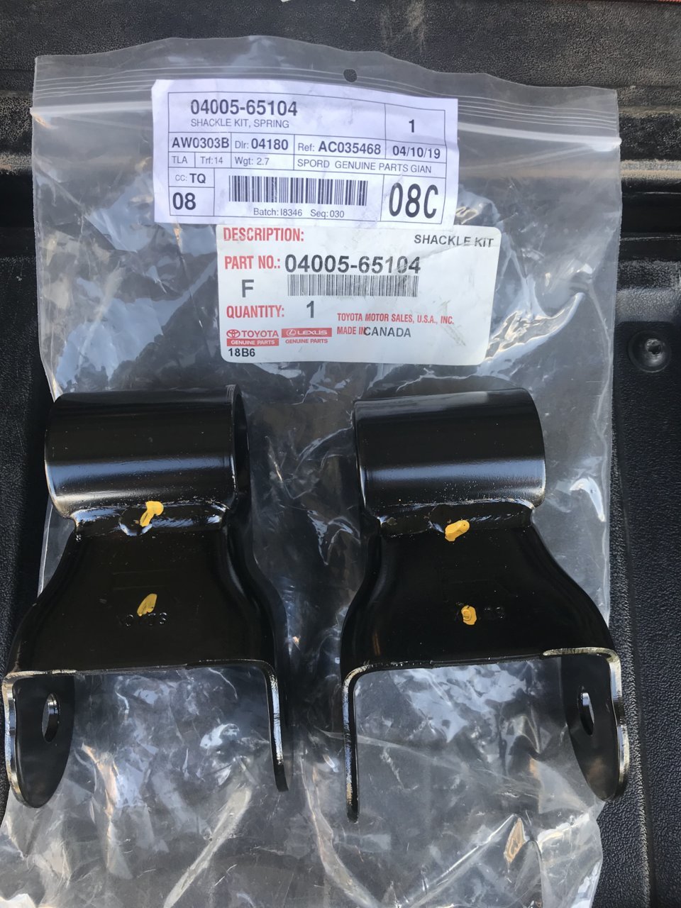

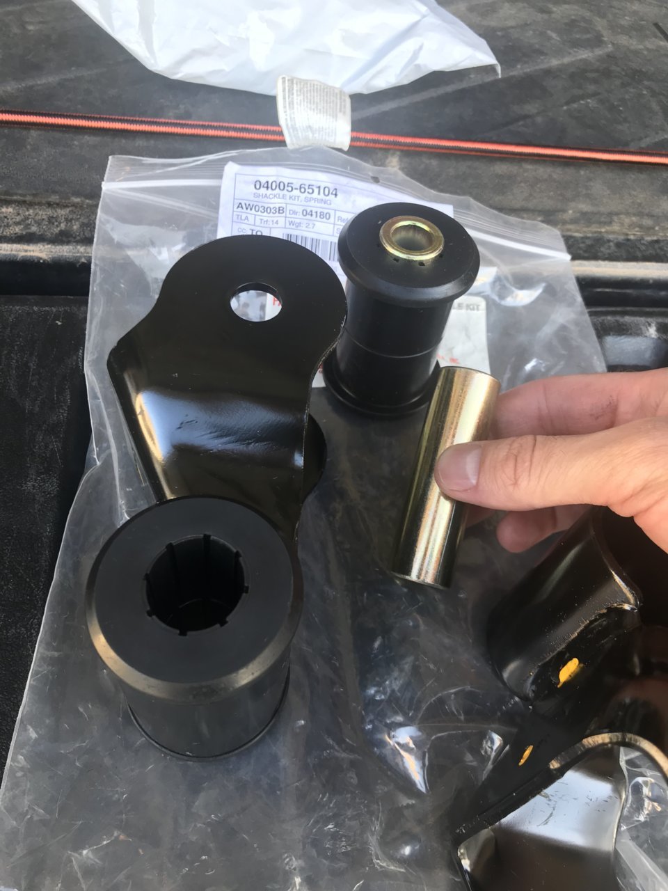

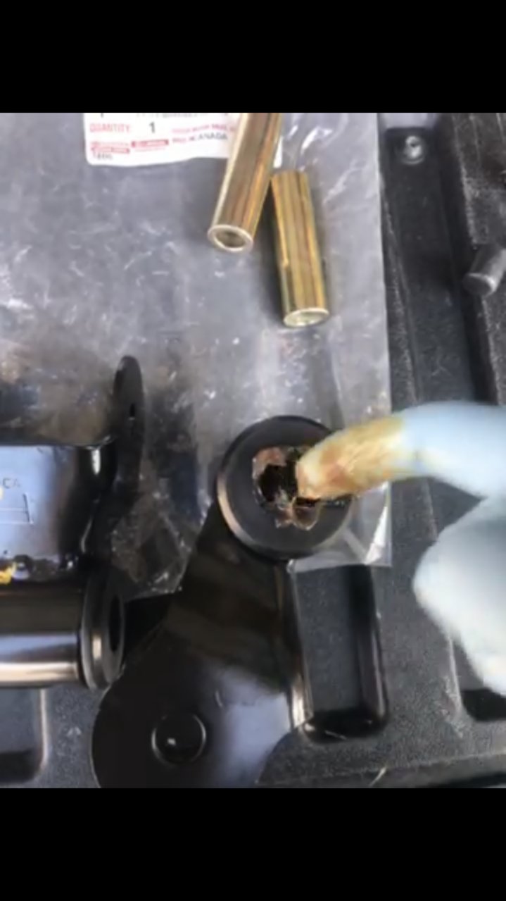

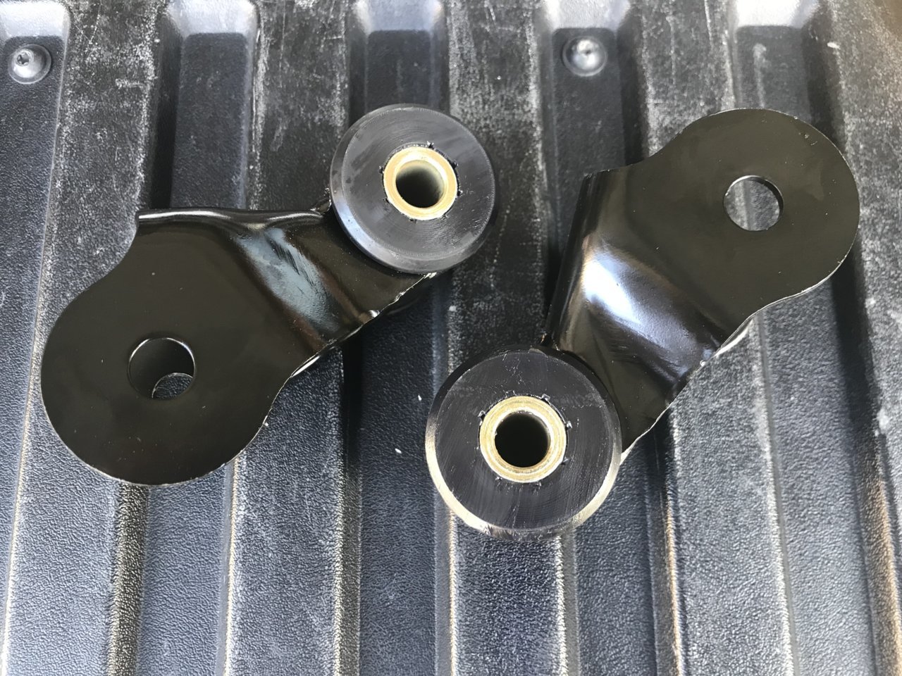

    Special thanks to @EatSleepTacos for educating the masses on how you can do a ton of expensive work to the rear end of the Tacoma but if you don’t replace the OEM bushings in the leaf shackles, they’ll bind to the point where they rarely/if ever fully droop out (horizontal).
    Polyurethane greased bushings sleeves are the solution. I finally got all mine in order and I’ll throw them in next week before my next wheeling trip.
    Since it’s a royal pita to try and replace the OEM bushings in the OEM leaf shackle, you can buy new, hollow OEM bushings for about $35/pair & find poly bushings online. I purchased mine from @ARCHIVE for about $35. I can’t wait to throw these in. I have seen first hand, when one side of my rear end should be fully drooped but it is not (as evidenced by the shackle on the droop side not even being horizontal), thanks to the OEM bushings binding. If you care about any of this, hopefully you’re also running shocks that expand at least 27” or more & of course brake lines etc.
    It’s an awful feeling knowing someone you may love and care about could be missing out on extra travel on their tacoma just because of their shackle bushings. #themoreyouknow

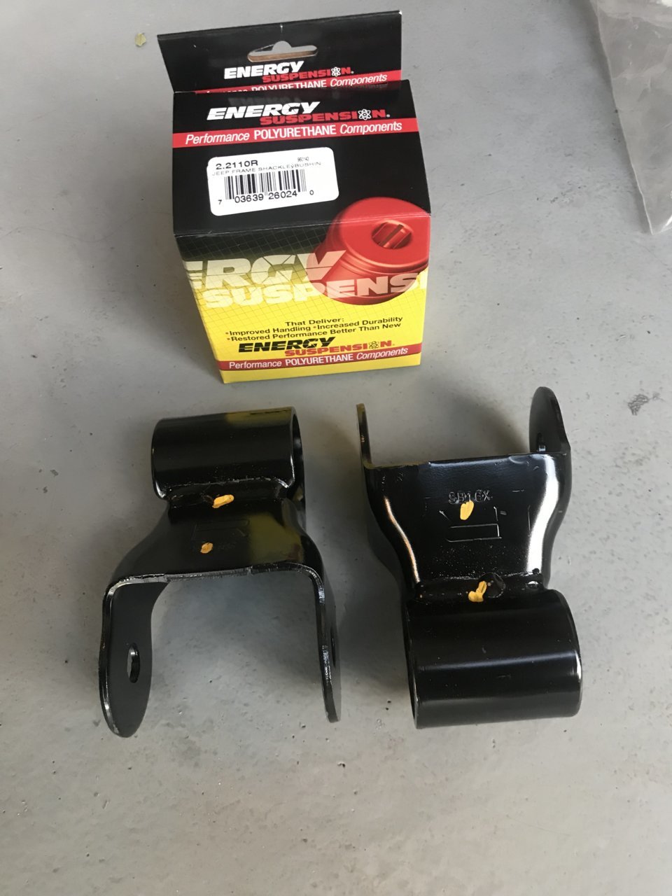

    Just a heads up (if you bout the Energy kit) the shackle bushing is different from the leaf bushing. Don't get them confused.

    Thank you! I actually bought the ES bushing kit hoping they’d fit but they’re too small/not correct. The bushing kit archive sells (as pictured in my post) is the correct kit! I didn’t need new leaf bushings just new hanger-to-shackle bushings!

    You may have got the wrong kit. For future reference.
    8.2116G - black
    8.2116R - red
    https://www.amazon.com/Energy-Suspe...leId=1&vehicleType=automotive#customerReviews

    yeah.. thats ones for a Jeep.
