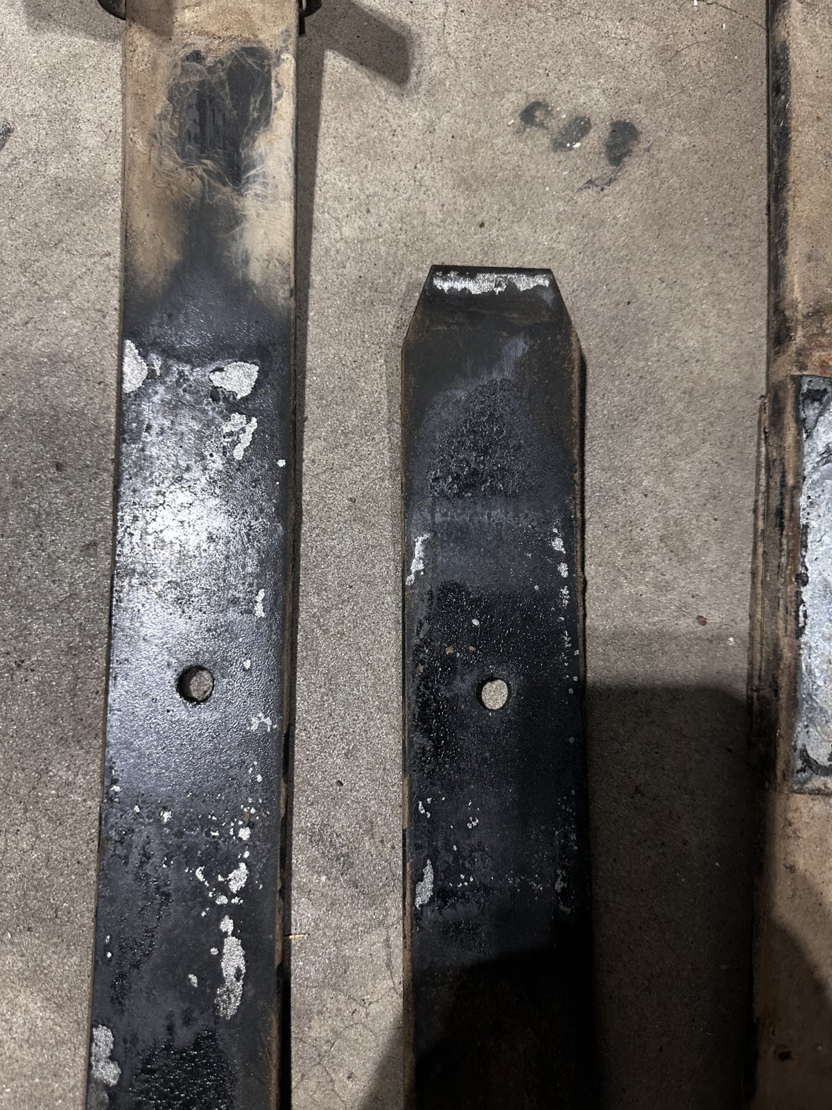

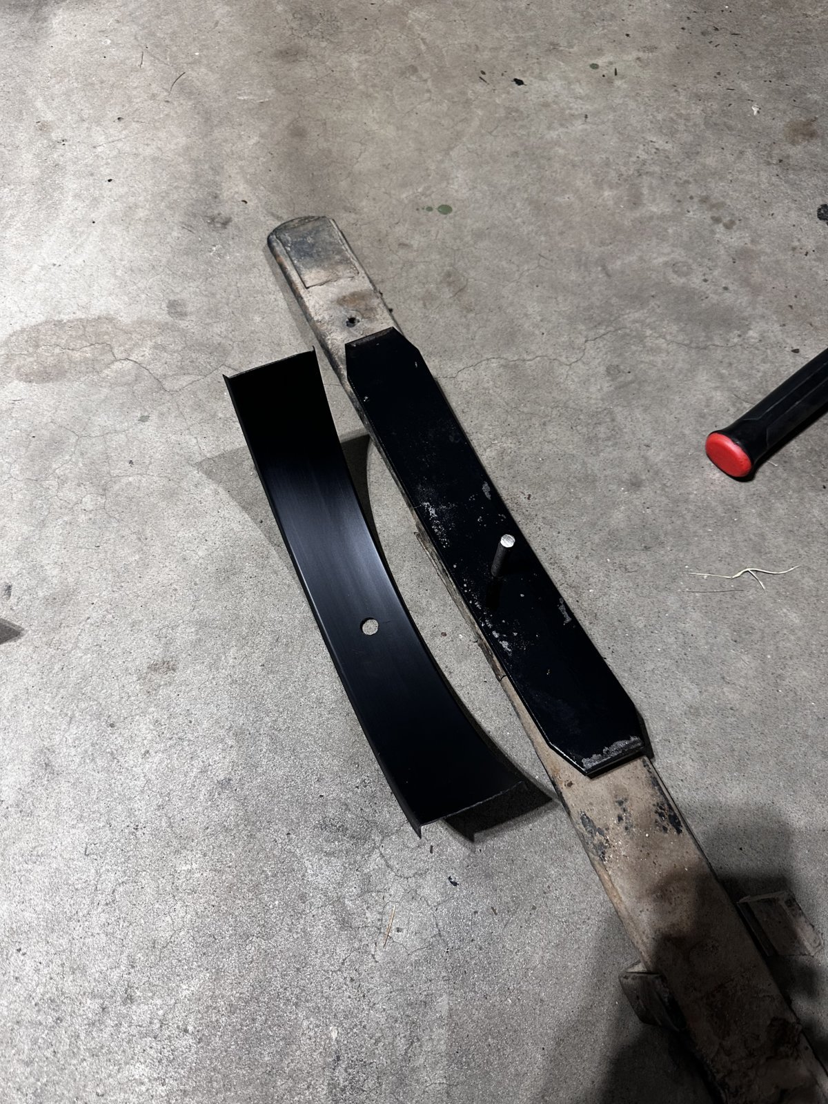

    Put on an Icon add a leaf and after 3,000 miles they started squeaking like an old mattress. Tore them apart and found the two smaller leafs without isolation pads were definitely rubbing. Cleaned them, sprayed with silicone lube and cut liners to go between the leafs. No more squeaking for now.

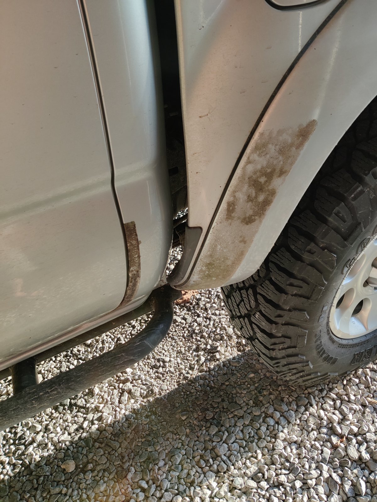

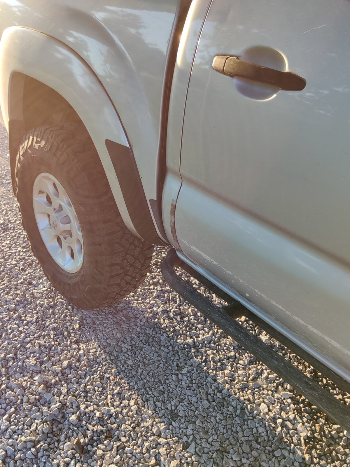

    These weren't looking too good.
    So I've been washing\scrubbing them vigorously every was. This is how they looked.
    Took a razor blade to them today. Then used soap and water to scrub followed by wiping down with vinegar.
    Finally installed Tuffskinz.

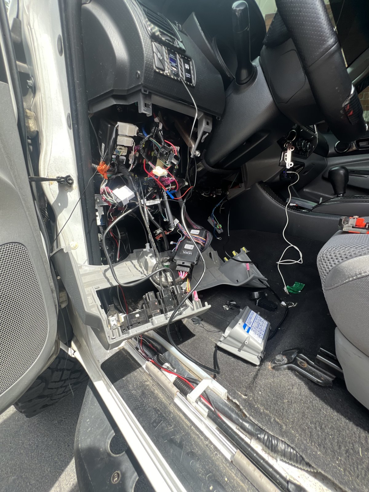

    So many extra wires. Time to simplify.
