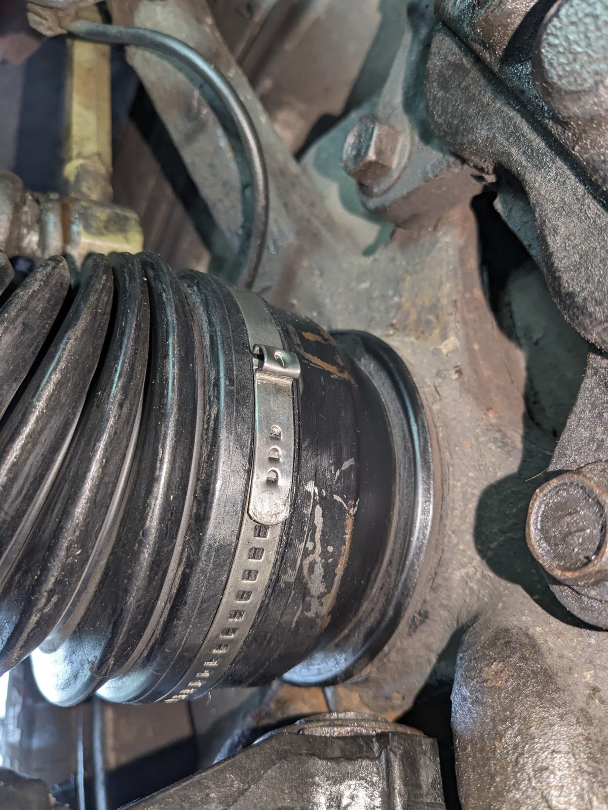

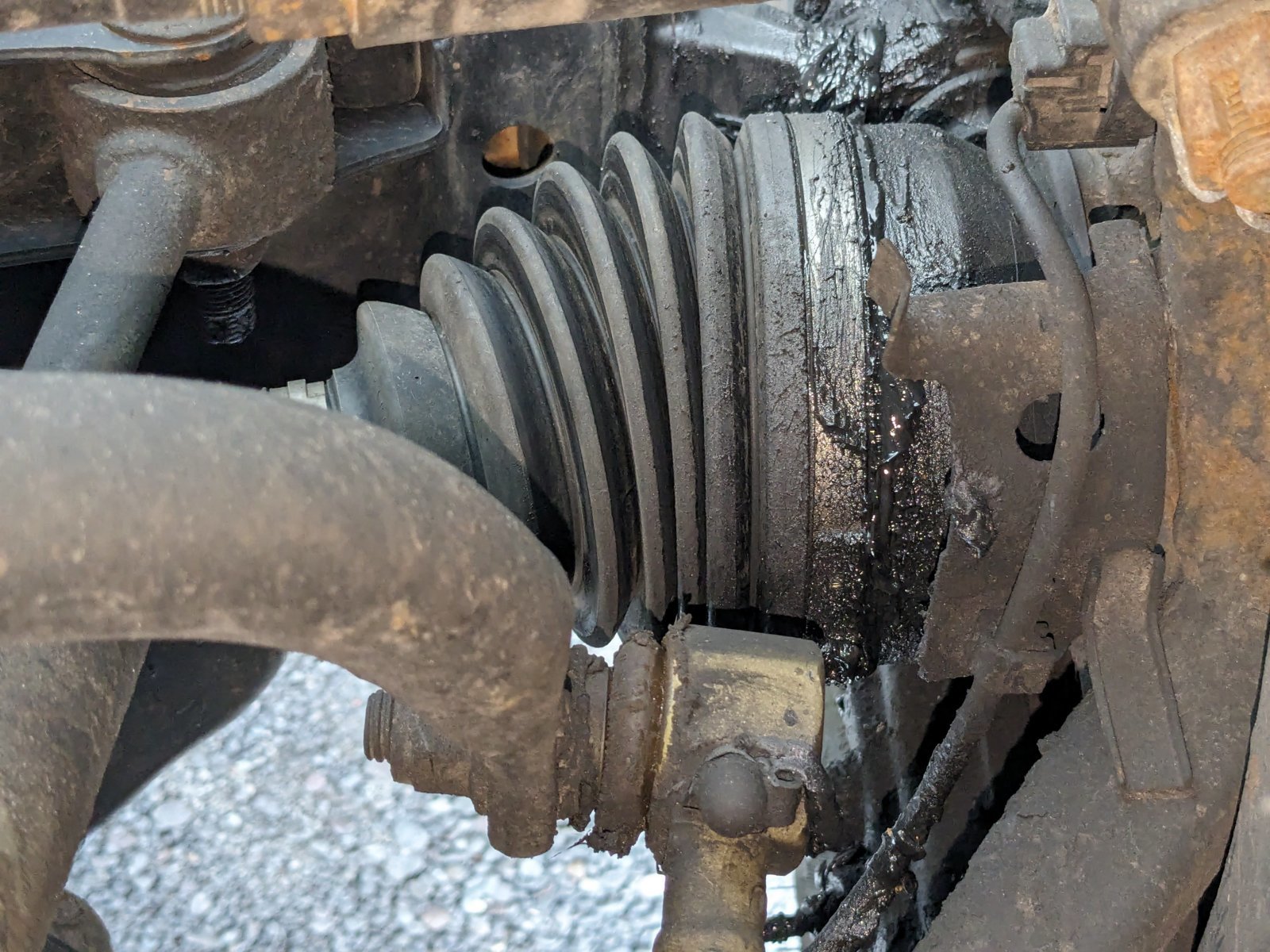

    Fixed a leaking (not ripped) 3 month old CVJ axle boot.

    I’ve got one starting to leak out the outer side also. Was it just a new clamp to fix? If so what banding/clamping tool to did you use?

    Oetiker crimp tool.
    Knipex side jaw. Knipex both side jaw. Cheap weak generic kind. Amateur screw type. Pro screw type. Take your pick.
    assuming it’s that and not some weird Toyota one that it might be. Where it has to clip together in one spot rather than squish. Forget what I jury rigged to do that. Might have even squeezed it with two flat heads.
    hardest part if you separate a hose clamp is putting it back together with the little multiple teeth at the end fully seated back into the square holes, engaged, good shape to them

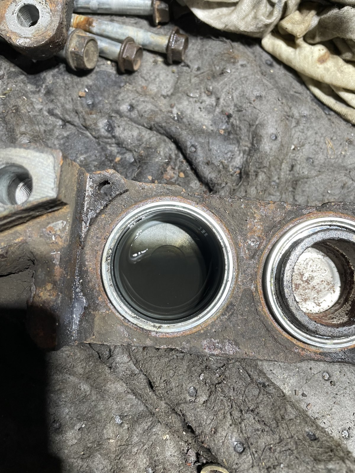

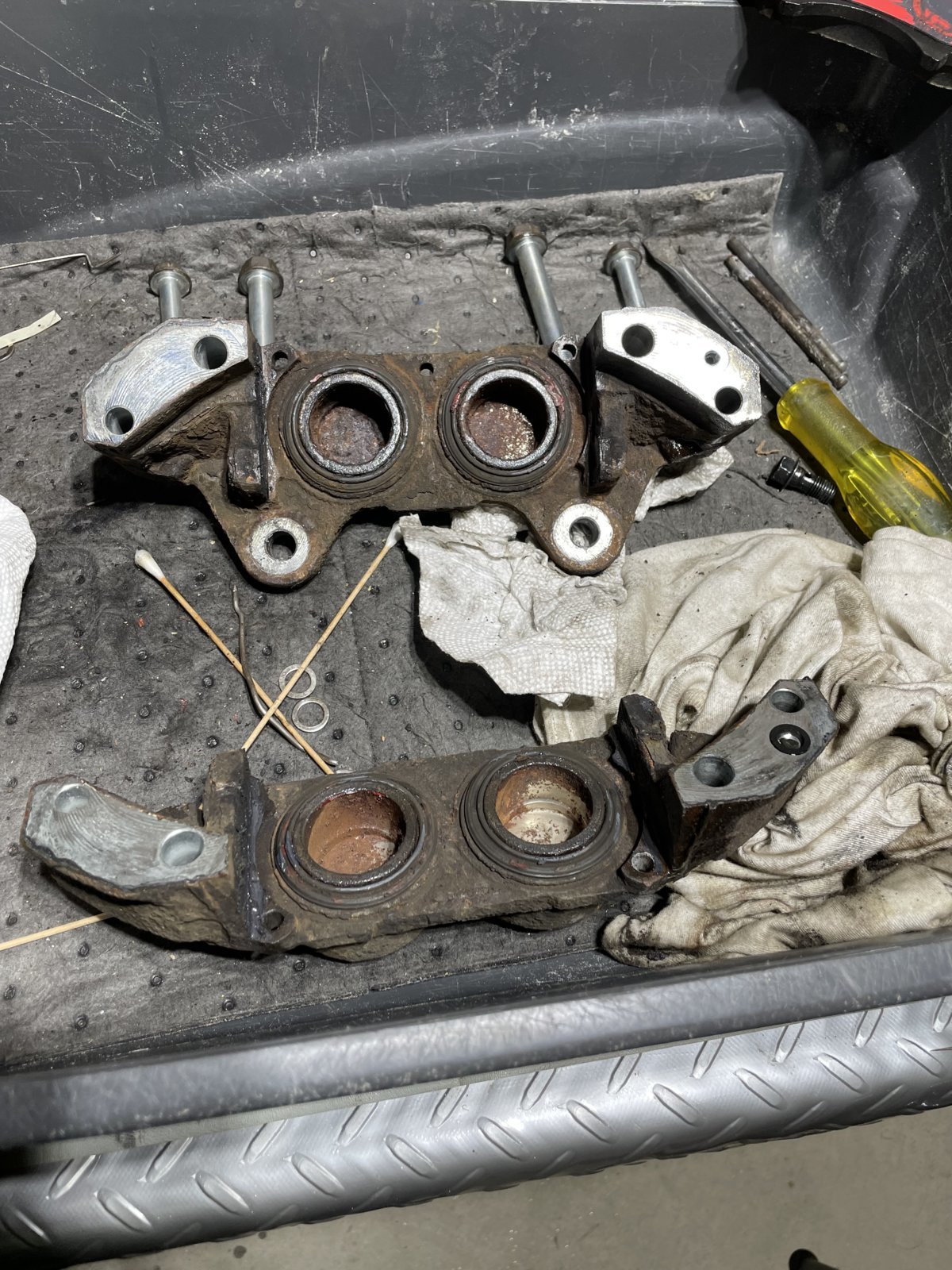

    Rebuilt my calipers. Wow were they in bad shape. Far worse than I thought.
    Took me about five hours to do the two calipers. Before assuming that I’m completely incompetent YES I did try to blow the pistons out with my air compressor but they wouldn’t move. Had to pry them out.
    Glad I did it though because I found black/gray stuff in the fluid.
    Just wish I would have known what I was in for, I would have bought refurb from the parts store and put the Toyota rebuild kit parts on.

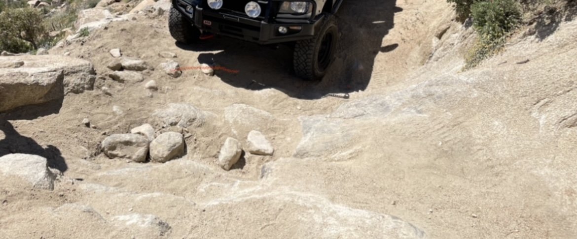

    burned the clutch one time going up gatekeeper gonna forget pretend that didn’t happen and knock on wood no further issue
    lesson learned for the future
    Line up, back up
    commit to a full send launch in gas to spin tires with momentum IMG_5463.jpg

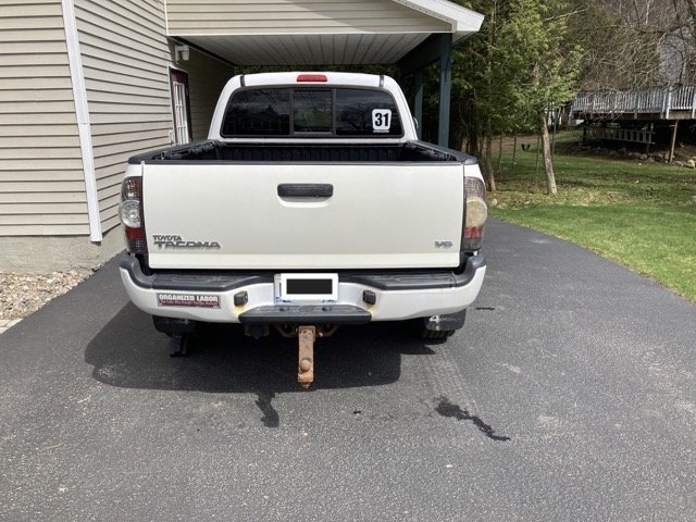

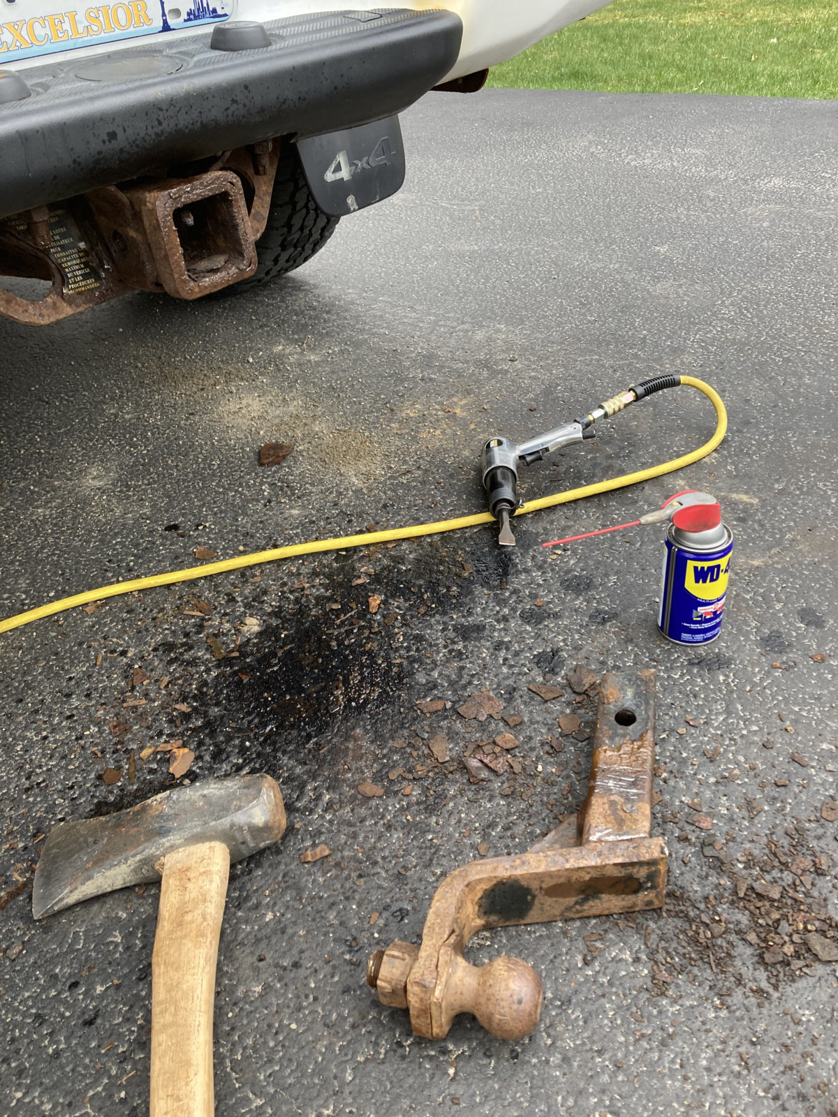

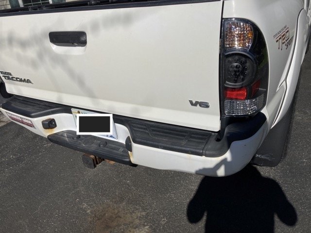

    Just got this 2013 Sport. Spent a ton of time wiping down the interior while I wait for parts to arrive. Replaced the taillights as one had been superglued. Then removed the rusted on tow hitch.
