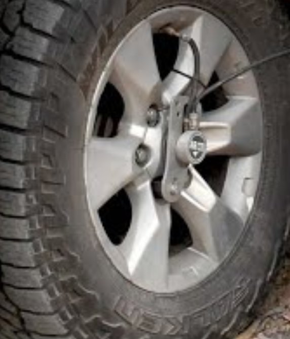

    added CTIS for 50 bucks

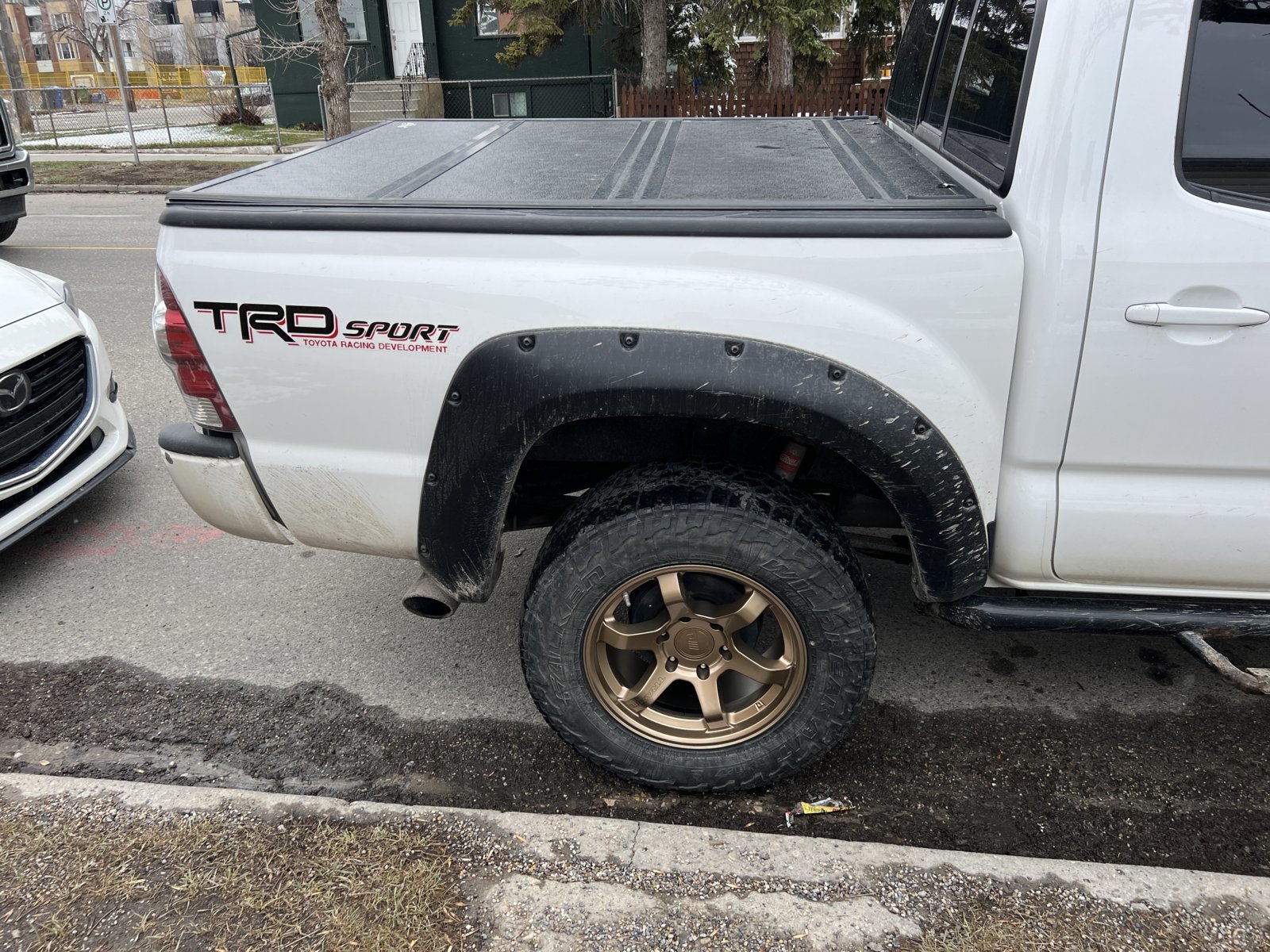

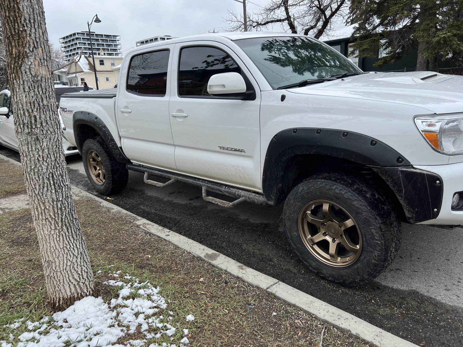

    New Wheels! Motegi Trailite 17 x 8.5 in Bronze

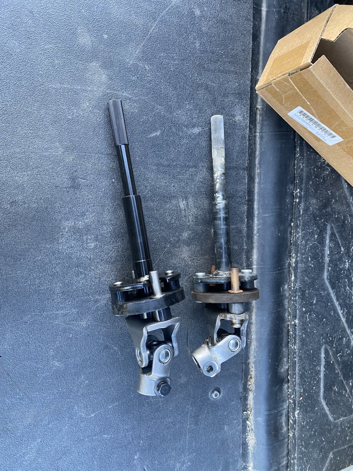

    Replaced this piece of shit.

    Why?

    The rag joint and bushing are worn out.

    More info on this? I'm intrigued, reminds me of the guys in Iceland run on their rigs.

    isnt there another second piece that goes bad too?
    How was the job?
    big if true kinda wanna know if it can be upgraded
    Was told it can be by another 2nd genner
    supposedly the thing to do is weld it solid. Or make it all metal. So it does not have rubber to slop and wear.
    the caveat being it’s not exactly breaking in an accident anymore.
    Don’t know how necessary that is. Folks run steel bumpers and don’t drive headfirst into walls.
    And I don’t think any previous car I’ve had used one of these…
    I think this is kinda what took out Senna in F1, but that’s F1…
    or maybe it’s just easier to replace whenever it’s due and call it a day.
    I really hope there is an alignment like German cars where it only goes on one way
    instead of no alignment and just a universal 360deg spline that goes on any way and can be a headache…
    in terms of alignment, centering steering rack, centering tie rods, counting steering wheel turns, etc…

    There’s an upper and lower shaft.
    The bushing and rag joint go bad on the upper.
    The U joint goes bad on the lower.
    Ive already replaced the lower when I did the rack bushings.
    You can weld it, but all the road/steering vibration gets transferred up to the wheel.
    The rag joint is there to absorb said vibration.
    it’s spined, but not keyed.

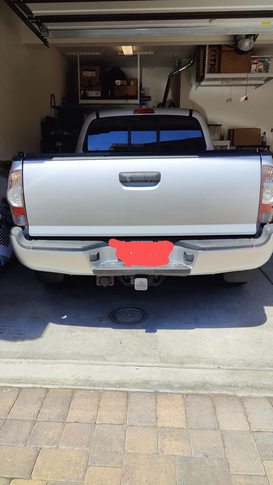

    No night shots, Here's a link. I honestly don't remember where I bought it from.
    https://www.tacomalifestyle.com/products/morimoto-tacoma-x3b-led-third-brake-light-2005-2015

    Did you do it yourself then?
    If so, how long did the job take & were there any choice words used?

    Super easy.
    Less than an hour.
    But I had already had the lower shaft off before so the coupler wasn’t frozen.
    If the coupler is frozen, have fun.

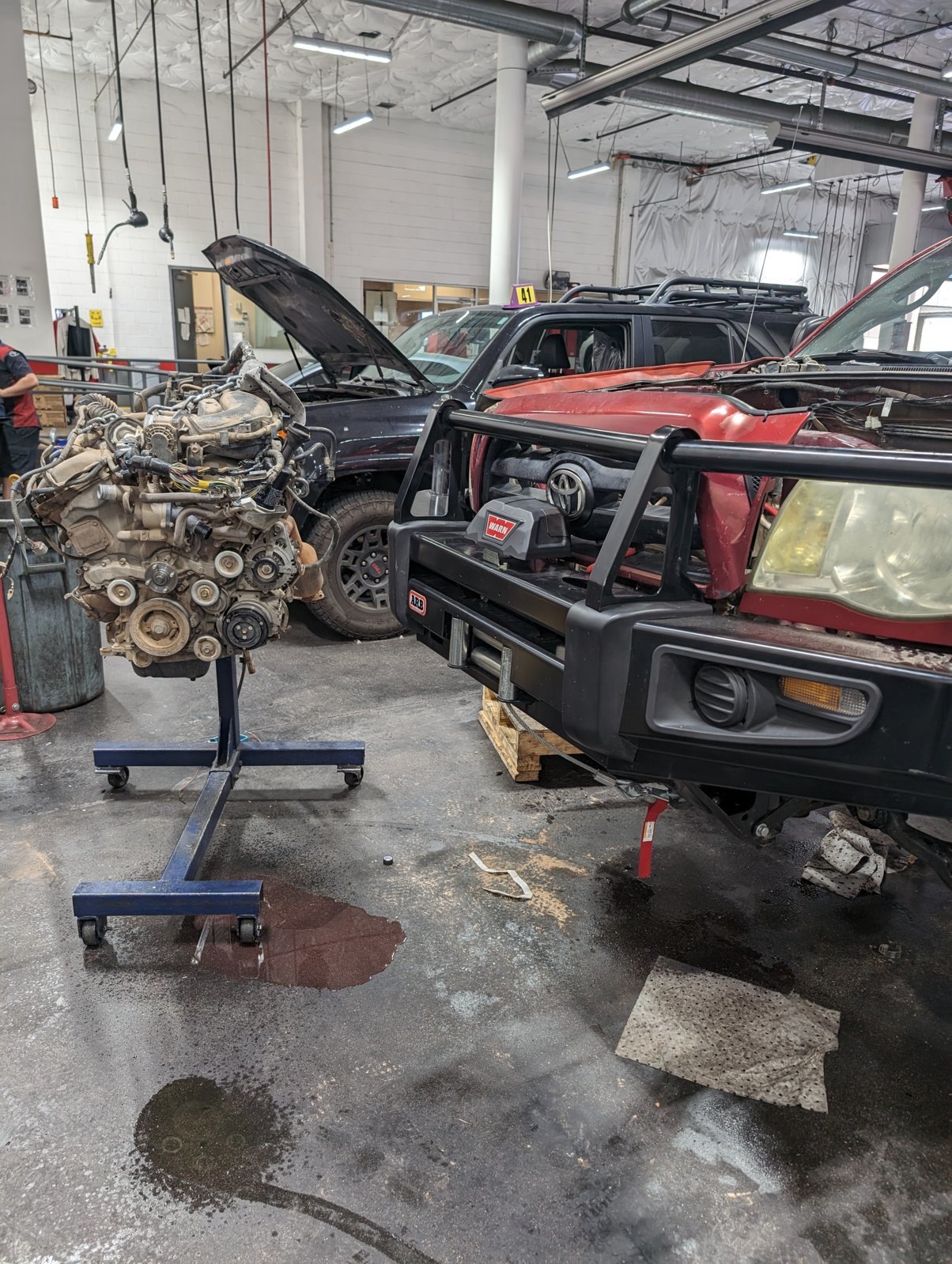

    Blew a head gasket. Time for a rebuild.
