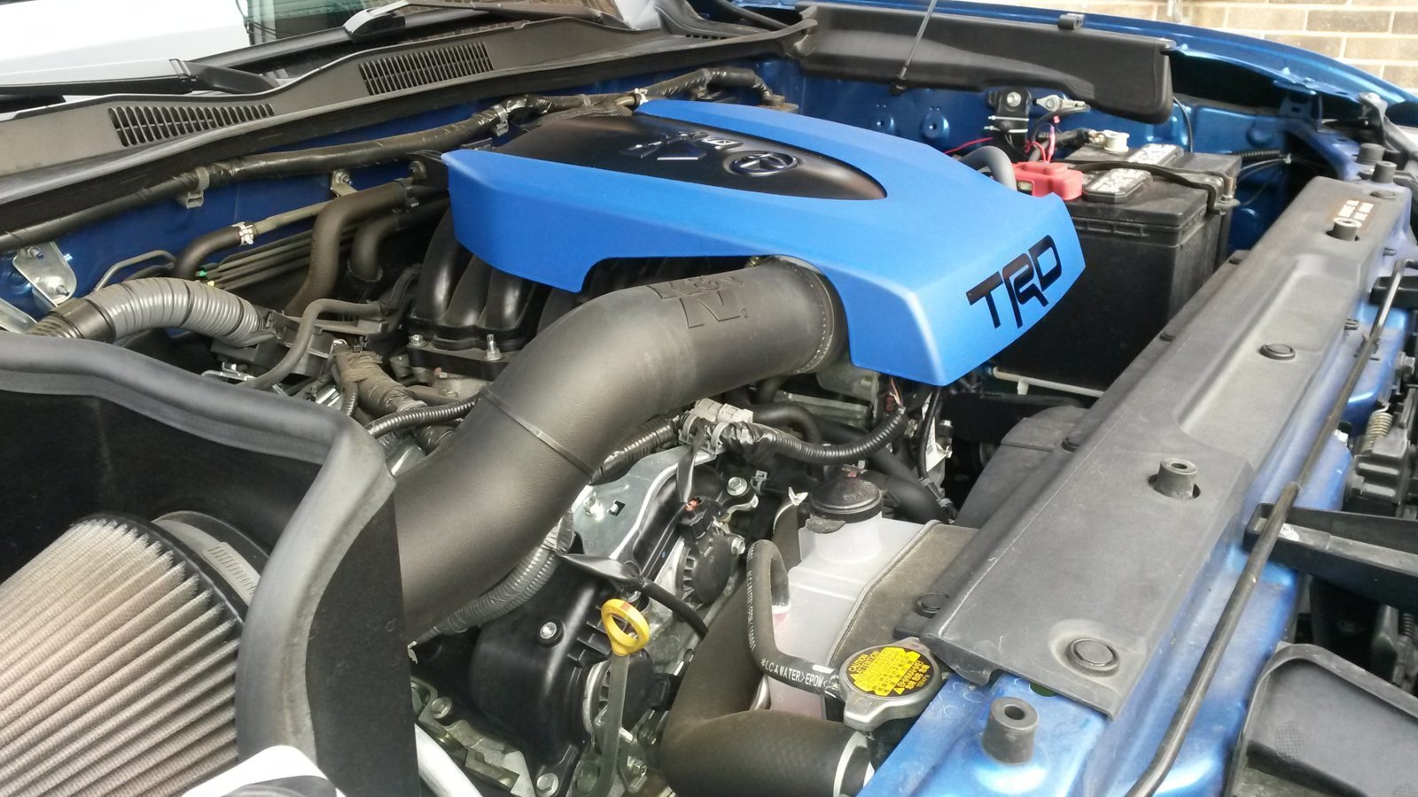

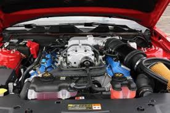

    Had a K&N airbox and filter on my 2016 Sport V6 for over 5 years. Never had any issues with my MAF on that truck. I just hated the noise it produced. Had a K&N intake on several cars over many years, including Z28 Camaros, trucks, other cars and my kids 2011 Shelby Mustang, and I never had any issues with any sensors of any kind. I think some people use too much oil which could be the source of their problems.engine - Copy.jpg 20180116_160924.jpg

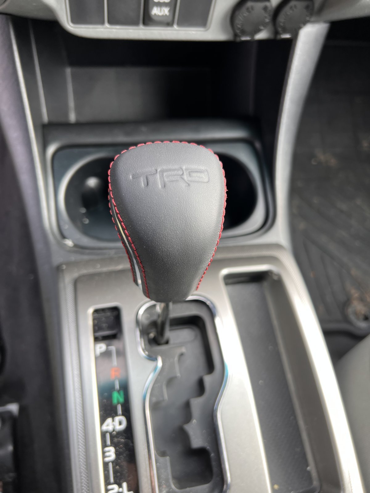

    This was a pretty large amount of work, but it’s different. May not see another like it.
    TRD knob off of eBay. Said it was for a Camry or Avalon. Couldn’t see the bottom, where it attaches in the photos. Took a chance on it. Anyhow, it is similar to the 3rd gen Tacoma knobs where it snaps onto the shifter and then the boot snaps on the bottom.
    I filled it with epoxy, built epoxy up over the bottom. Drilled and threaded inside with 8-1.25 tap, sanded bottom area round and smooth.
    threads right onto the shift lever and looks pretty dang good IMO.

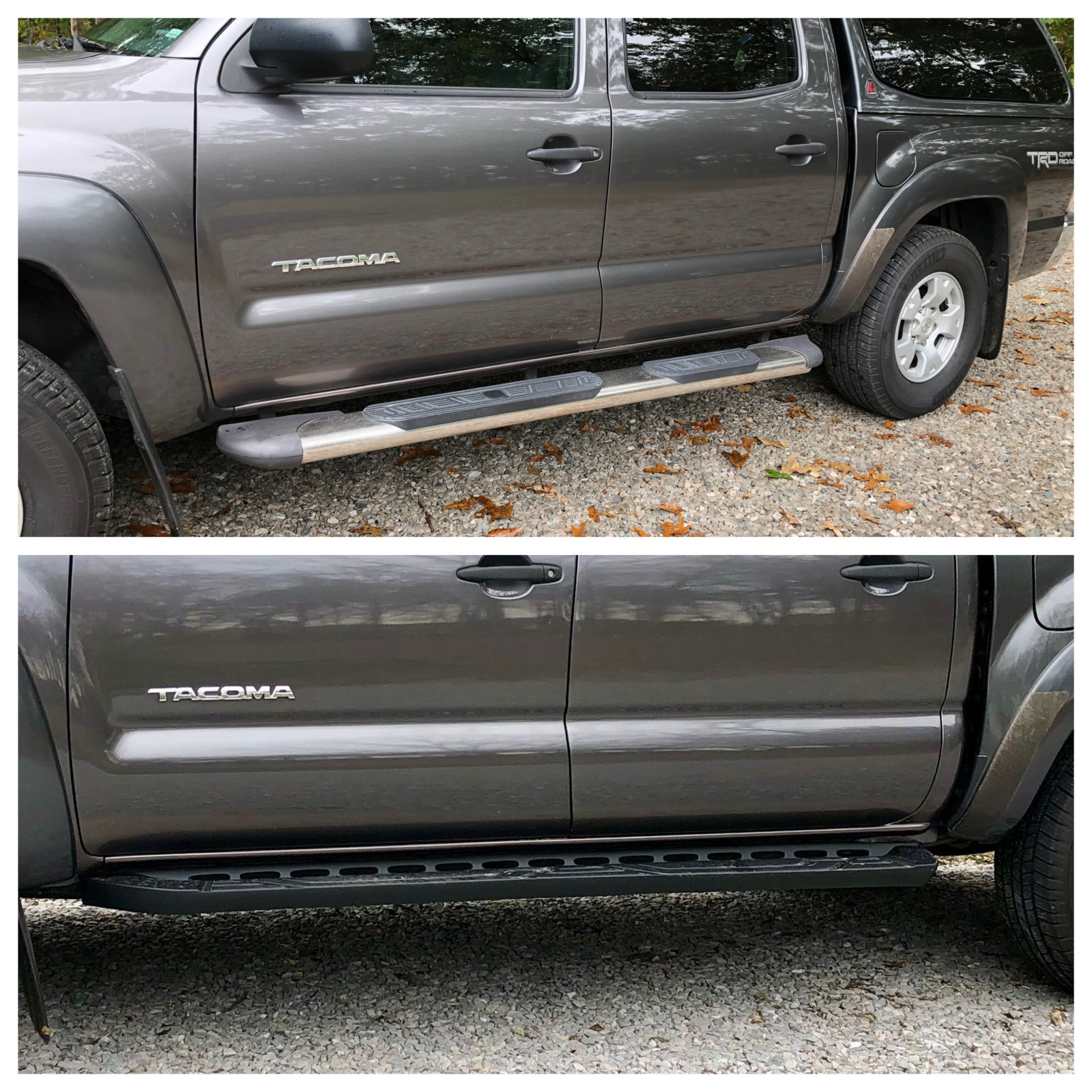

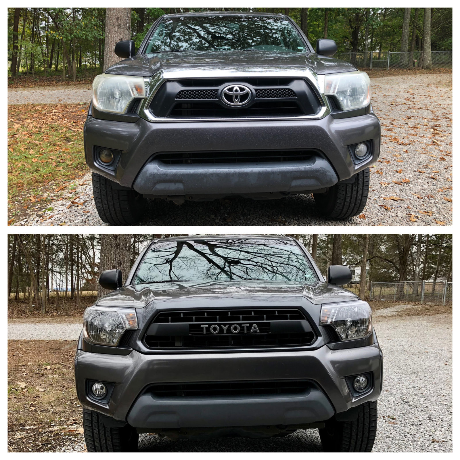

    Long time lurker, first time poster. New grille, headlights, and running boards.IMG_1442.jpg IMG_1443.jpg

    which running boards are those?

    I’d like a set like the black ones. Is there a part number on them or are they stock steps?

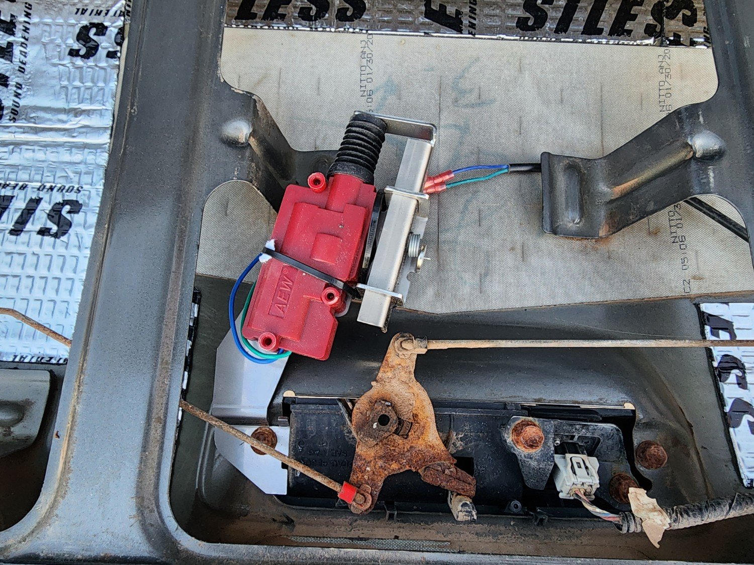

    Put in a safety cord just in case something fails you will be able to get the tailgate open manually.
    Edit: Pop N Lock PL8521 Install With Emergency Release

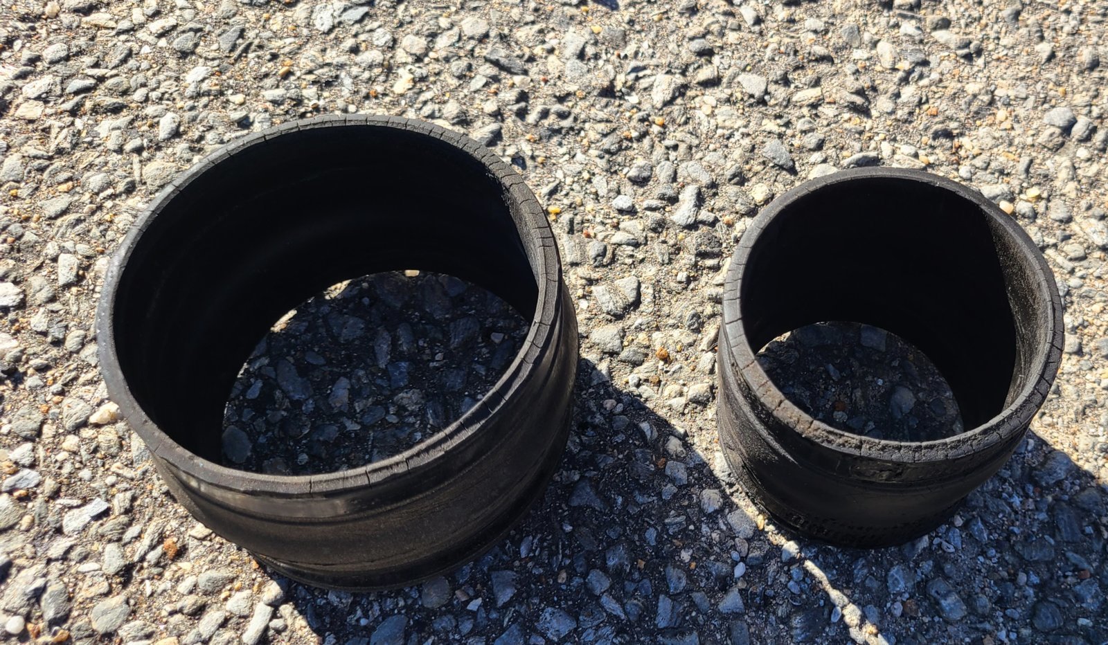

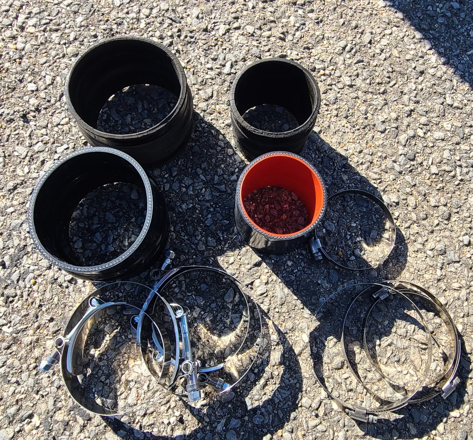

    After 7 years with the AFE Magnum intake, the silicone couplers were rotting. They're single ply, so it's not surprising. I replaced them today with 3 ply and t-bolt clamps. The worm clamps were digging into the silicone. If anyone is looking for replacements, the dimensions are 4" ID x 3" hump and 3" ID x 3" straight length. I bought mine on ebay. They were cheaper than Amazon with tbolt clamps included.

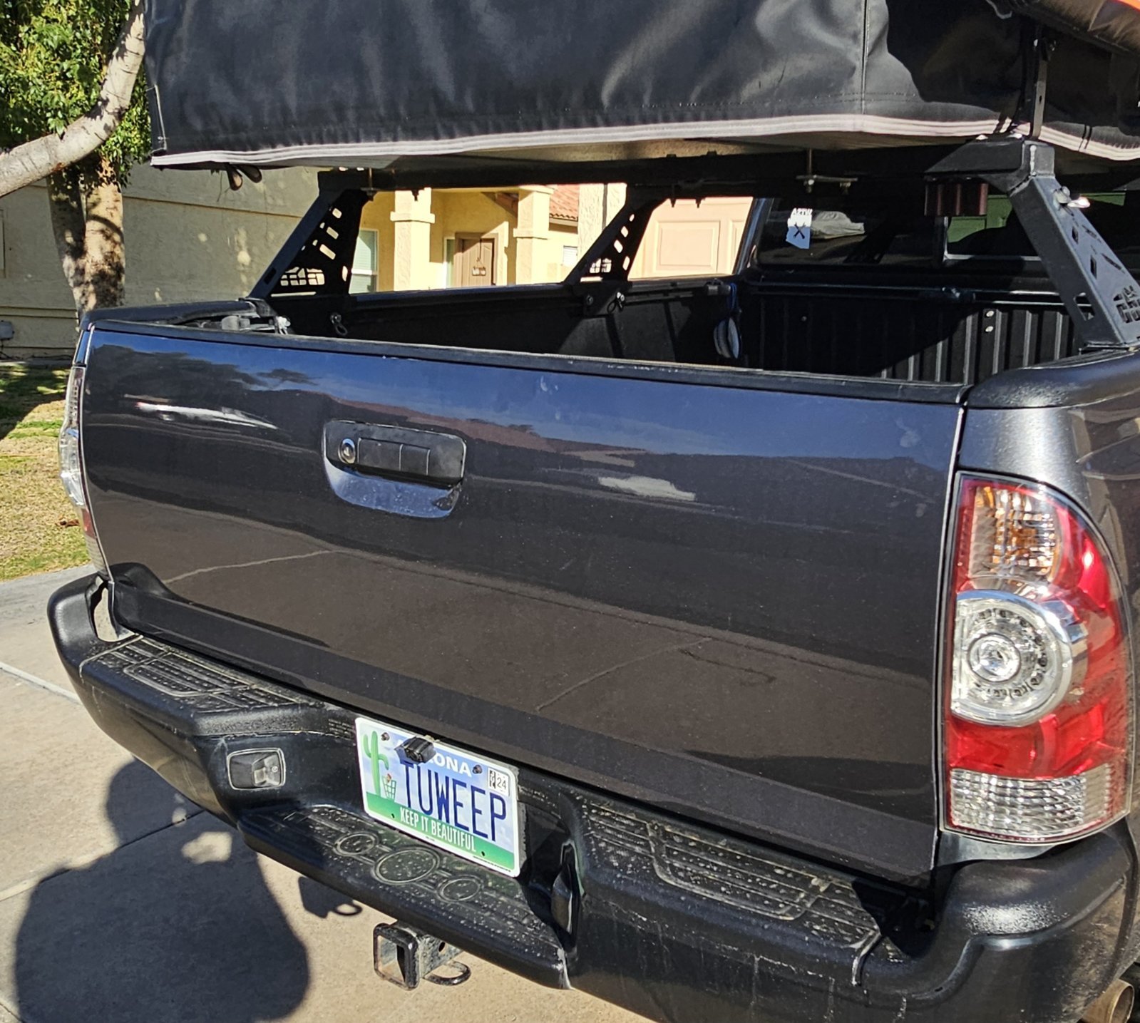

    Installed a Pop Lock. Now I'll only worry a little about my Yeti coolers.

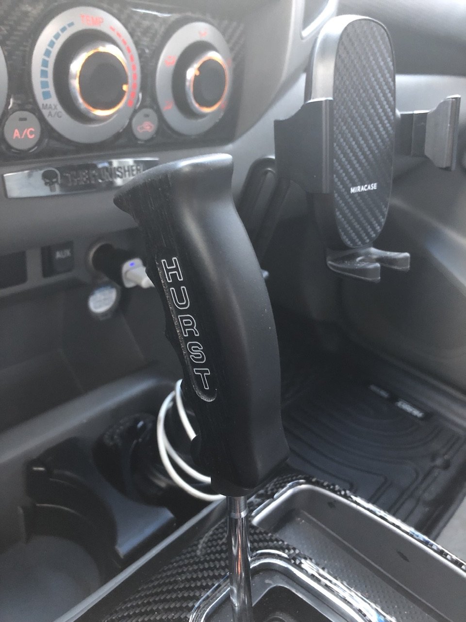

    @Oregonhillbilly
    I like that….
    Went a different route when the leather on my shift knob was degrading. Had to find the correct thread adapter 8mm-12mm, but I’m happy with how it looks.

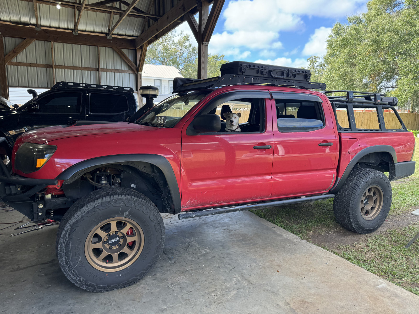

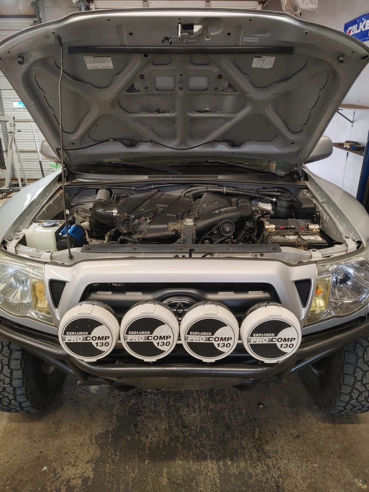

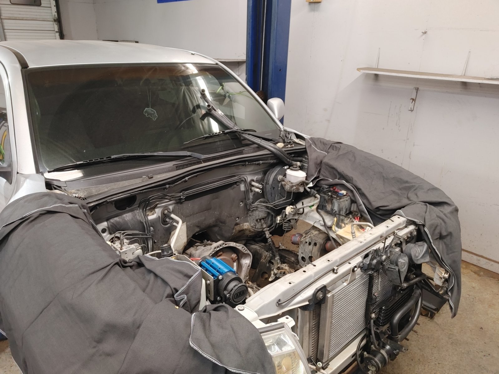

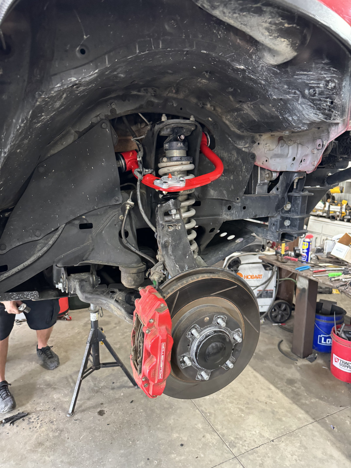

    Replaced 227k engine with one with only 130k on it. Oh and a supercharger.

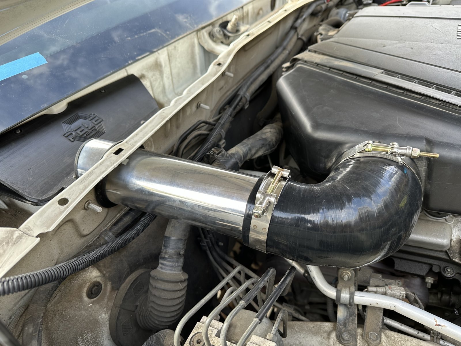

    Got around to installing my cowl intake before all the rain hits. Really nice kit from @dpele
