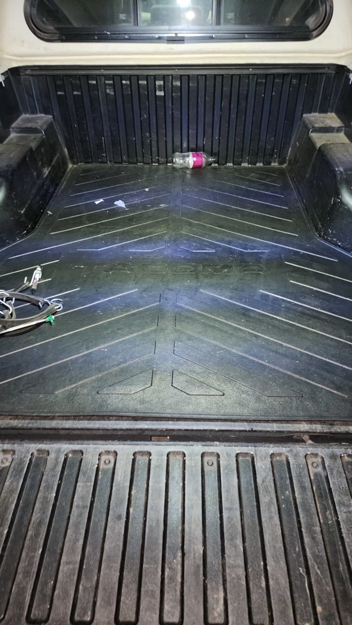

    Scored an almost brand new bed mat for $80
    guy purchased it 4months ago. but his truck got totaled, so he had this taking up space in his garage. So far worth the money. No more random stuff sliding around the bed!

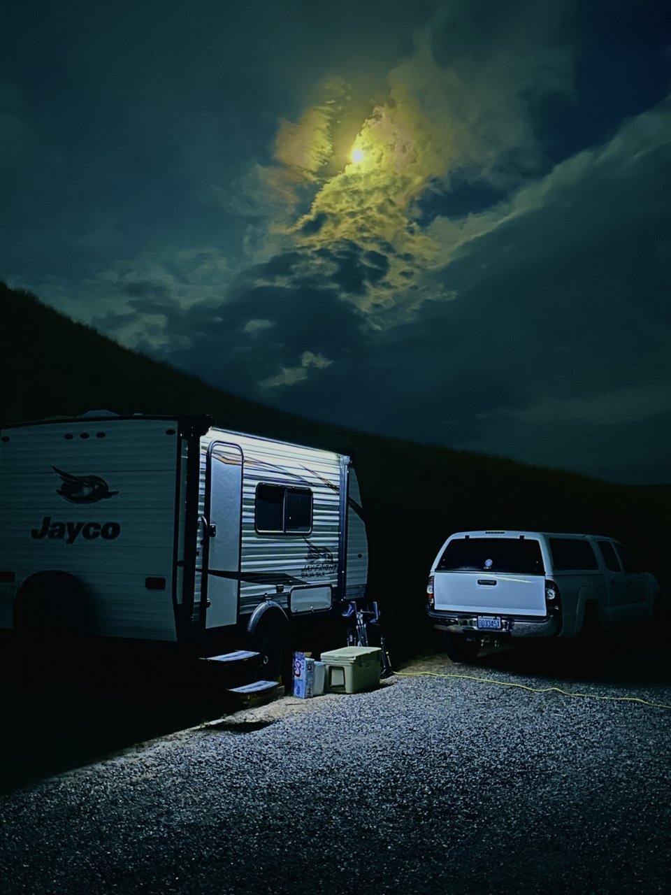

    Nice, I'm headed out to Utah in a couple weeks and plan to get some cool night shots in a very dark sky area if the weather cooperates.
    How does the Tacoma do pulling that trailer, I've pulled smaller ones but I've always been curious how well then Tacoma would pull a smaller travel trailer like yours.

    It pulls it really good. I go over the highway 20 pass a lot and it keeps up with traffic up hill. It’s just a big parachute back there with it being the Baja edition so head wind kinda sucks. I’ve pulled it all over Washington state.

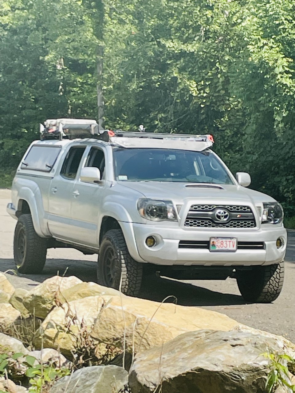

    My 2011

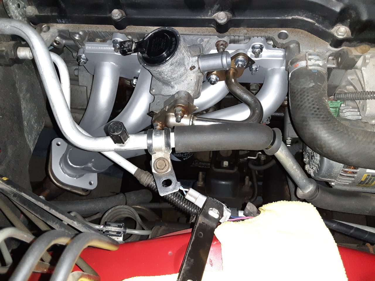

    My Exhausting Labor Day Project: 20230904_185530[1].jpgReplaced the OEM exhaust header with 20230905_142122[1].jpgthe LC Engineering Performance Street Exhaust Header kit for 2TR-FE engines. After soaking with penetrating oil (P'Blaster Penetrating Catalyst) numerous times Labor Day afternoon, and the next morning from 8:30, slowly worked all eight nuts loose, removed the old header, replaced 3 of 8 studs with LCE's upgrade stud kit, and used all 8 new locking nuts, PITA to remove the old studs), got the new ceramic coated header installed and everything buttoned up in time to drive to work at 5:30 (after a quick sandwich for lunch/dinner). The equal length primaries with larger tubes sound great as every cylinder now has equal time and space to exhaust, with a steadier note.
    Manufacturer videos look easier when they're using an air ratchet, lift, and newer vehicle... :dancingbacon::cheers:

    Oh man, I hate to break it to you, but what you showed us there are NOT equally long primary tubes. What you installed looks (shiny new ceramic coating aside) almost exactly like your old ones (which also still looked to be in great shape), so this was likely an exercise in futility.

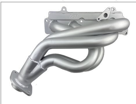

    These are the equal length version:
    https://www.lceperformance.com/Prod...MIx8yd9IyXgQMVIDetBh1IgANgEAQYAiABEgIt_PD_BwE
    I can attest first hand that those did make a small but noticeable improvement on my cousin’s old 2.7L 4x4 stick shift. He could cruise up hills in 5th that used to require going down a gear before.
