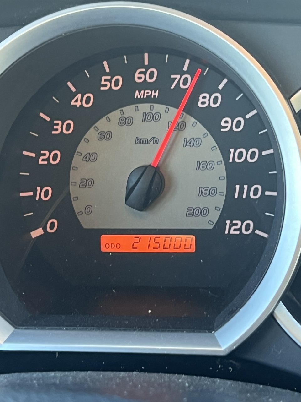

    215000!! we up, and still running strong

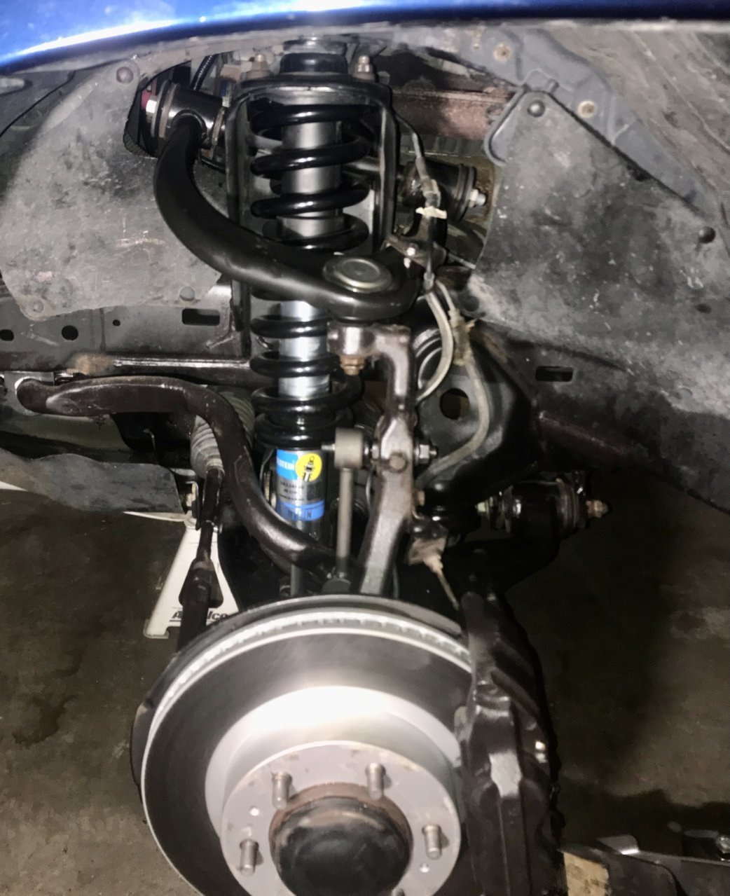

    55C1AC59-444A-4AE3-AF72-7399CE0D2284.jpg So today I finally buttoned up the front end with upper control arms that were taken off a 14 trd off road with low miles, and finished with ospho treatment and bbq grill paint on the little rust spots here and there. It’s pretty much stock except for the rotors pads and shocks/springs, and I put new end links on the sway bar I derusted and painted. I think it will last another 226k :bananadance:
    Ps: that’s never seize on the hub, not rust

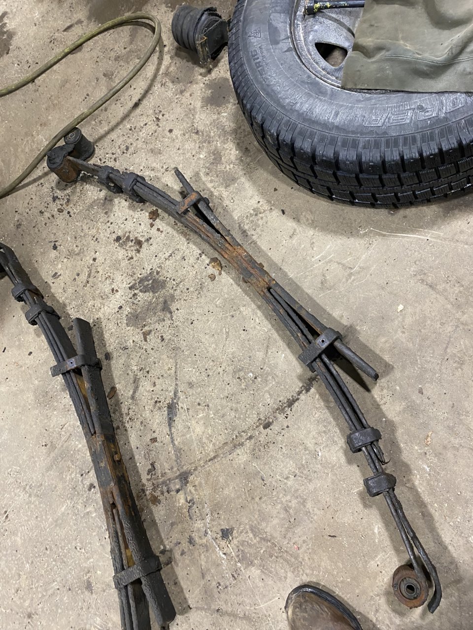

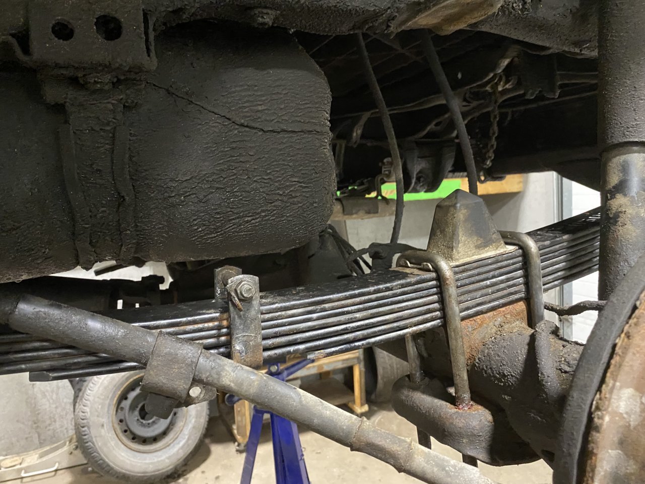

    leaf spring change out
    My OEM springs where broken in several places.
    installed a set of Icon RXT's
    my one bit of advice is..... have two people. I did it by myself. Its a young man's/woman's game

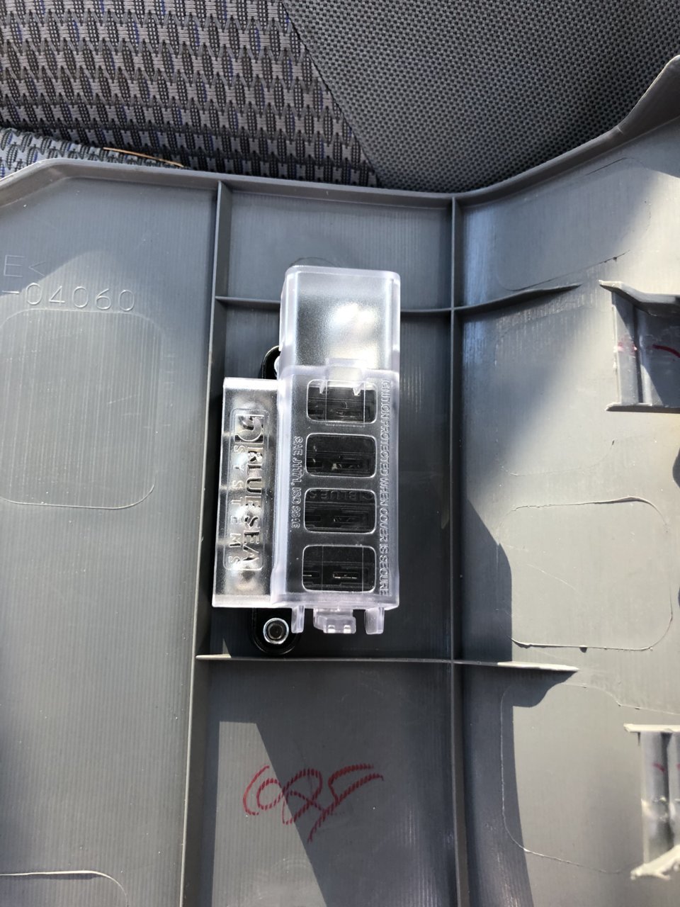

    Mounted an aux fuse panel onto the back side of the kick panel.

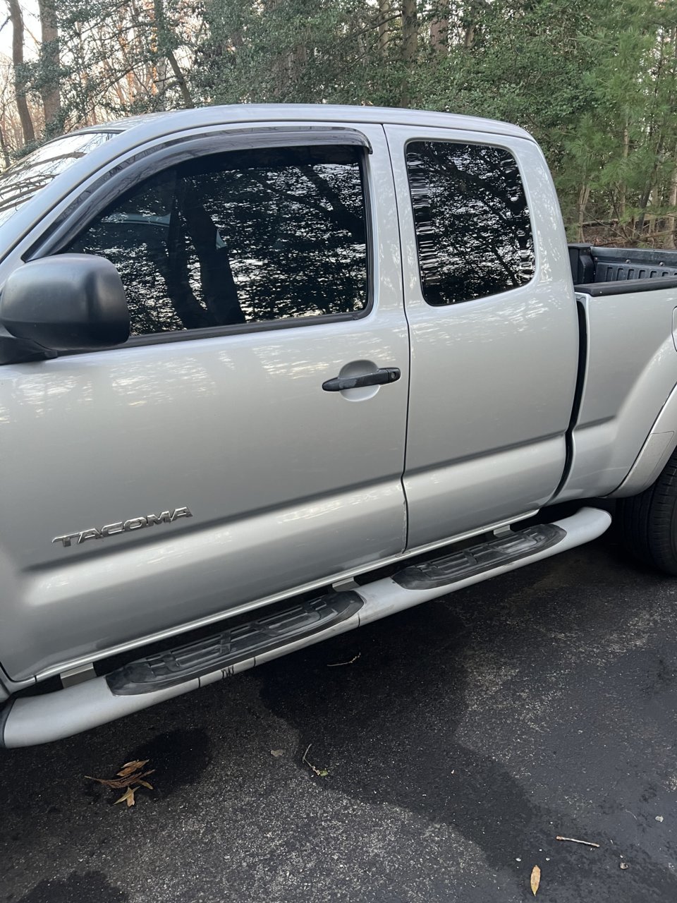

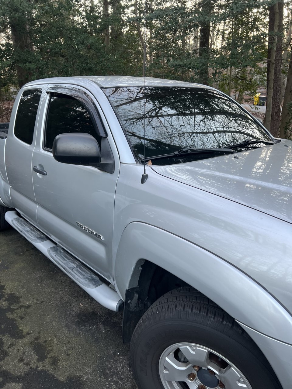

    About a year ago I purchased my Uncle's 2005 Tacoma w/ 85k miles. Since then I haven't done much but basic maintenance and trying to figure out if there were any major issues.
    Today I am beginning the process of adding some upgrades. Got the windshield and front windows tinted and ordered 1/4" leveling spacer for the 2021 TRDOR suspension I am going to install w/ TRDOR wheels.
    I am looking for some rock sliders, a camper shell, and a few other misc. upgrades to get the build started.

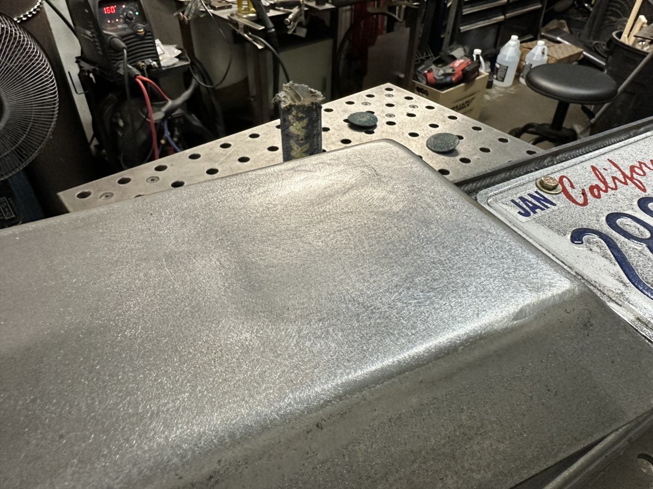

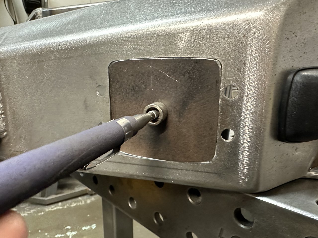

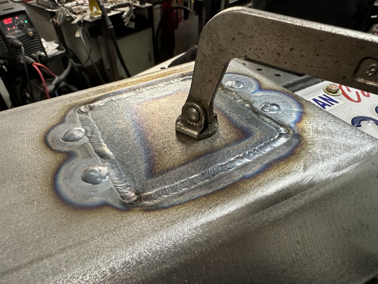

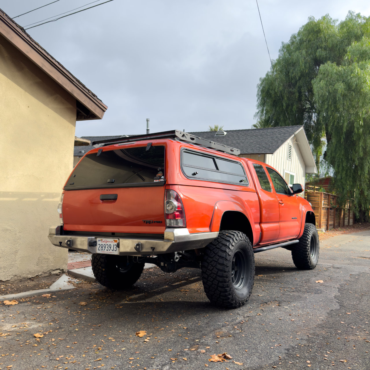

    Final test fit of the @At The Helm bumper before powdercoat.
    End caps were welded on after bumper being trimmed back to match the fender cut
    Decided to not have lights, fill plate made and worked in.

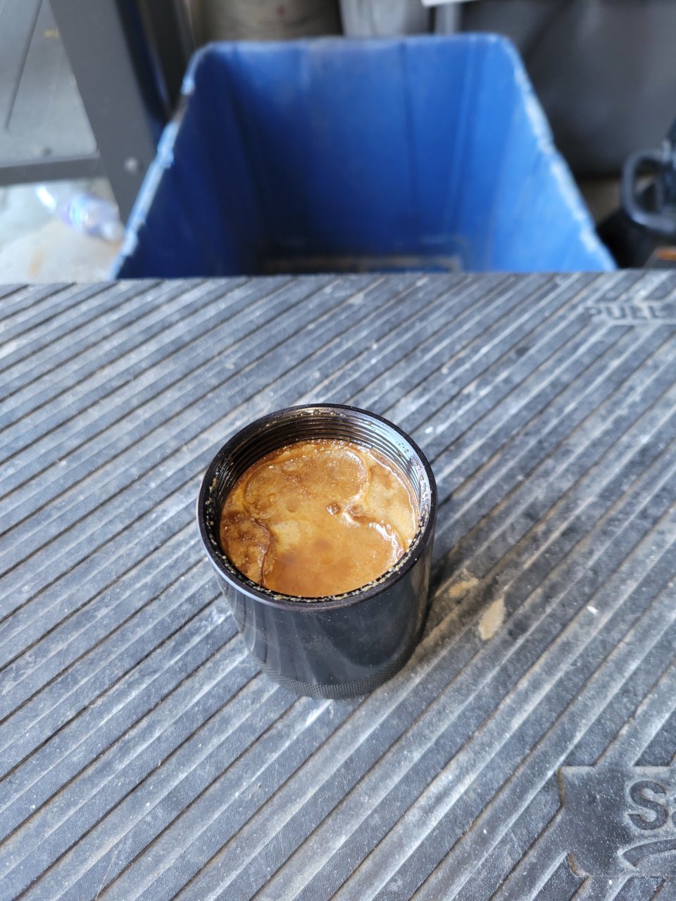

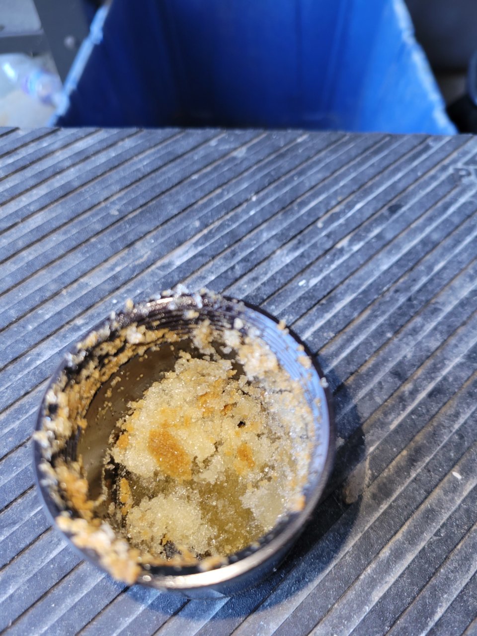

    I have to empty mine every month in the winter otherwise it will dump back into intake from being full.
    It makes sense, as the engine heats up and runs, warm air from the crankcase gets pushed to catch can through PCV valve, since the catch can is separate and has no heat source, any vapor condenses into liquid from the temp differential.

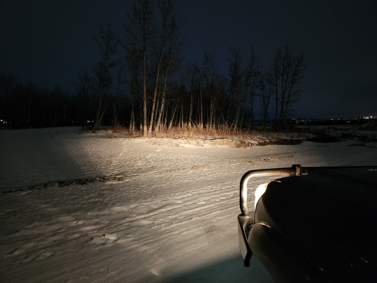

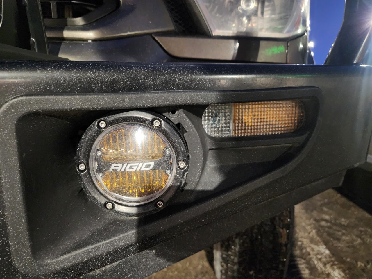

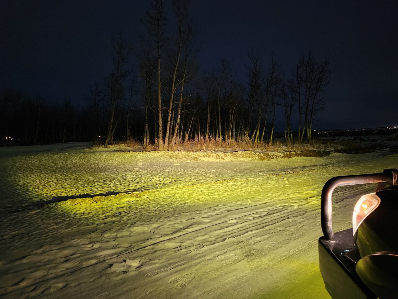

    Alright I need your opinion on some lighting. I got my rigid 360 fogs installed ARB bumper and I gotta say they look pretty clean!
    Keeping with the clean look I was thinking about taking out the turnsignal/DRL out of my bumper and replacing it with Diode Dynamics SSC1 and SSC2 lights. I do a lot of highway driving at night and there is a stretch of road that is notorious for being CRAZY foggy. My thought prosses was I'd get both in amber with an S SC1 spot towards the center of the bumper with SSC2 flood lights on the outside next to the C1s. That way I can see further down the road as well as have a wider spread for the ditches. They should fit in nicely next to one another if I'm correct.
    So, my question is. With the fog lights already in place is this pointless? Additionally I have a buddy that might sell his 4runner and he offered me a set of Rigid 360 6" spot lights that are incredibly bright. Should I even bother with the Diode spot lights then?
    Either way heres a picture of the output right now. Good spread from the fog lights, headlights are getting pretty old so could probably use new bulbs. But what are your thoughts?
