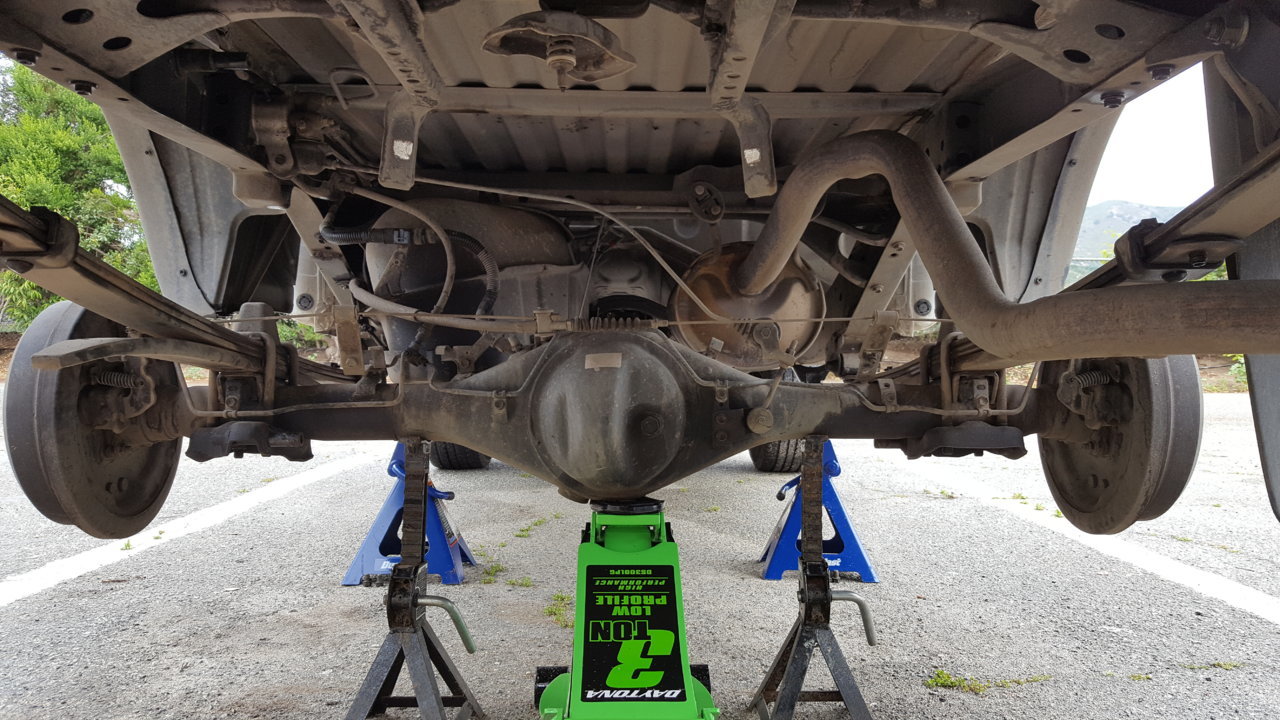

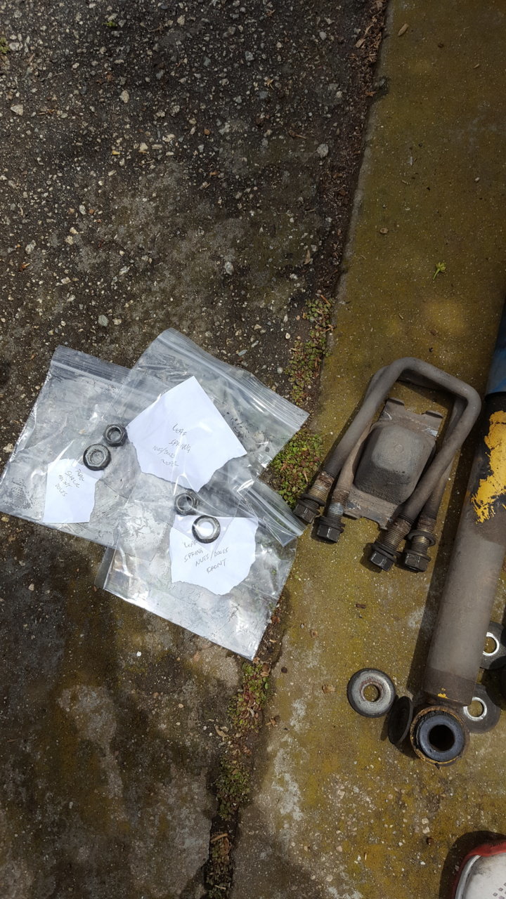

    1. Jack up truck, remove wheels, and remove rear shocks. You'll have 2 bushings, 1 bolt, and 2 washers per eyelet.
    2. Support your axle with a set of jack stands, and your frame with another set of jack stands. Loosen the u bolts but don't remove them completely.

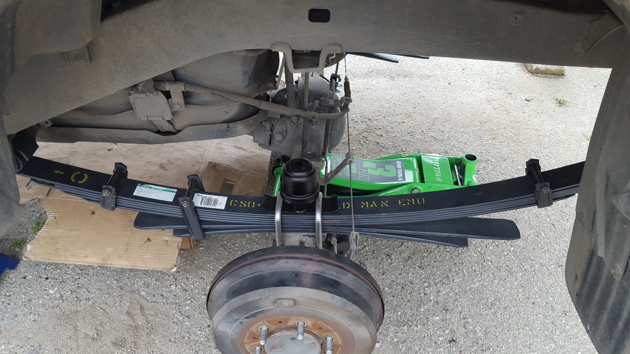

    3. Loosen the 19mm bolt that holds the front of your leaf as well as the rear shackles. I chose to remove the front first, followed by the rear.
    4. You've removed the bolts holding the leaf springs, now the fun part is manipulating the axle and pulling the leaf spring out. No real trick to it, just use arm strength and a lot of manipulation of the axle. Just be careful of your rear brake line; you don't want to drop the axle too low from the vehicle or you'll snap your line.
    5. Install new leafs, making sure to orient them in the same directions as your old ones. There is a center pin that aligns to the axle, make sure you get it centered on the pin. From there you can start putting the u bolts back on, loosely.
    6. Bolting in the leaf springs can be a bit tricky. I went ahead and put on the shackles and did the rear of the leaf first. You'll notice the front won't line up though to push the bolt back in. This is where this comes in handy.

    Much easier to just cut u-bolts
    I have never been able to get the bolt out of the spring hanger having tried everything the bushings are only coming out by using the torch Save the steel shells you might need to reuse them

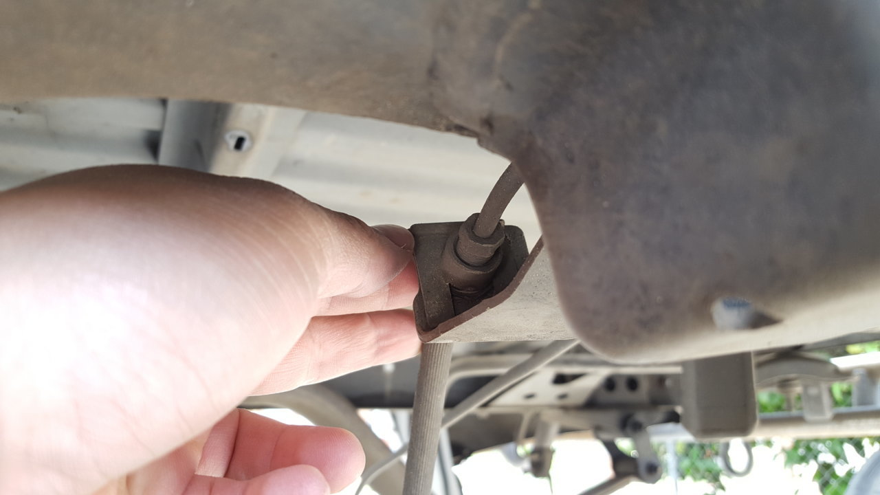

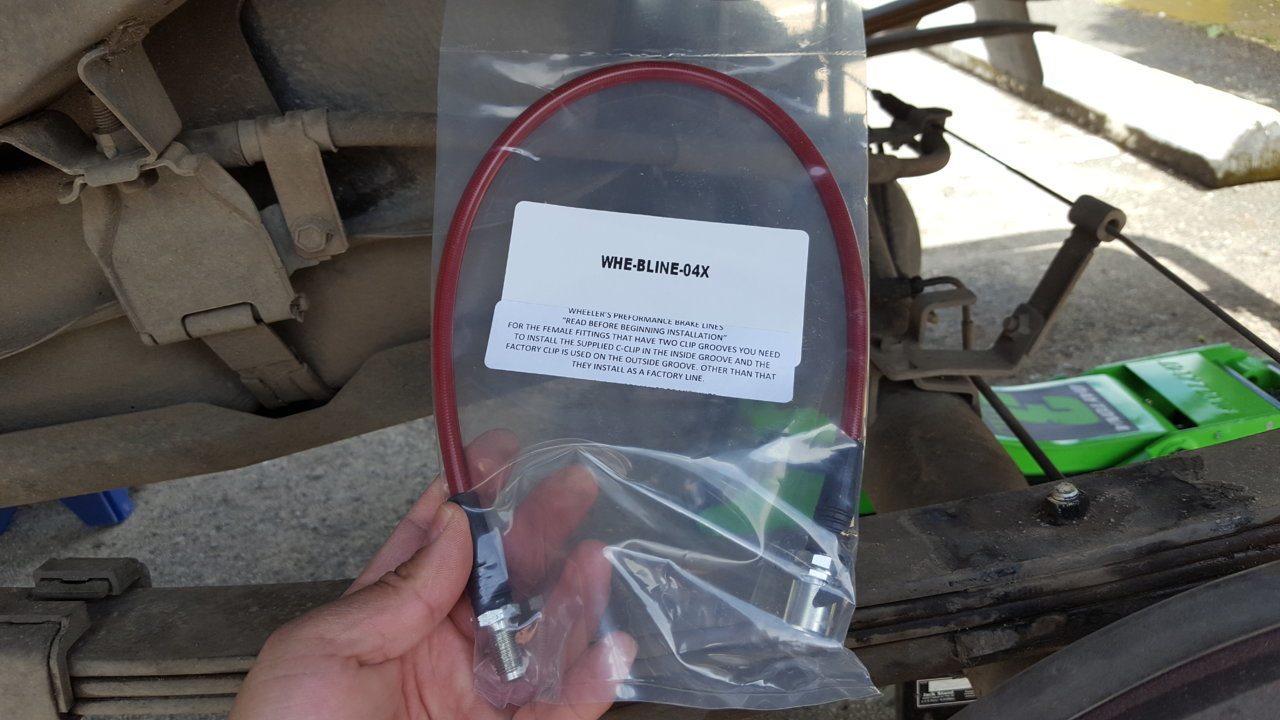

    I do have an extended brake line, but have yet to replace it. Need to go out and buy a flare wrench; I'm good in the meantime since I'm not out wheeling.

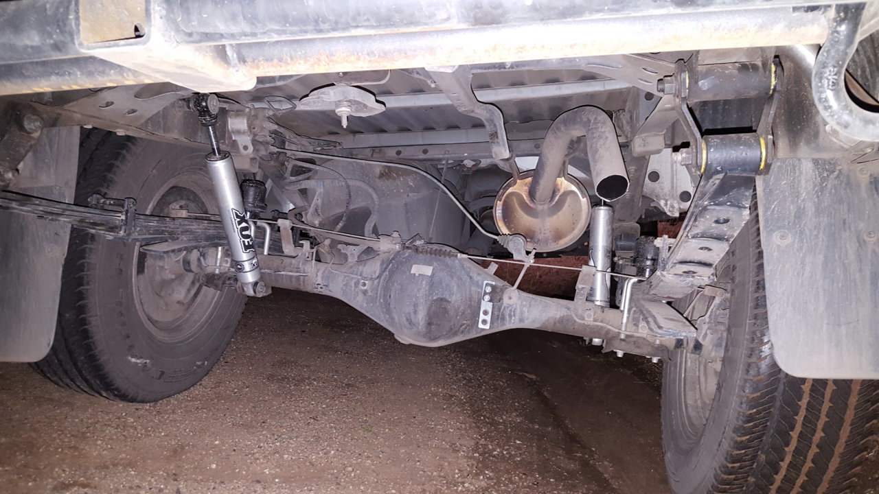

    If you're going to replace your leaf springs with OME Dakar's, you should replace your brake line with an extended one. The added droop/flex you'll get will allow you to extend your brake line long enough to potentially damage it.
    As you can see, I did a little flexing near where I live just to see when I'd reach my bump stop. Had I flexed the rear the other way, my brake line would've been at my mercy.
    Speaking of bump stops, make sure you get a longer set of stops to prevent your shocks from bottoming out!
