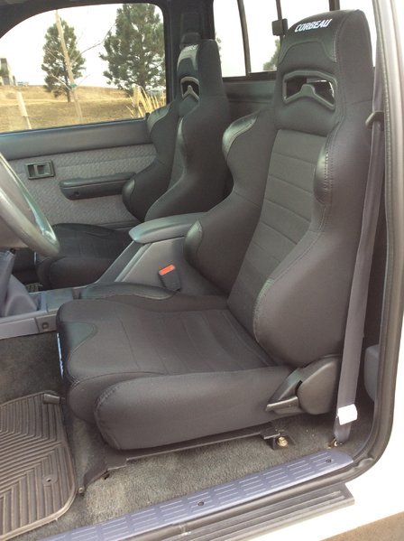

    LG1 corbeau seats or Baha seats for 800.00, slider brackets 200.00, if you have the extra money they are fantastic and install is 60 minutes, EASY
    or just get used 4 runner seats and modify the one front leg,
    But remember with used seats your still dealing with a seat that's 10 years or more old and that means old tired foam and fabric
